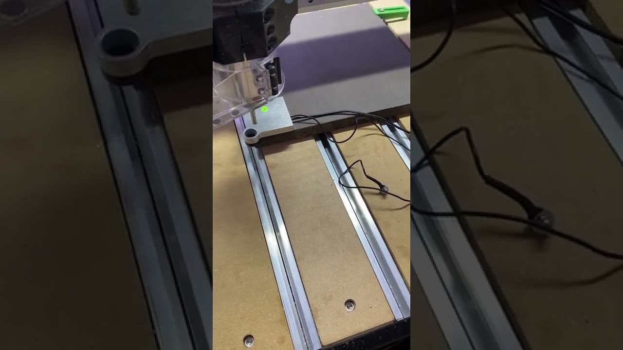

Hi I am setting up cncjs on my fusion5 tablet to use on my shapeoko pro xxl. I tried using the bitzero like normal as per instructions in this tutorial I’m following CNCJS - For beginners with Shapeoko 3 - YouTube but the endmill just kept pushing down into the bitzero and wouldn’t stop. I used bitsetter first to determine length of endmill, what am I doing wrong? Thanks in advance!

You need to set your Z-zero before running the bitsetter macros.
The procedure should start with:
  1. Homing
  2. Set Z-zero (BitZero or manual)
  3. Initial tool macro
I was using Bitzero to find the zero for X, Y, and Z.
So I should just turn on my machine, connect cncjs, home machine, use bitzero to find X+Y+Z, and then use bitsetter to find Z of my initial tool?
But in order for bitzero to work properly, don’t I need to use bitsetter first to identify length of the tool (1/4" probe) I am using for the bitzero sequence?
No. The tool length doesn’t really matter in this use case. All that that matters is where the bottom of the tool is. The bitsetter just establishes an absolute reference for that tool’s bottom.

Hi @neilferreri I’ve attached a youtube video to specify the issue I’m having.

Can you also post the contents of the macro?
macro
That’s just the start of the macro. Can you edit the macro and then from the edit screen copy and paste all the text of the macro?
That’s a macro for the old BitZero.
It probes Z first and didn’t have the little corner hole.
I don’t think I ever did a macro for the v2, but a bunch of us made holey probes back then. I know there’s a macro for that.
I can look later.
(start with the end mill 15mm ABOVE the plate, about 15mm or less from bottom left corner.)

Hi @gabrielcampbell.
I’m not sure if you saw my reply above. That’s a macro for an earlier version of the BitZero.
It will not work with the hole on the V2.
Where can I find the macro for the Bitzero V2?
I don’t have a BitZero to create one from.
You could modify this one:
Or, just set zero by eye.
