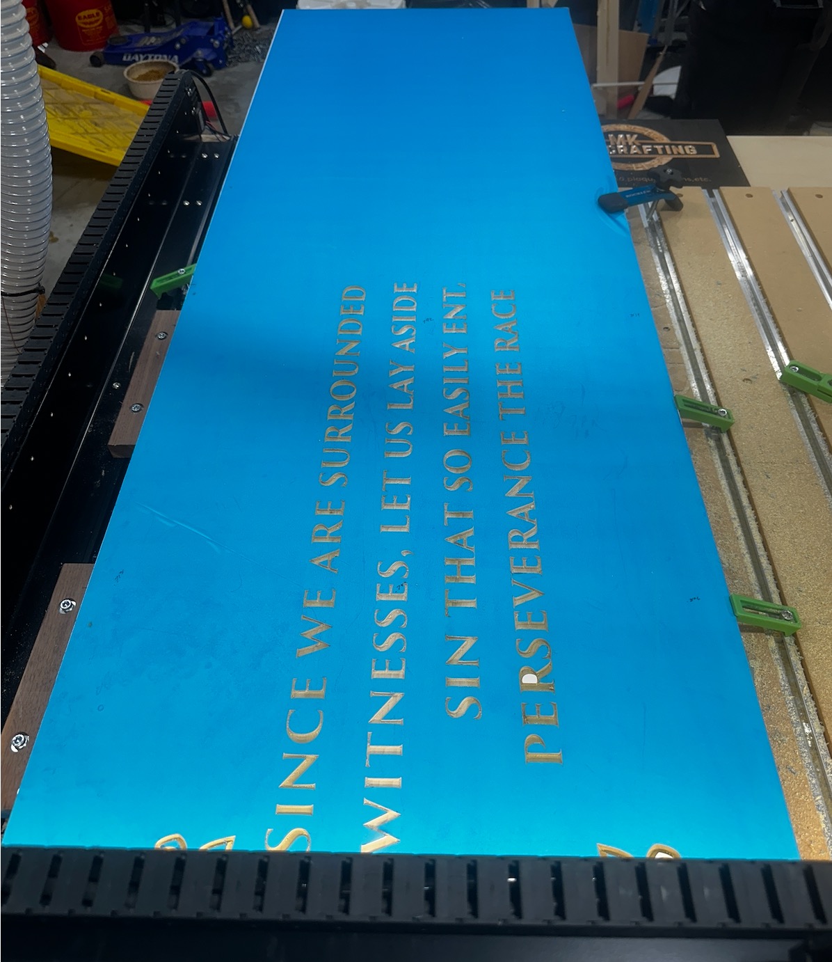

I have had excellent results with Oramask 813 on MDO and white oak. I first painted/stained/finished the MDO/oak in the major, background color and let it dry before any carving. One sign I just did a no offset contour cut with a 90 degree V bit at 0.020 inch depth. Then peel off sections for each color and spray bomb one color at a time with drying and covering painted areas before the next color. A++ and fast. Another sign I vcarved letters with a 90 degree V bit, removed any residual mask around the letters and spray bombed the letters. As mentioned, test. I recall not good results when the vcarved letters were small (<1 inch tall ) and I attempted use of a 60 degree v bit. If you do not need/want to use a v bit, a downcut end mill may give good results. Cheers.

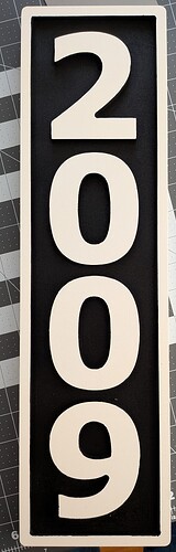

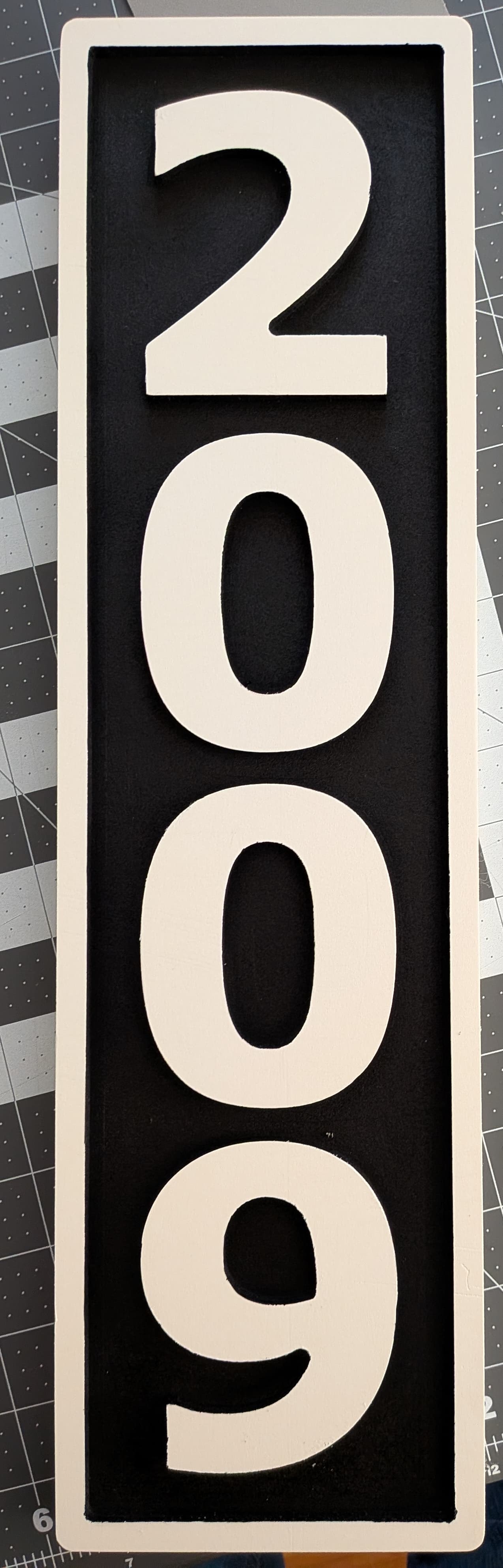

I might have missed the material that you are using. Oramask 813 is my favorite when cutting PVC and the painting the area where material is removed. It works great with an 0 flute. I never thought of using my stingray drag knife because the HOA wanted carved signs…but I guess if you want to just paint a flat board it would work fine. You could also try a Cricut vinyl cutter for that instead of the CNC machine.
I used the stingray to remove score the mask and paint and then carved. I can’t remember the specifics of that project as to why I did it that way. Do you get decent edges on the masking using the O flute on PVC?
Yes. The PVC needs to be wiped down with acetone first.

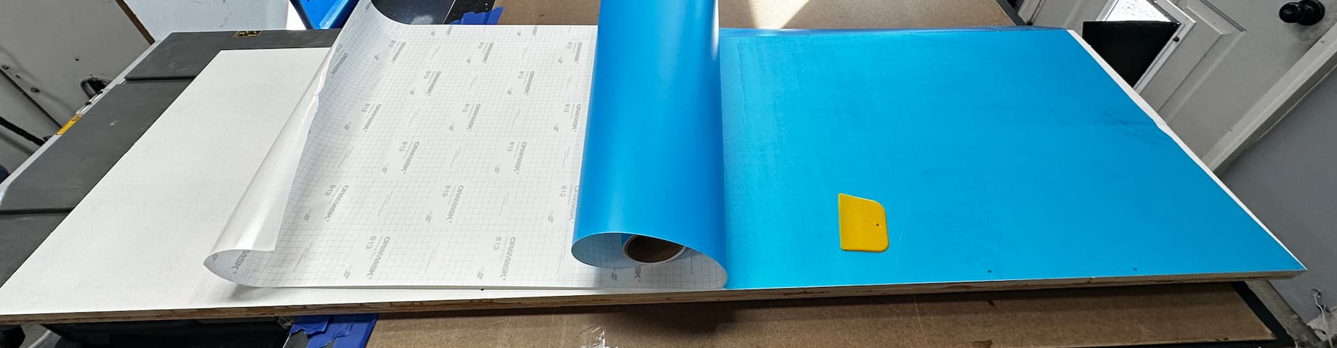

I just did a 6’ long sign using oramask on the whole thing. V carve lettering. Worked great. Use a plastic straight edge (like the kind for installing vinyl graphics) to push down hard to get a good seal. Better the seal, better the results. I had very little bleed through, but it’s not perfect.
I would keep an eye on it while cutting. The first time I used it, somehow it got caught on the spindle shank of the bit and started pulling it all off and caused quite a mess. Learned to do some things different after that.
