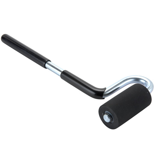

As Todd suggested use a roller to press the oramask down well to the surface. Simply running your hand over the surface is not enough. I use oramask but also use Easy Liner Adhesive Shelf liner. I can buy the Easy Liner at Walmart and I think it works just as well. I still use a rubber roller to adhere the shelf liner to the surface.
WoodRiver - Standard "J" Roller for Veneering Here is an example. It is the same roller I use.
