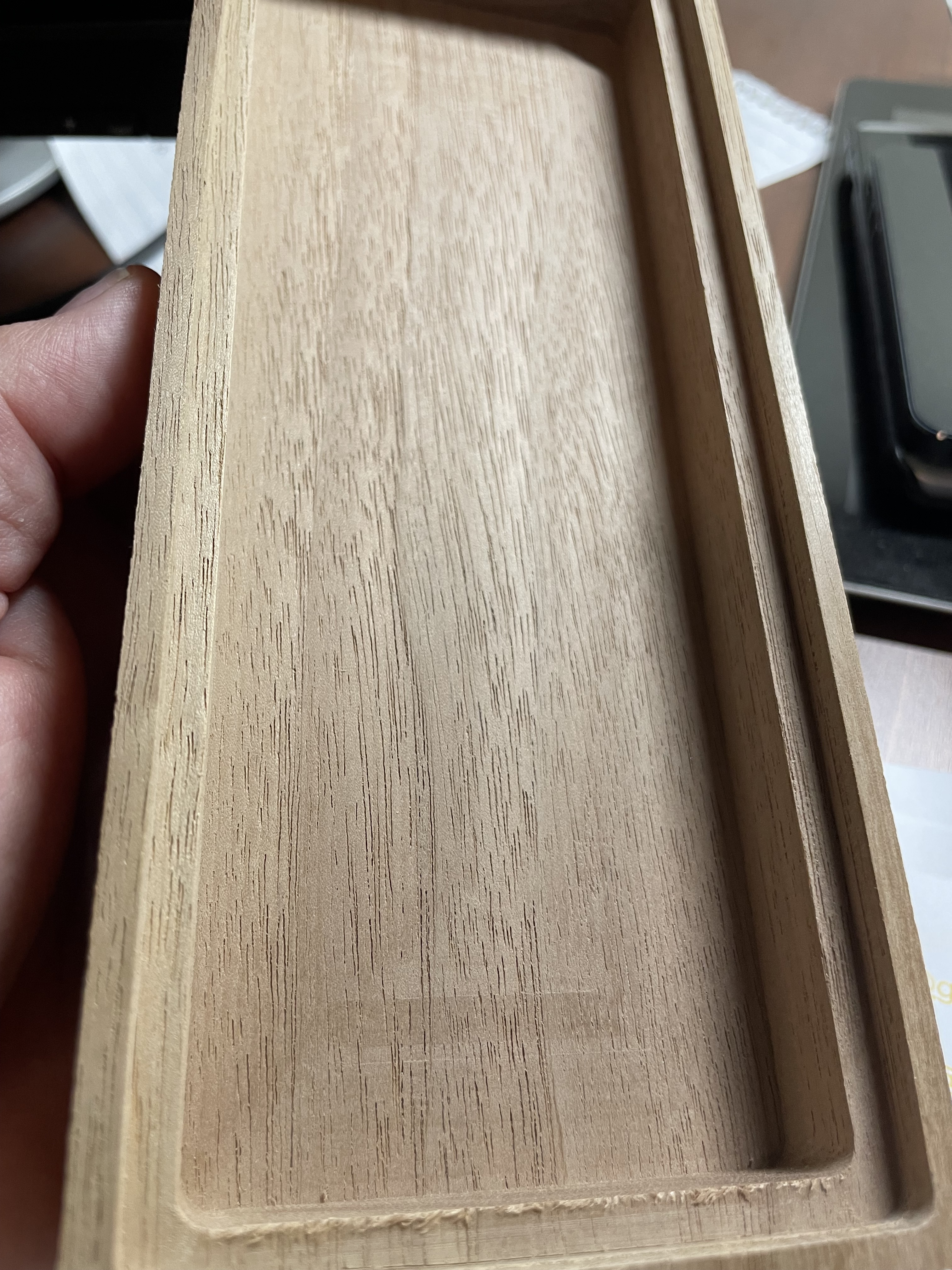

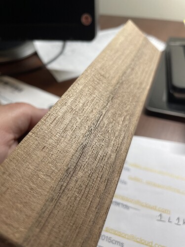

This was the first time I used that bit. I am super impressed with the surface on the insides of the bottom and lid to the box. It is very smooth with barely perceptible machine marks only when it was going across grain.
The sides are a little rougher than I had hoped like I mentioned earlier. I haven’t had time to try sanding yet to see what I get.

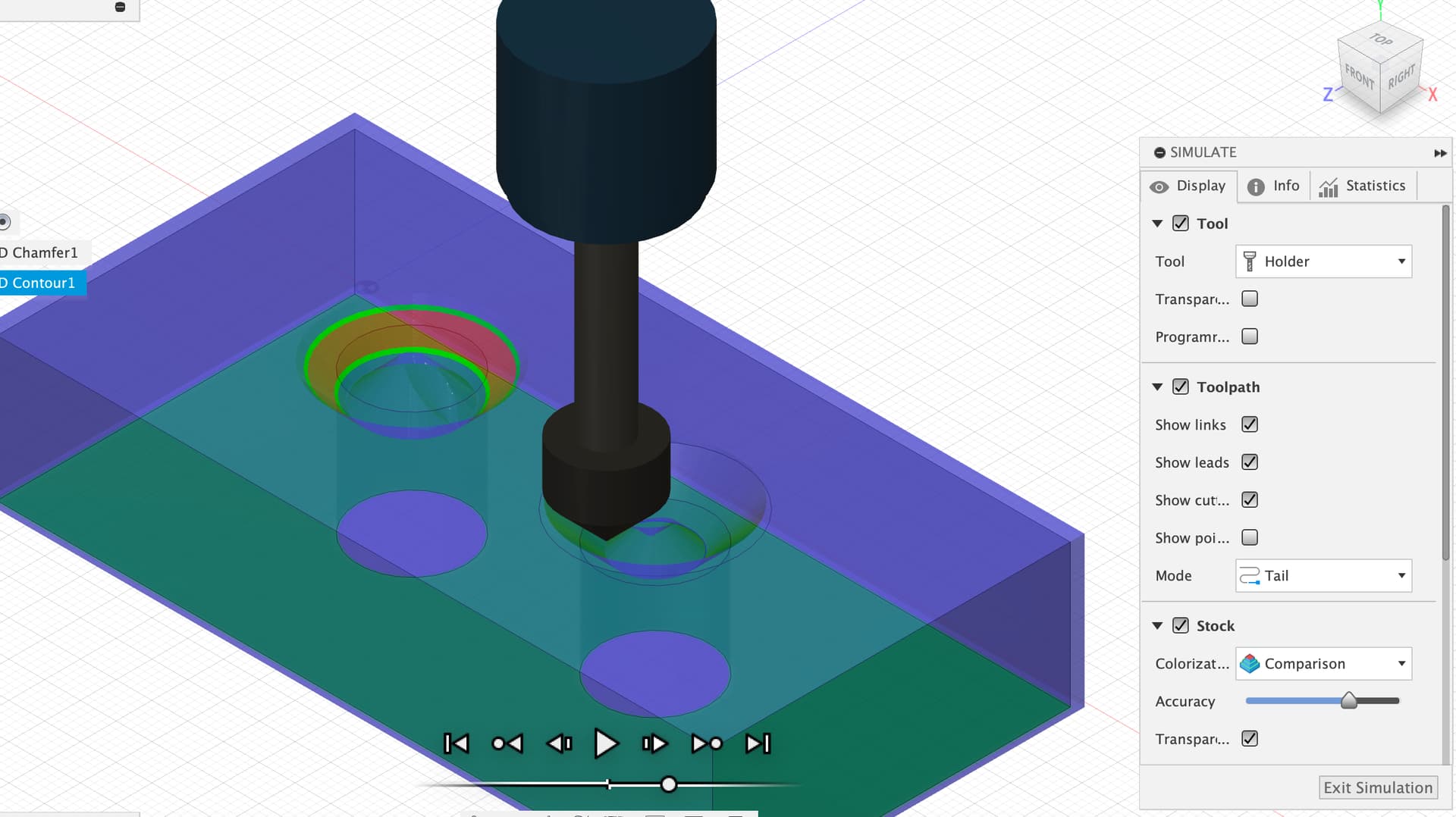

As for the chamfer, it depends how you’re modelling them in Fusion there’s a couple of major options;
  1. Do the chamfer in CAM, do not model it on the object, if you choose this then you use the 2D chamfer toolpath and the tool will plunge in and rip round your chamfer at scary speed, sounds like this may have been your first experience. My first suggestion would be, if you’re doing chamfered holes, to reduce the cutting feedrate as the outside edge of a tight circle has a way higher effective cutting speed. I do not use this option at all, and especially not in metals.

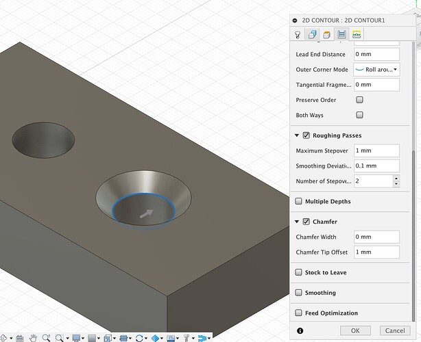

  1. Model the chamfer in the CAD and then use the 2D Contour toolpath in CAM. This gives a load more options about how to machine the chamfer and lets you do it in several passes with repeat finishing passes and all the other civilised options.
The help for the chamfer function is quite sensible, you can either select the top contour and tell the CAM how wide a chamfer to cut (like option 1 and the chamfer toolpath) or you can select the bottom edge of the chamfer and the machine works out the width.
The key tools you get here are the chamfter tip offset which lets you drop the tip of the cutter (which has near zero speed and doesn’t cut well) past the edge of the material and the roughing passes / finishing passes setup. Here I’ve selected 2 stepovers of 1mm each before doing the final finishing pass.
That results in a cut like this
Whichever method, I almost always run a ‘repeat finishing pass’ and set the finishing feedrate down from the roughing feedrate to get a clean finish, it may take longer on the machine but I trade that for the time saved manually sanding and finishing.
