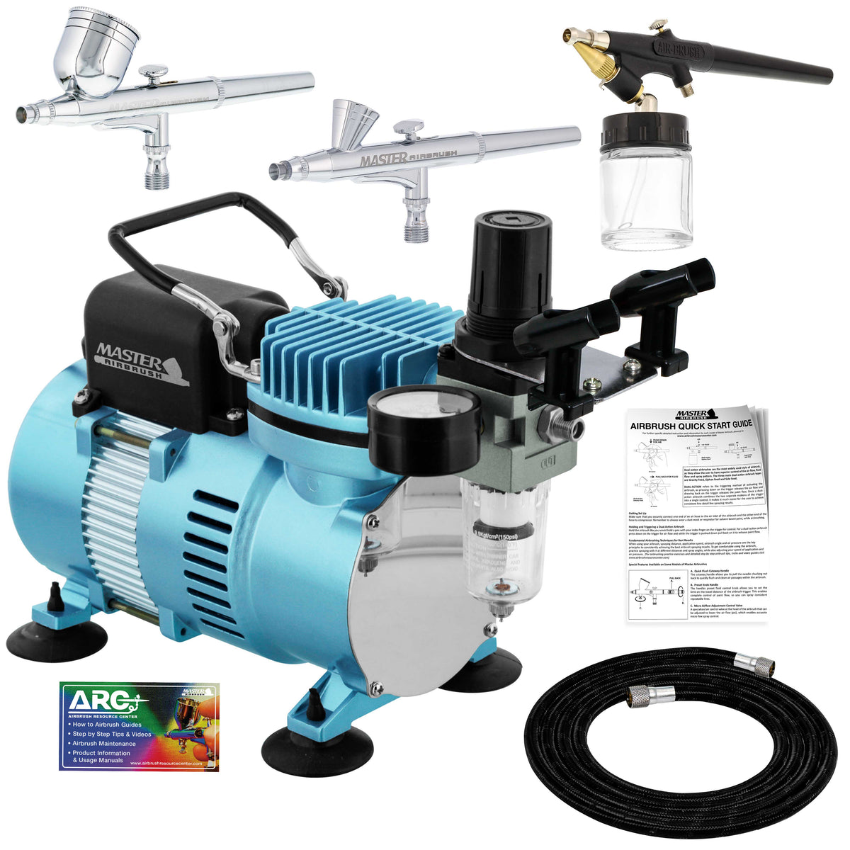

This compressor works great for my air brush and laser air assist. I don’t know about other air assists, though.
LINK: https://www.amazon.com/Master-Airbrush-Runner-Compressor-TC-320/dp/B07ZQL2BHQ
I think that’s a sell. Thank you !
I was concerned about footprint ( not really having a clue ) and this would fit nicely.
47db works for me.

I can not find an amperage rating . Do you know what it is ?
The TCP Global site does not show it.
Thanks
It says 1/5 horse power. So at 120v single phase you’re looking at ~1 amp. Maybe double it for safety margin and the little fans :thinking:
Thank you ! 20 characters …
Looks like this will do the trick with the same compressor.
Might be worth looking into a small pressure tank if the duty cycle ends up being too high. Realistically, one of those whole home water pressure filters would work.
Cheap, pressure rated, comes in basically any size you like, could put a mist coolant in it if you’re cutting metal.
