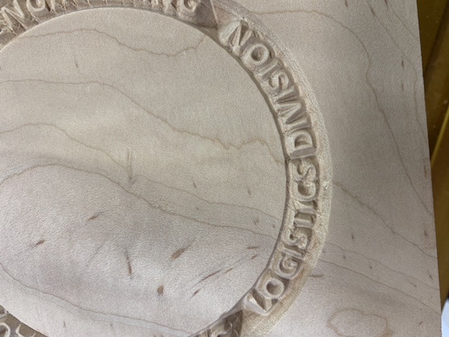

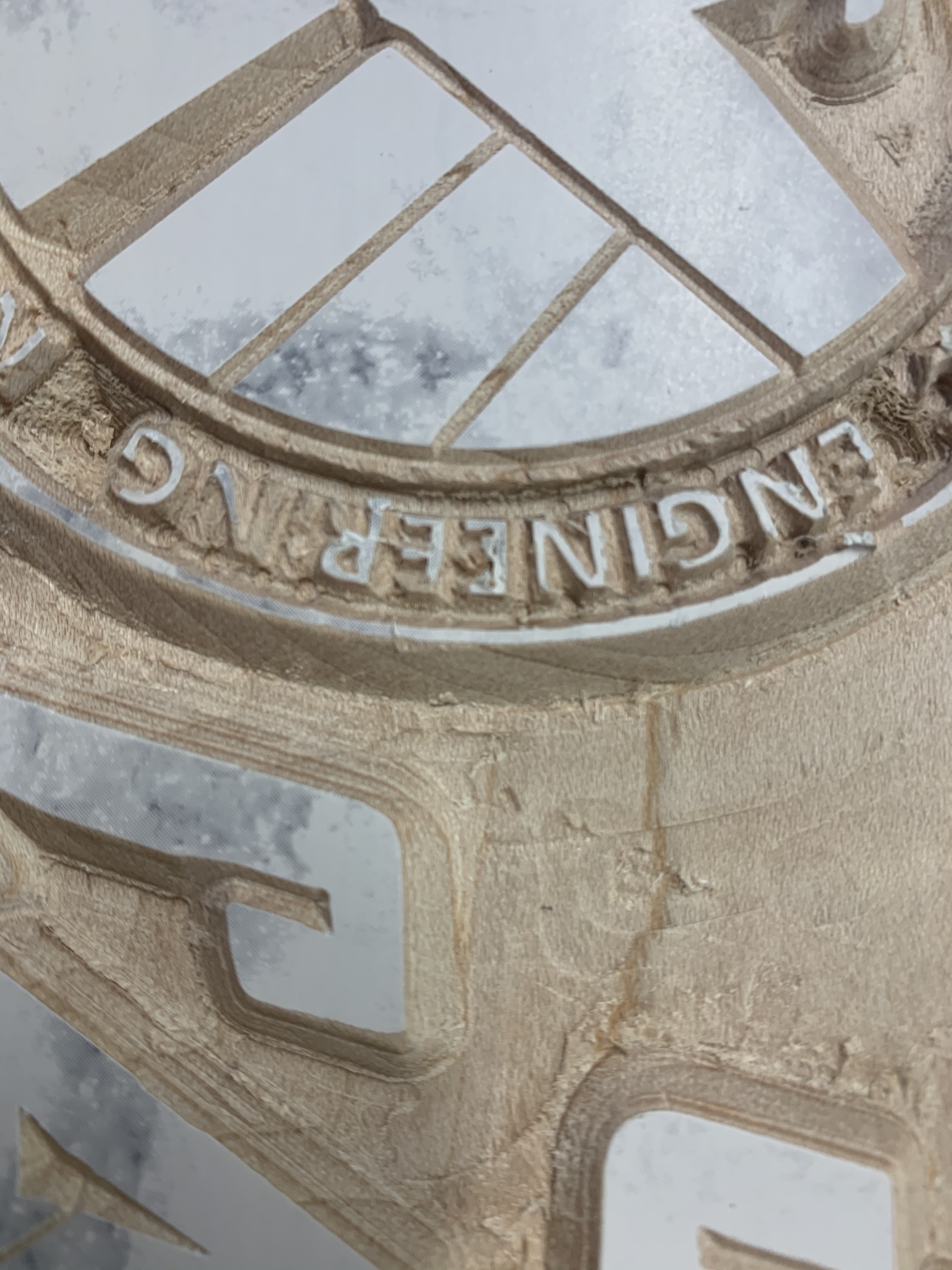

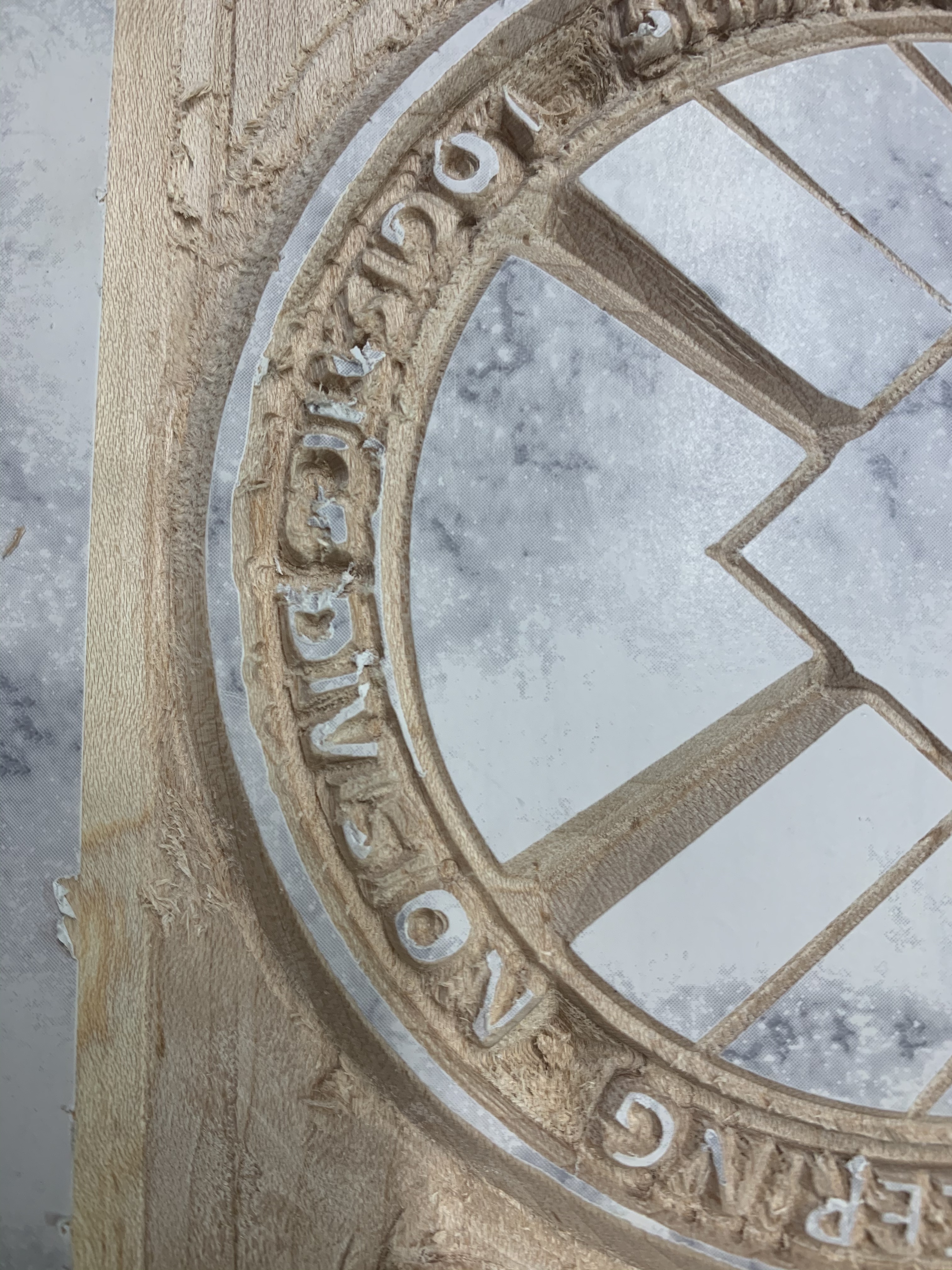

Still learning, but thought I would esteem advice from the group. Having issues with v-carving lettering (in maple, shown) as well as cherry. Letters here are 3/8” and I’m using a 60 deg v-bit. Some letters are ok and others super shredded. I’m going to experiment on a scrap piece with a 90 deg v-bit, but I’m wondering if this is a feeds-and-speeds thing (it’s set to the default for the C3D v-bit) or do I need a different bit or carving technique?
And, yes, I’m having some challenges with clearing bit techniques (probably related to common zero issues) but at least in this case, I was able to clean things up manually with my Foredom tools.

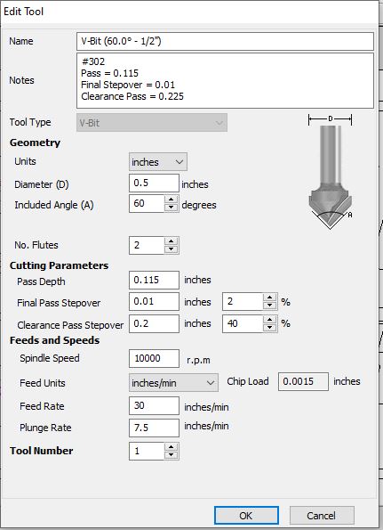

Thanks @Julien Here are the F&S I had set for this cut. I’m using the Carbide 3D bit (#302). I’ll also be checking my mechanical settings.
Those F&S look ok except I would increase speed to 18000 RPM. As a test, you can also reduce depth per pass a bit, see if that helps.
But I agree that checking the machine mechanically is probably the priority, we can see the bit not quite following the curves in the pictures above, which is probably an indication for slop somewhere (you know the drill: check ALL eccentrics , tighten belts)

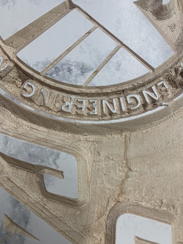

Thanks again everyone for all of your help! Definitely needed eccentrics tightened and belts (including Z) definitely needed to be tighter. Did a test cut with much better results! image
