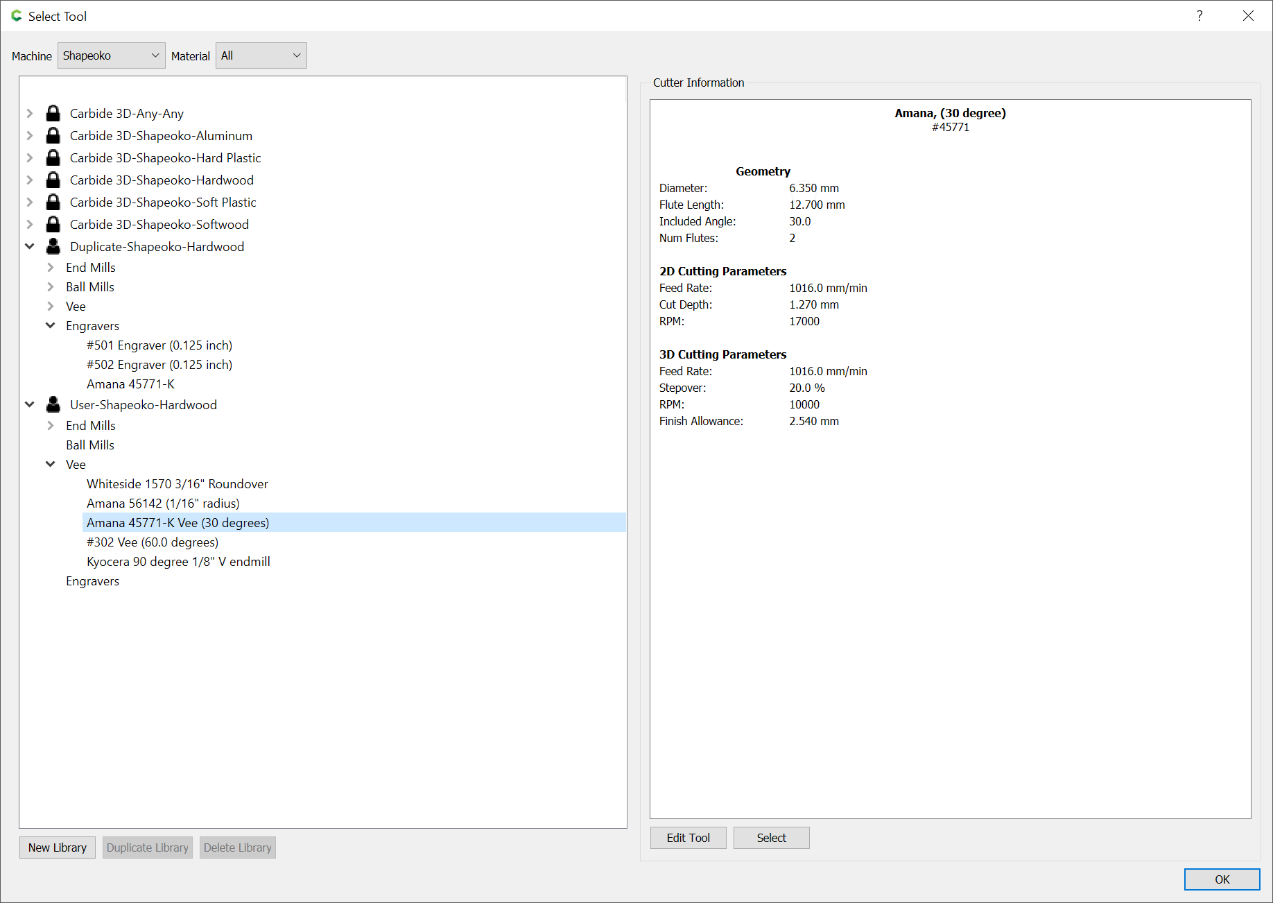

Can all v bit settings be added to carbide create I have purchased a set with 20/30 and 45 degree bits that are not in carbide. Have I wasted my money if I cannot use them
You can open the tool database and add these bits to the list. Add a new bit or copy one of the existing ones and change the included angle and diameter and assign a new tool number
There is a 30 degree V endmill in Carbide Create, but it’s entered as an Engraver:
I entered it as a normal V endmill:
using the settings:
which should work as a guide for the tooling which you have purchased.
