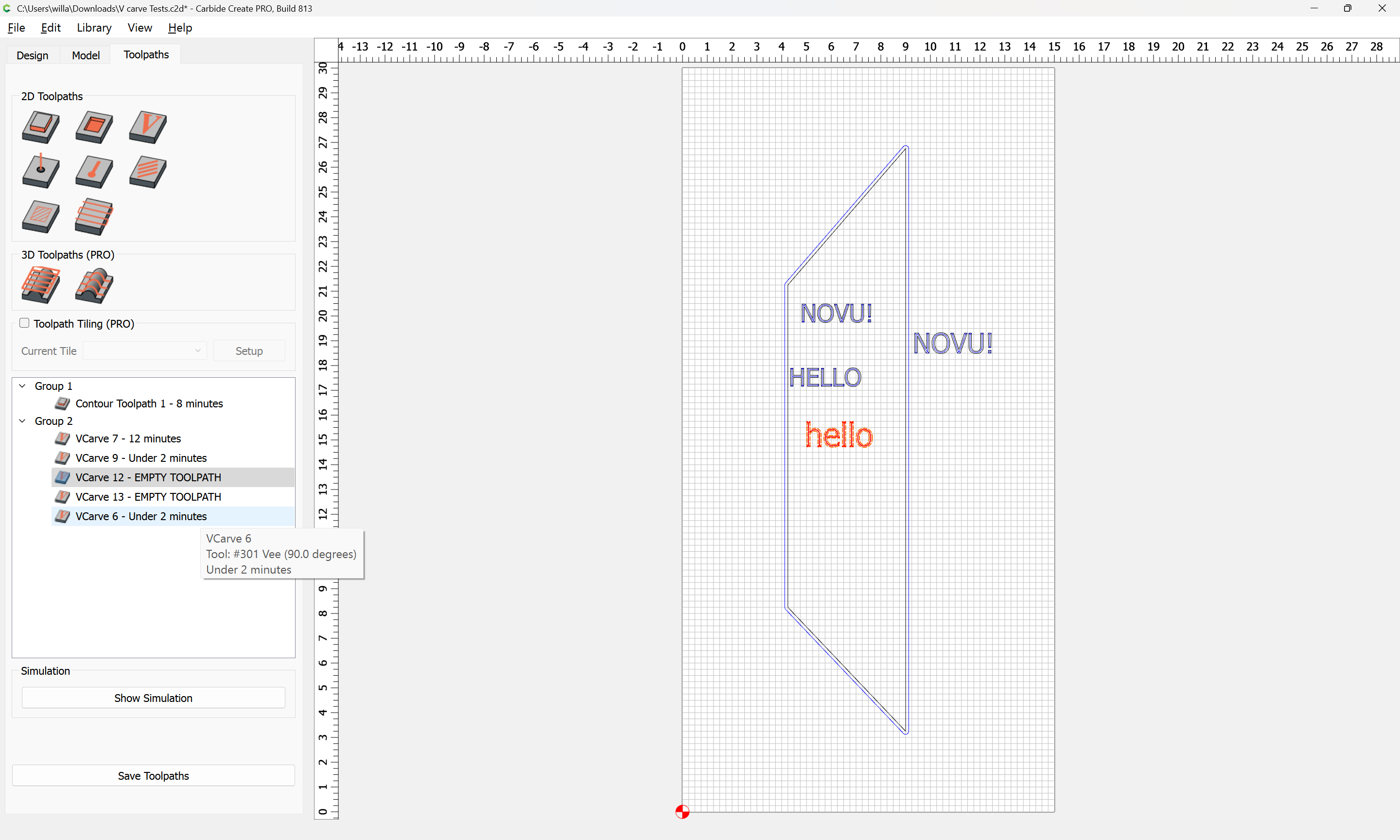

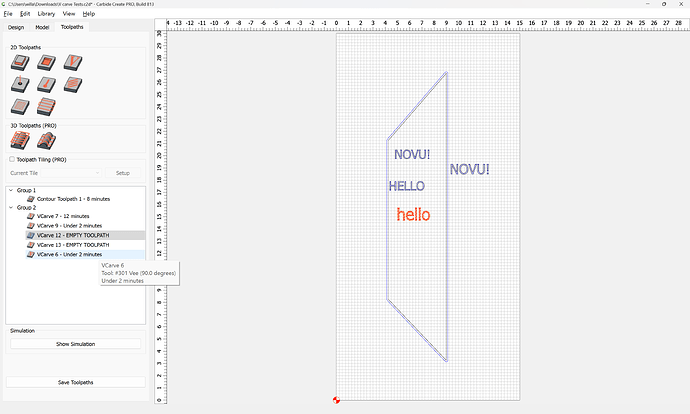

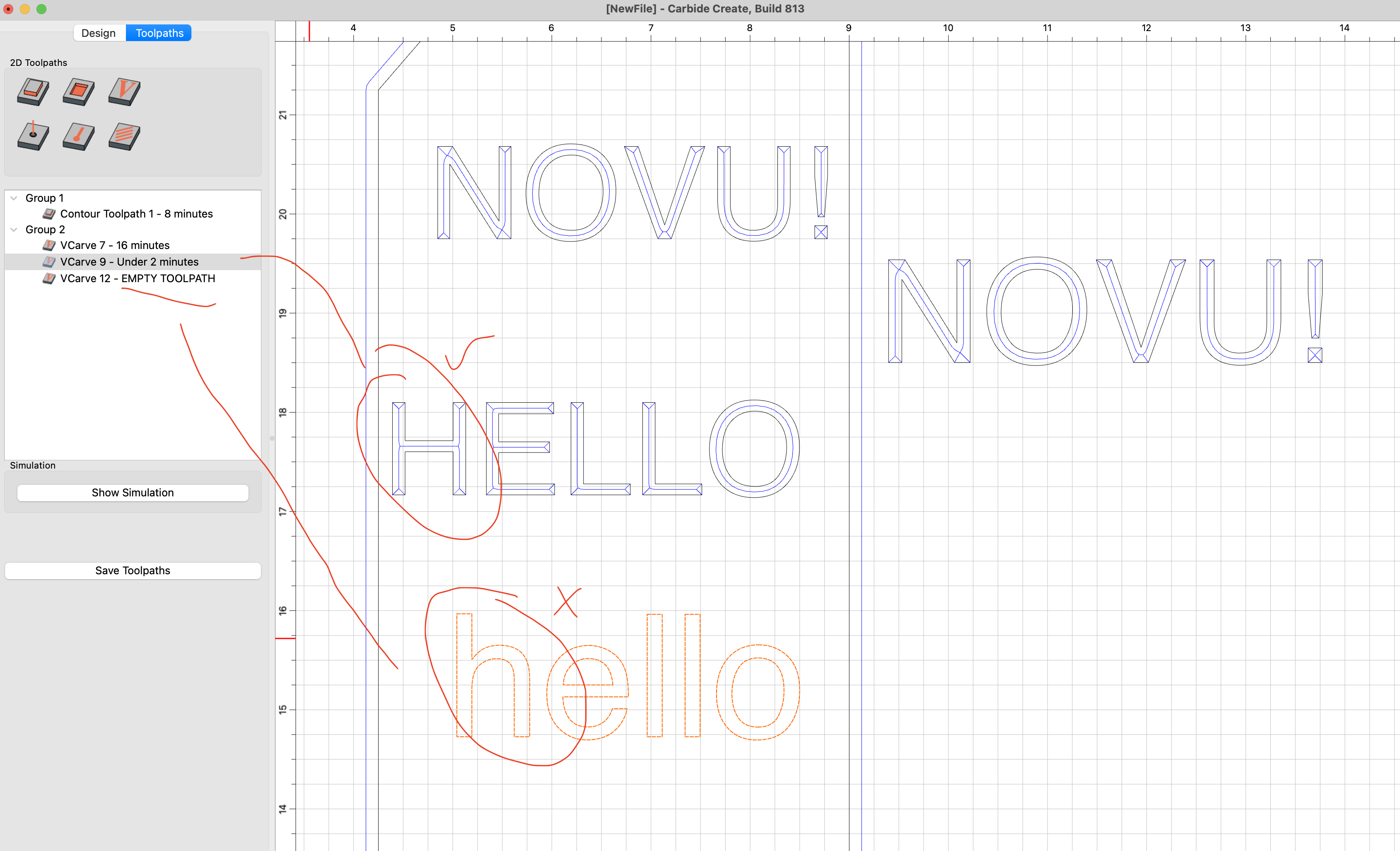

Hello everyone, first timer here.
Im messing around with Carbide Create to see how things work before I do the project.

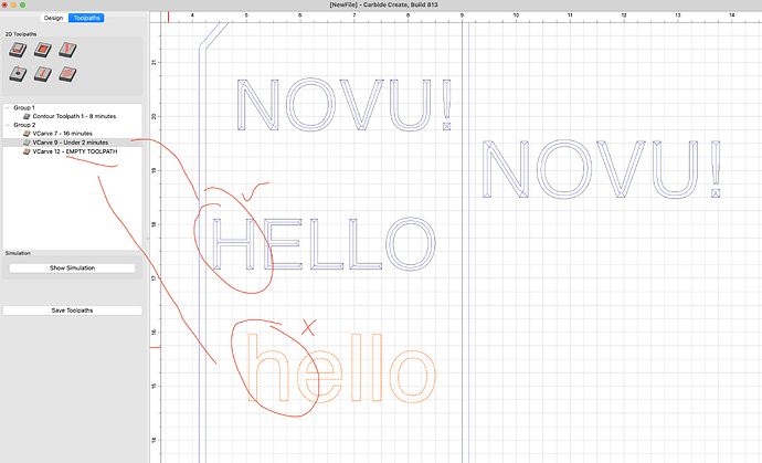

V carve tool path is super random and I can sometimes get it to work and other not.
Meaning- I can add a text, add a v carve tool path to it and itll give me the empty tool path error. then I delete and retry like several times, without changing any settings and then it would work and then not…
IDK if anyone can take a look and see what is wrong or not… online it looks like when others do it so easily and quality and I follow exactly what they do.
Id give more info if I knew what to say…
thank you!!
EDIT: I tried adding another “HELLO” all caps, the exact same thing and it wouldn’t create the tool path like the one above that worked…
V carve Tests.c2d (112 KB)

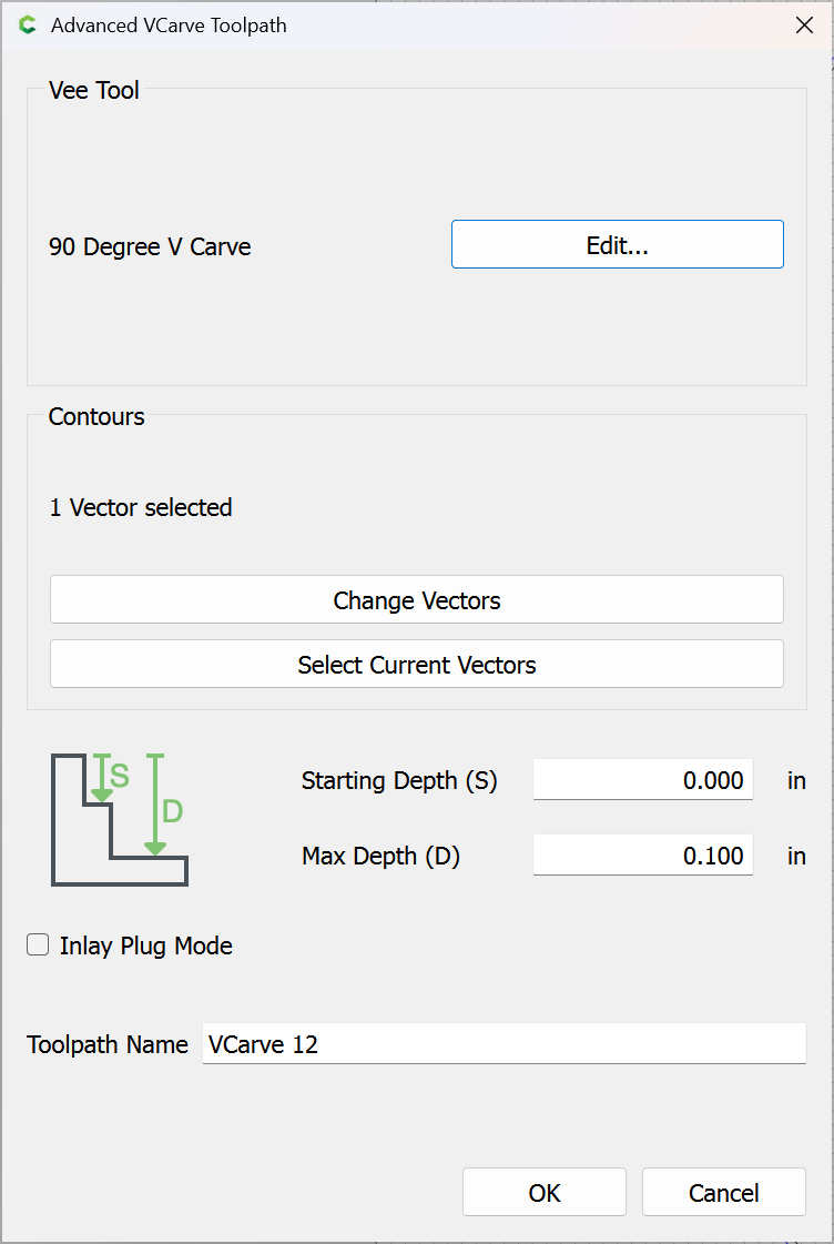

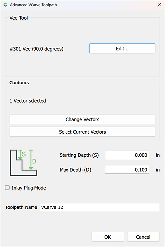

How is the “90 Degree Carve” tool defined?

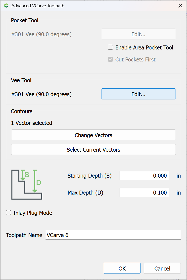

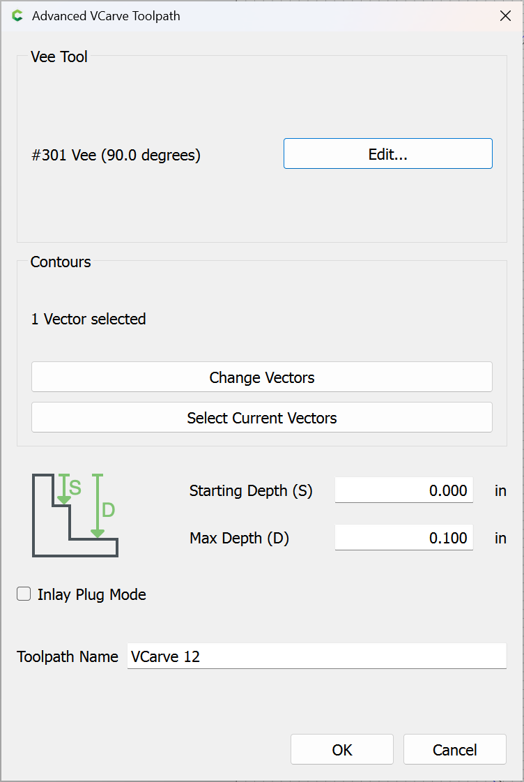

If changed to a #301 90 degree V tool:
by re-creating the toolpath, enabling pocket clearing, setting that to a #301
then unchecking it:
The toolpath works as expected:
ohhh shoot you know exactly whats going on!!
so basically I was trying to make a cut that wasn’t possible and I needed to remove extra material first (pocket cutting) so that the v carve can then go and cut the rest, right?
Not quite.
For the current version, the V carving toolpath requires that some tool which it deems appropriate is selected for the pocket clearing toolpath, even when it is not enabled.
ah ok , I see. i’ve been messing around with what you said and it works great. even with the tool that I added.
