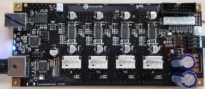

I screwed up and shorted the middle pin on the “reserved” connection to ground and my controller went dead. C3D does not have any boards in stock so I’m dead in the water unless I can fix the board I have.
It’s a longshot, but I’m thinking there must be a step-down circuit on the board somewhere that supplies 5V to the middle pin of the “reserved” connector. Does anyone have a circuit diagram so I can try to trace the fault? Troubleshooting through-hole circuit boards are tough enough for me, but SMT is another level.

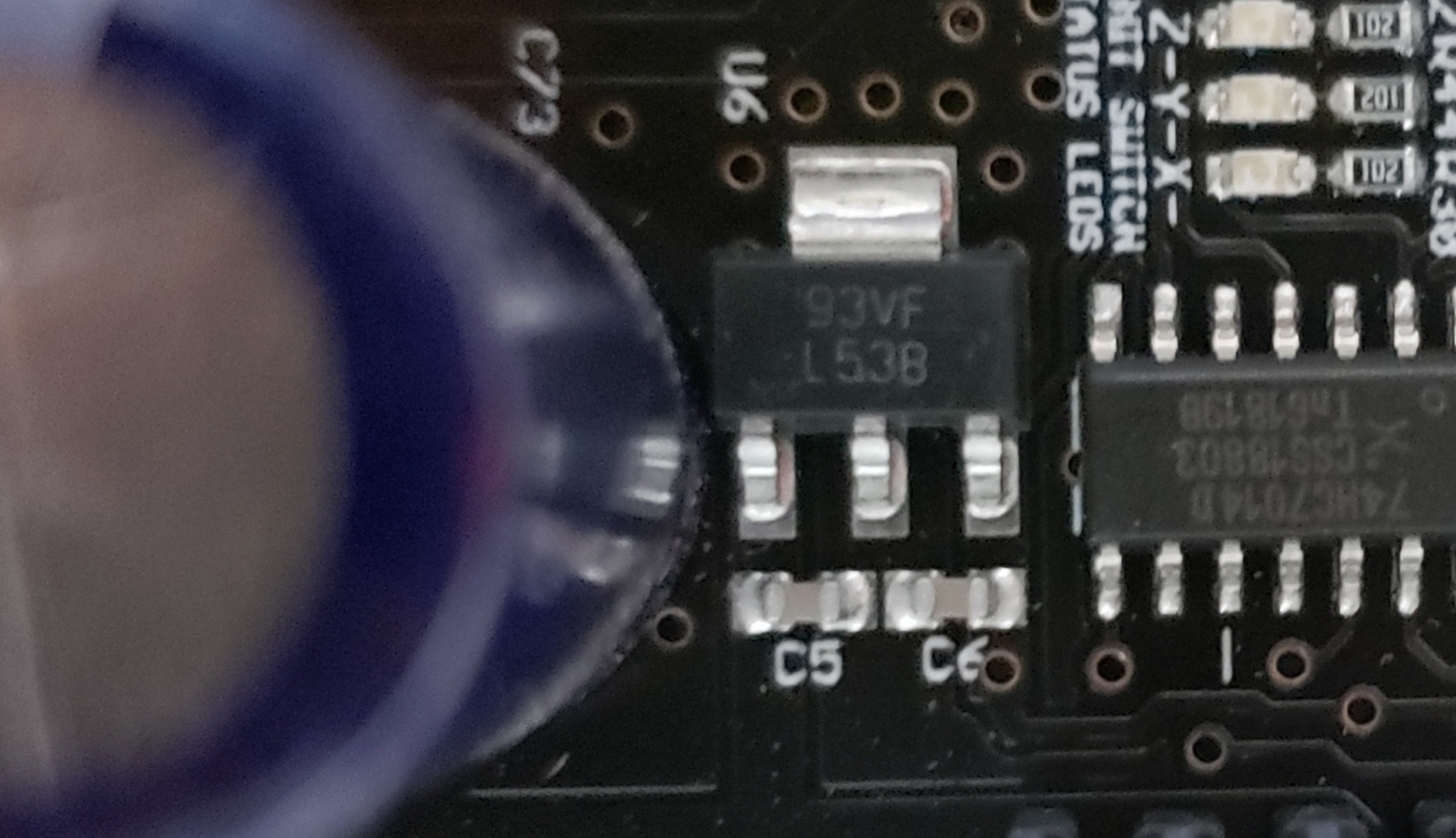

Carbide 3D won’t help with a schematic or a regulator manufacturer and part number and new boards are out of stock with no ETA, so I’m on my own with this repair if I want to get back to work. I found what I believe is the failed 5V regulator (marked 93VF L53B) and I’ve ordered a few from DigiKey (LM2940IMP-5.0, $1.56/ea). Fingers crossed!

Success! I soldered in the new regulator and my board is up and running again! I appreciate the replies and suggestions. C3D has new
boards in stock again, as of yesterday.

Nice work.
Did you use regular soldering iron or hot air?
