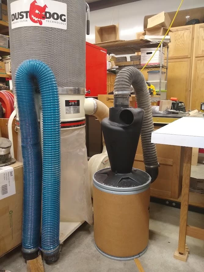

What vacuum are you using? I have a Ridgid 14-gallon unit with a Ridgid separator and it is sucking the bucket into itself.
I searched for a Ridgid dust separator and could not find one. If your bucket is being collapsed can you find a bucket the same size and replace it. I have a 6" Onieda cyclone separator with a fiber 10 gallon bucket and a Jet 1100 CFM dust collector. The fiber bucket is rigid enough to not collapse. Since I cannot see what you have maybe a 5 gallon paint bucket or 7 gallon bucket would work. The bigger the bucket the better. Even my Onieda sucks dust into Jet bag when it gets more then 2/3 full. So if I see dust collecting in the Jet bag I know it is time to empty the bucket.
What ever bucket you use empty it often to keep your efficiency up. Plug up any leaks because cyclonic separators loose efficiency if there are any air leaks at hoses or the bucket seal.
