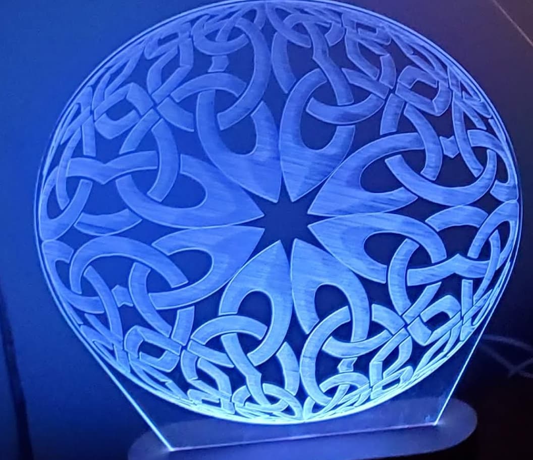

I’ve done something like this with the texture tool path. You can set the starting and max depth. The control is limited as each stroke will reach the max depth only in the center of the stroke so the effect changes based on line length. I experimented with it for Acrylic edge lit night lights. I wasn’t crazy about the effect.

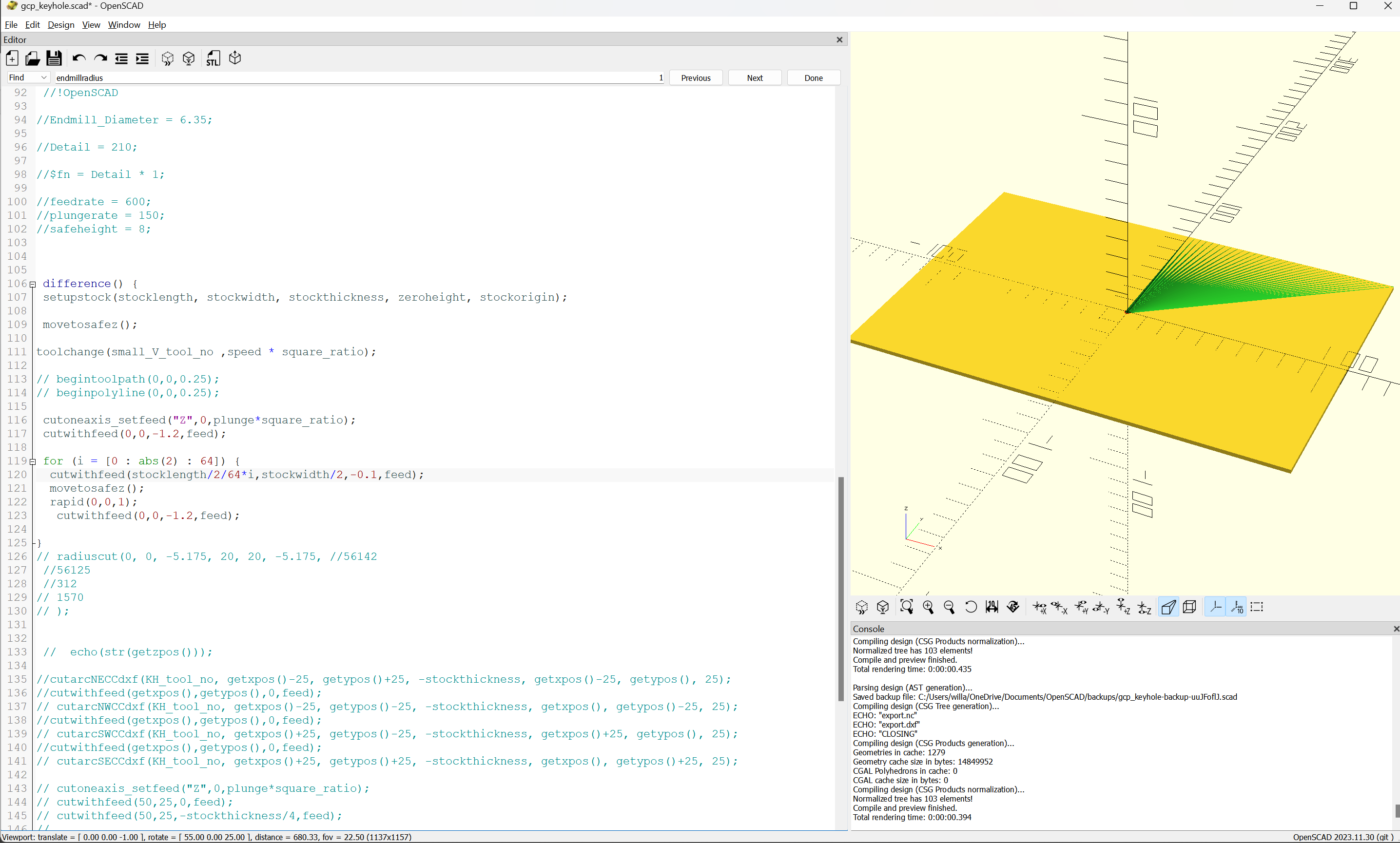

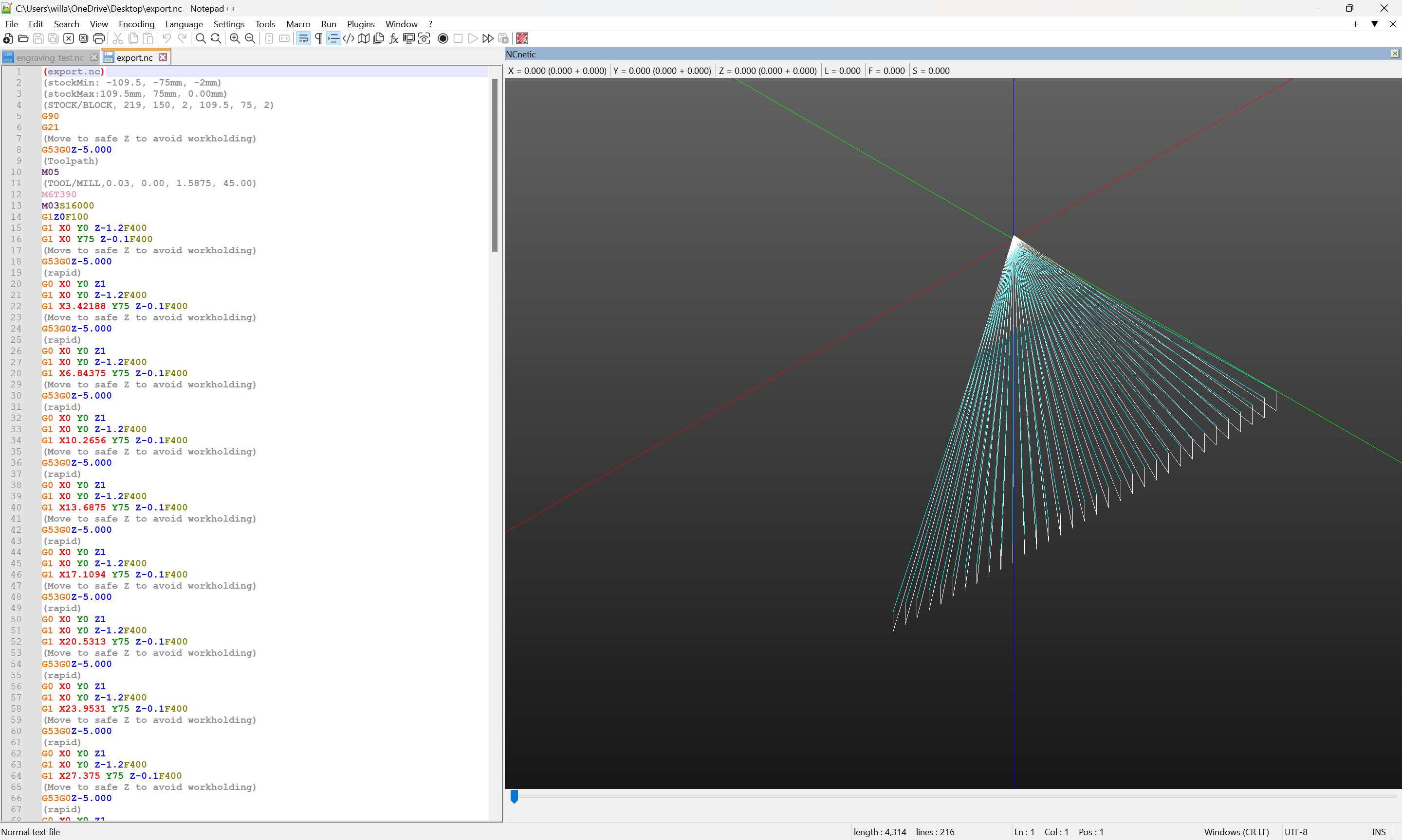

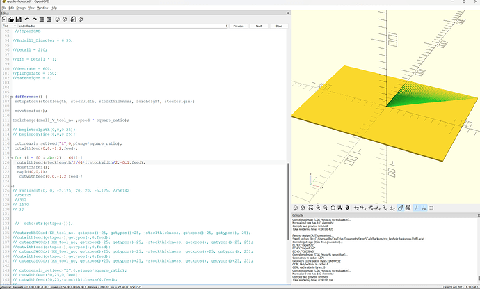

I couldn’t resist, here’s a test file for someone to try in acrylic:
export.nc (4.2 KB)
What size is this? Where is the origin?
Origin is 0,0
Max extent is X 75mm, Y109.5mm
