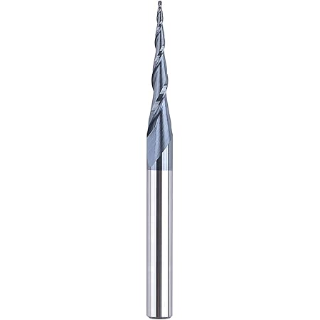

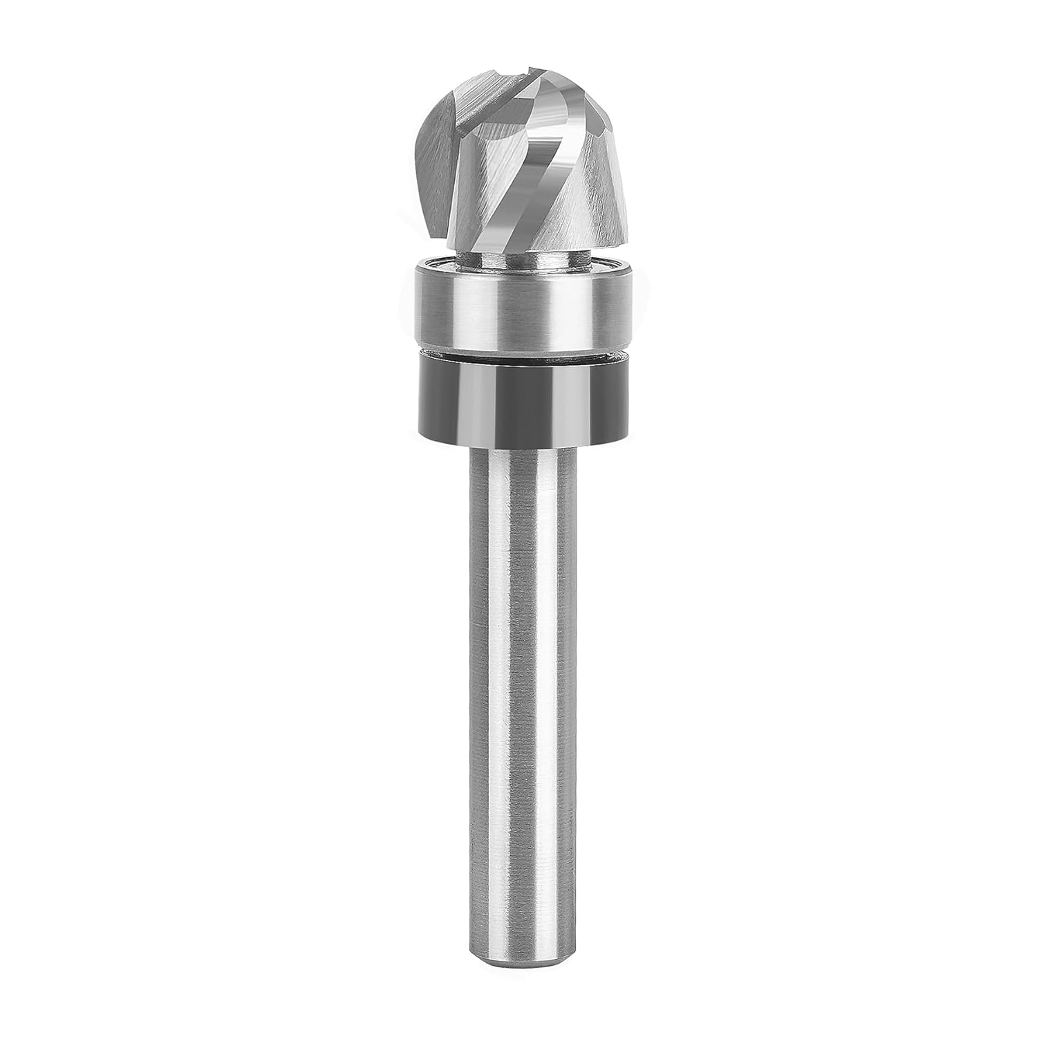

Would it be better to use one of those Spiral Tapered Ball Nose Spiral Router Bits:

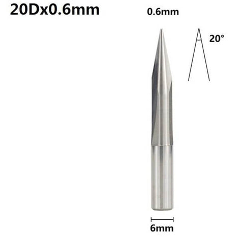

or is it better to use those VCarve bits:

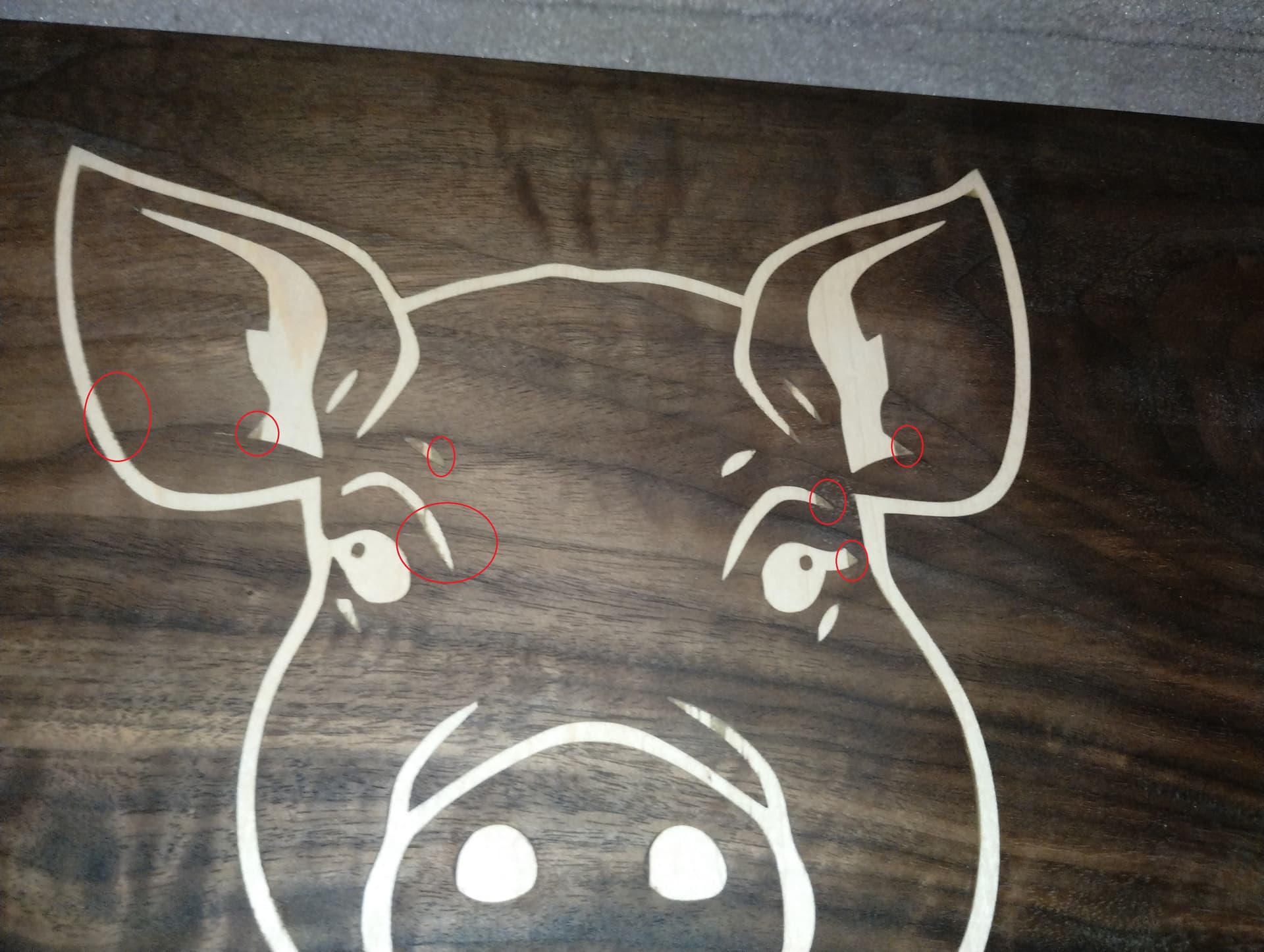

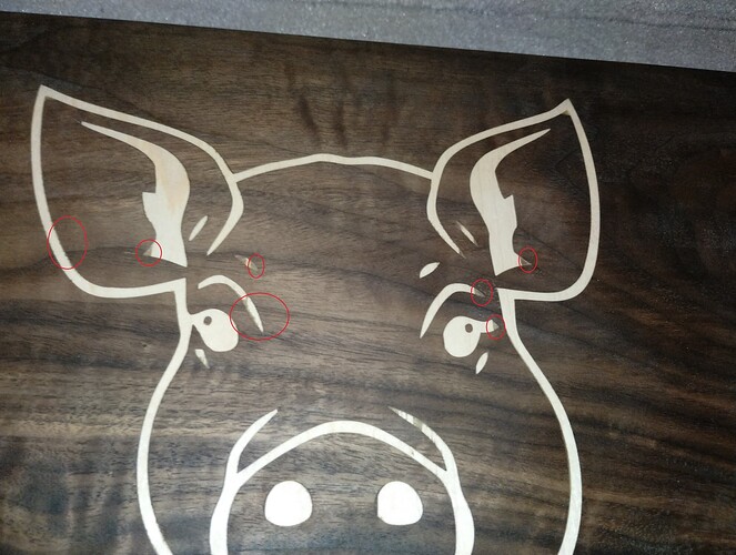

I used the 2nd ones with the two straight edges, went well with end grain boards, but the plug for side grain cuts (alongside the grain) broke off some pieces since the wood likes to break alongside the grains. With several cutting edges would that be possibly better?

And in CC the tip degree value can be entered freely, therefore this does not matter.
The tool needs to have a pointy tip, so that the entered angle matches what Carbide Create expects — the tapered ball-nose tools are not supported (some folks here have gotten them to work by determining what angle a tool of that cutting flute length would be w/o the ball tip).
Upload photos showing the cutting problems you had?
Since I filled the gaps with wood filler (sanding dust+superglue) and the boards are already with customers there is just one image of a finished board
but I understand what you mean, the CC expects a zero tip.
