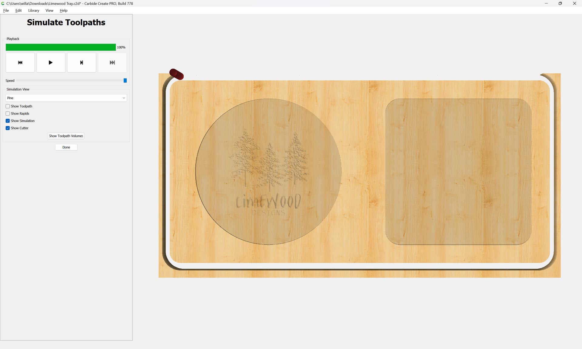

Vcarve of logo doesn't look good
I’m trying to Vcarve my logo into this tray but in the simulation it doesn’t look good. Any suggestions?

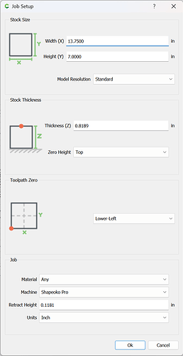

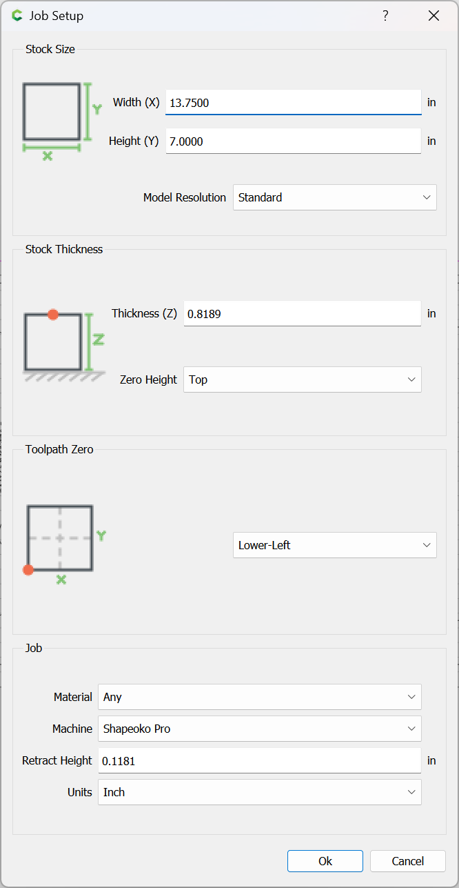

If you use a smaller Stock size:

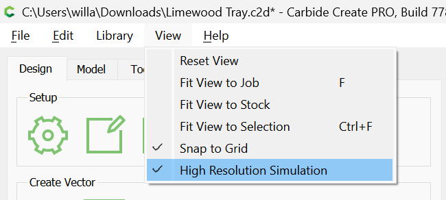

the preview will look better:
Also be sure to use High Resolution Simulation:
Thank you so much! I didn’t realize that would be a factor! It looks so much better!
Just want to mention that it is a factor in the simulation, but not the actual cut:
The setting shown by Will only affects how the simulation looks. It does not have an effect on the cut itself.
