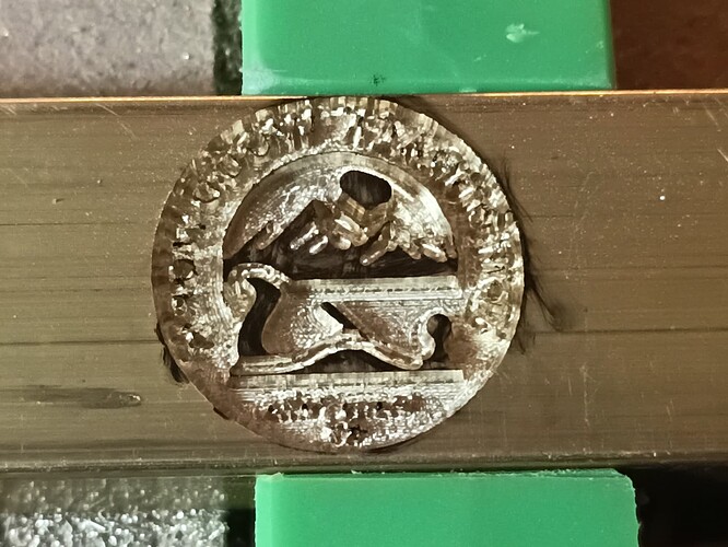

try yo make a branding iron from brass. Intended to have some details.
brand iron front.c2d (200 KB)

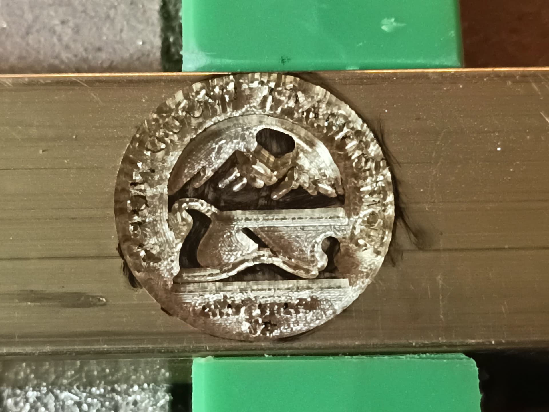

Came out like this with 20 deg bit:
Obviously the cuts are wider than designed, so the structures are not acceptable.
Thought get a new one, this time with 15 deg sharp tip, was delivered with a really decent tip, cut my finger a little.
Now the tip very soon became dull: it is my impression that already Z-zeroing broadened the very sensitive tip, also IMO the bit setting process dulled it further, and the very first cuts also made the tip much less accentuated, and it is no surprise that the result is not much different. Of course, because when the cutter cuts into the material into a depth that expects a very sharp tip but it is not as sharp the cut path is wider on the surface.
Now there are V-carve bits with a defined tip diameter. I could not find in CC how to tell the database the diameter of the tip, I think CC always assumes a 0-tip.
A 1/32 bit would not carve the details as pocket.
I have seen coin size cuts, so there might be a way to cut very fine structures.
Workaround?
Take a close look at the tip of your 20 degree vee bit. Some vee bits have a rounded tip and others get the tip broken off since they are quite delicate. CC expects a sharp point on the end of your vee bit. If your tip does not go to a sharp point then the carving will not be the correct depths because the vee bit cuts deeper than what you expect. You might need to get a magnifier glass out to inspect the tip of the vee bit.
See if a #501 or 502 engraver (which is suited to metal) will yield the desired level of detail?
I will preface this by saying that the smallest emblem I have cut in brass was about 1x2 inches with a 32nd in endmill. So, for what its worth: looking at the size of the details in the iron, there are letters which are 0.0044 inch (~1/256in) apart. Even if the iron could be cut with a 15 degree v bit, the depth of cut between letters this near to each other would only be ~0.015 inch (~1/64 in) deep . I question if that would be deep enough for a functional branding iron.

The 502 has an included angle of 40 degrees which will reduce the depth of the engraving significantly. Geometrically this is far worse than the 15 degree v bit for this cut. It will be useless as a branding iron (but a good exercise in milling), unless you are willing to go up in size. Success can be approached with a 1/32 inch end mill by increasing the overall iron size (110-120%??), changing the font to a larger one with a much narrower stroke width, and reducing the size of the graphic logo. Essentially, anything you want burned can be narrowed as the contrast will make it visible more than its size. By narrowing these elements you gain distance between them with a goal of 1/32 inch, allowing pocketing with a 1/32 inch end mill. DOC of around 0.100 inch should prevent scorching (according to AI). If you can pick a font/size that allows detail with “G”, “A”, “W”, and “X” , with a 1/32 end mill, you are there. Cheers.
Bozo, thanks!!! Your lesson steeped my learning curve! So essentially a V-carve is not the best idea for a branding iron, it must be a straight bit: understood!
And the pattern must be adjusted that the details may be carved with such a bit. Got it! And rather fine details than wide ones. Will give it a shot! Thanks a lot!

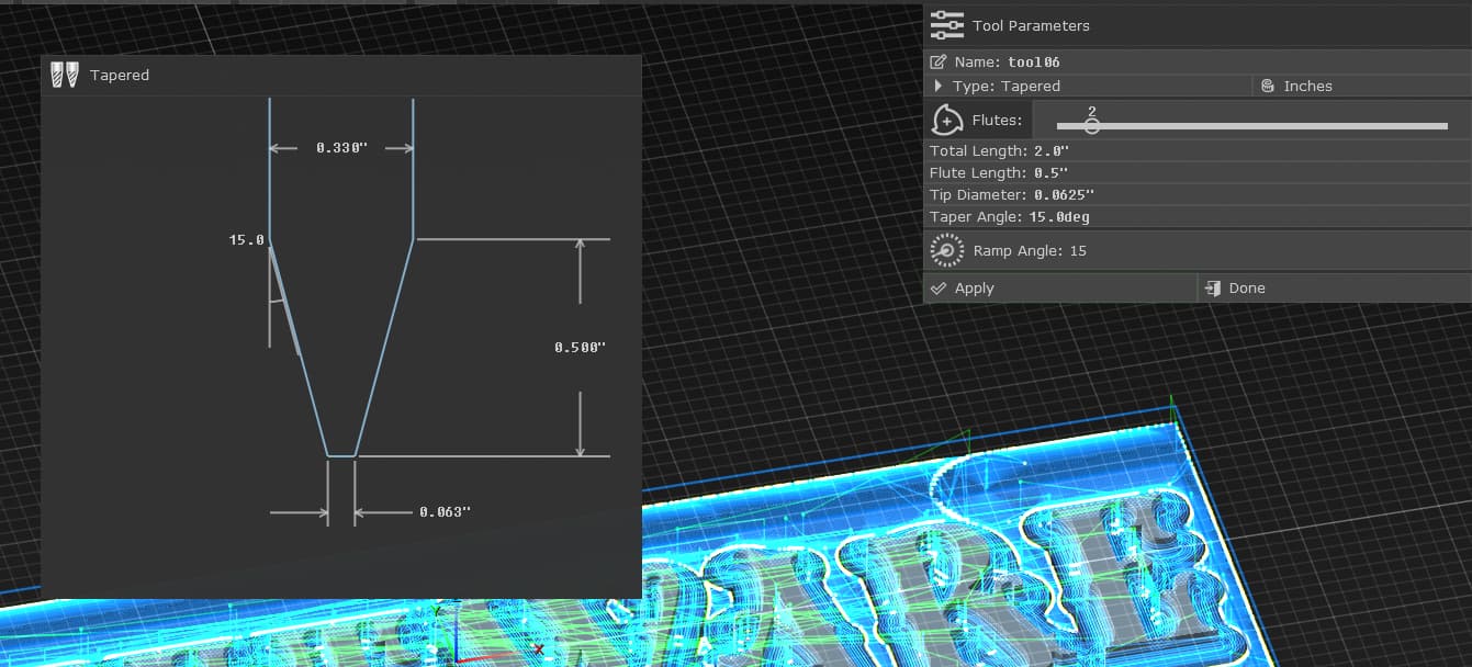

Just putting this out there: PixelCNC allows for tapered endmills with a flat on the tip, but you’ll have to define them with the taper angle (i.e. half of the V-bit angle) whereas with a proper V-bit you just put the angle of the V in the tool definition.
Then the tool can be used to generate a V-carving cutpath, at least wherever the contour being used isn’t narrower than the specified tip diameter for the cutting tool definition being used.
