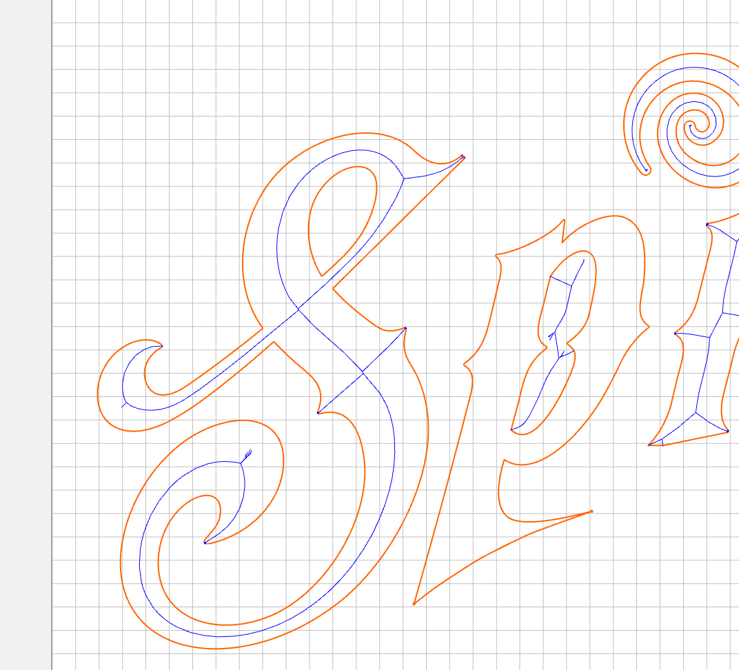

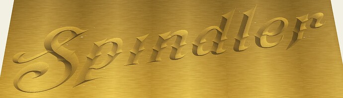

I’m betting I’m doing something dumb here, but I’m trying to VCarve a sign for a friend/customer and I’m having a bit of trouble.
First issue is, Carbide Create seems locked into just vcarving the inner part of the letter P (see attached image).

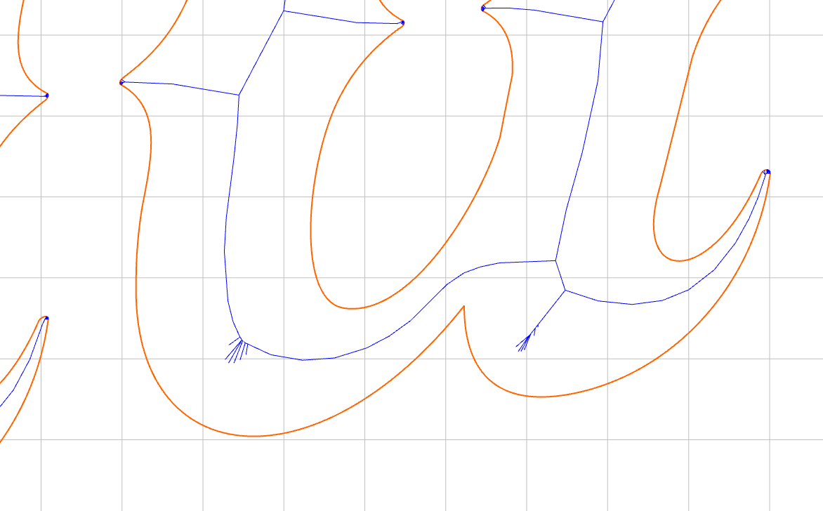

Second issue is there seems to be a lot of tool paths in ares like the belly of the “d” (see attached image).
Any suggestions?
I’d have guessed there was an open vector somewhere, but if there is one, I don’t see it.

The problem you are having with the letter ‘p’ is that is is not a closed vector, so the VCarve ignores it:
Select the outline of the letter, use the ‘Join Vectors’ command, then edit the toolpath to be all the vectors of the word.

Wild - thank you @mhotchin - I swore I did that! Redoing it now, that part works. There are still weird “extra lines” in the tool paths though - do you think that will be a problem?
The V-carving algorithm “picks” at sharp points or areas of curves where the algorithm determines that additional material should be removed.
If you have a well-drawn design which has smooth curves but which the V-carving of does not match the drawn curves well, please let us know and we will look into it with you.

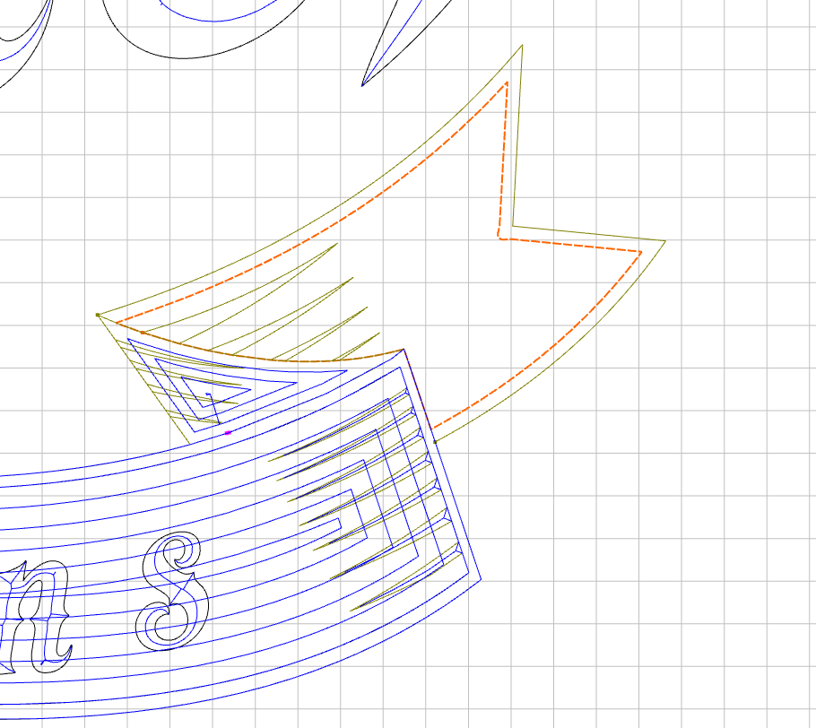

More help requires gents - I have this one section that is showing as an empty tool path. I’m again positive I’ve closed all the vectors and there’s no other cut that takes place in this area such that there’d be no stock to cut. Any suggestions?
Spindler2.c2d (344 KB)
NVM - apparently I must not have clicked close vector enough times? Seems to be inconsistenly happening.
I think you found a bug. If you move that vector to the Default layer, then it is properly colored magenta as an open vector.
On the original layer, it’s just the layer color.
