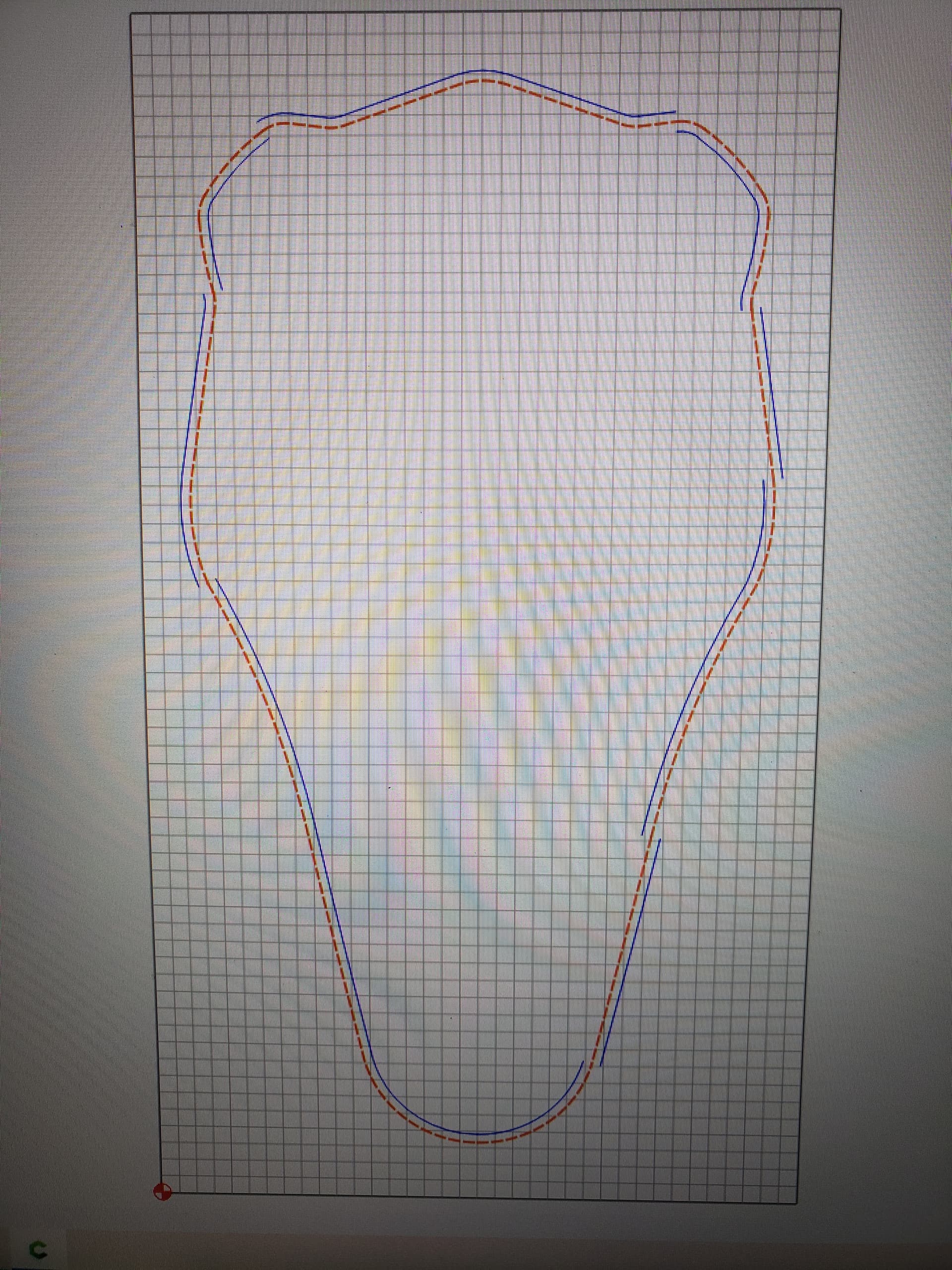

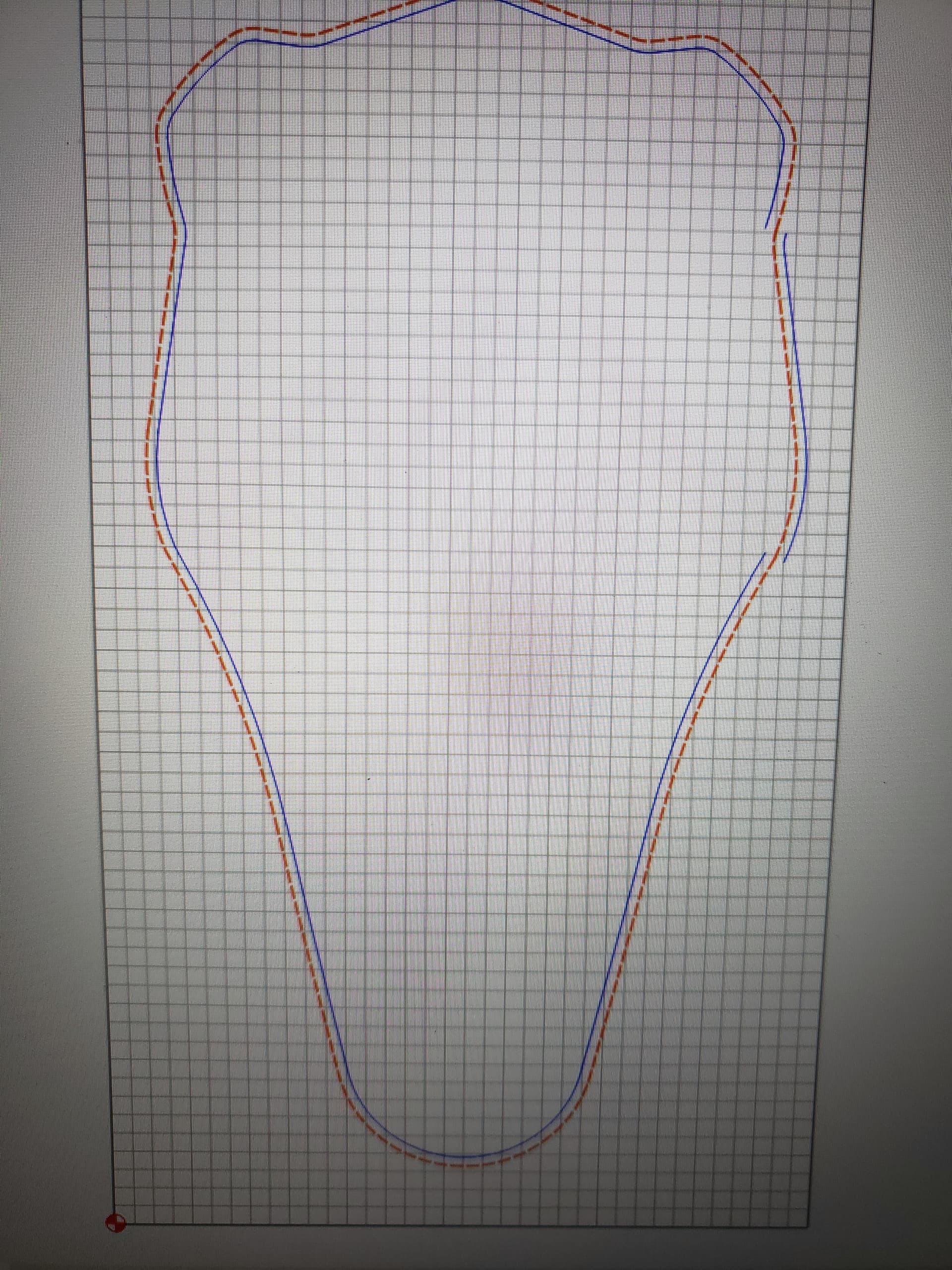

I have a file for a plaque to cut out. Its a simple contour cutout, no pocketing or anything like that. It shows up purple so if I’m correct, thats an open vector. I boxed it in and clicked the join vectors button. When I make a tool path to cut outside, the lower half is showing the cut on the inside while the upper half is showing an outside cut. I can’t seem to get it to do a full cut all the way around the outside. Any thoughts?

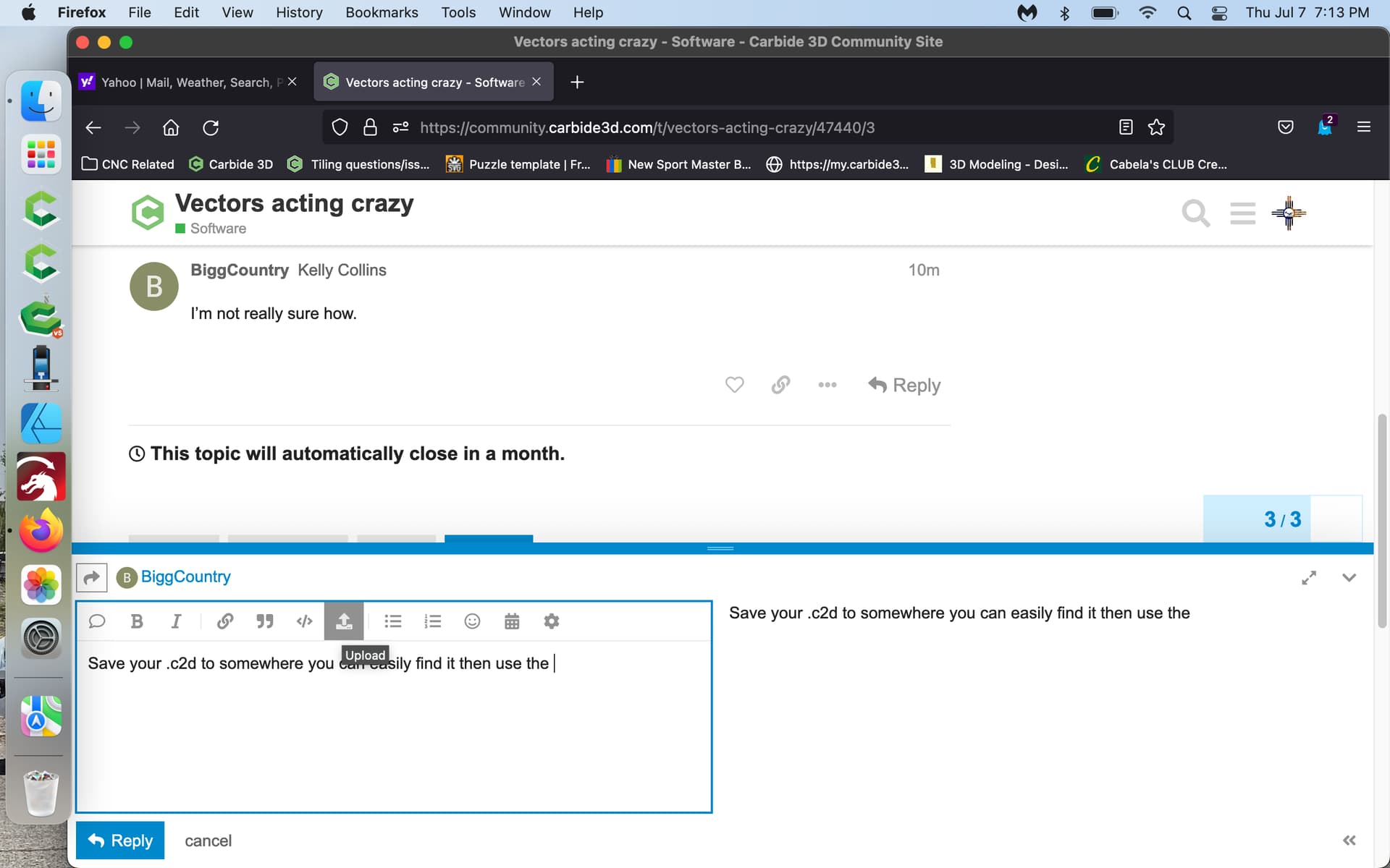

I’m not really sure how.
Save your .c2d to somewhere you can easily find it then use the Upload button to post it.

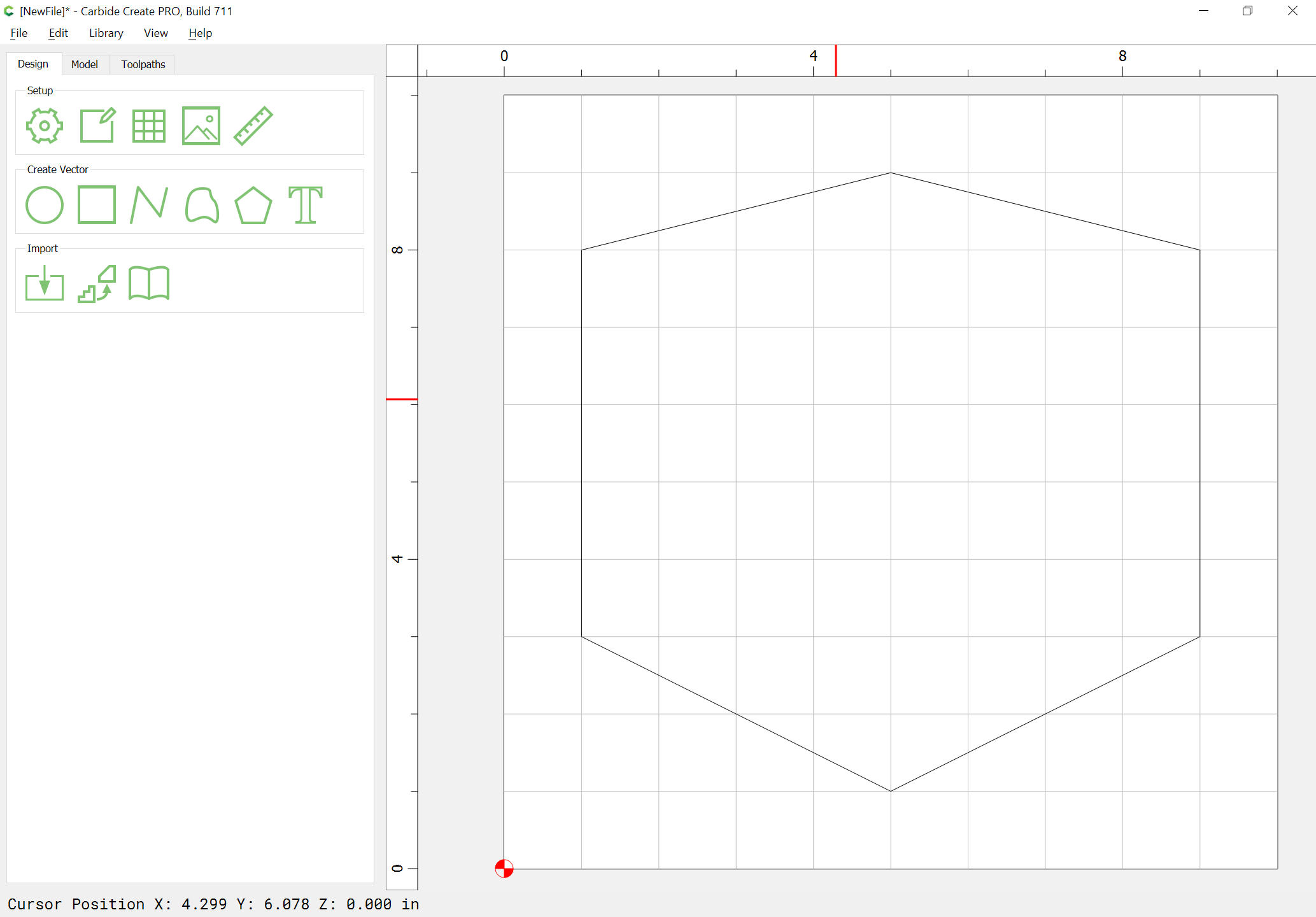

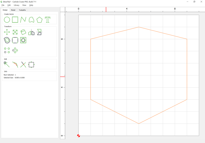

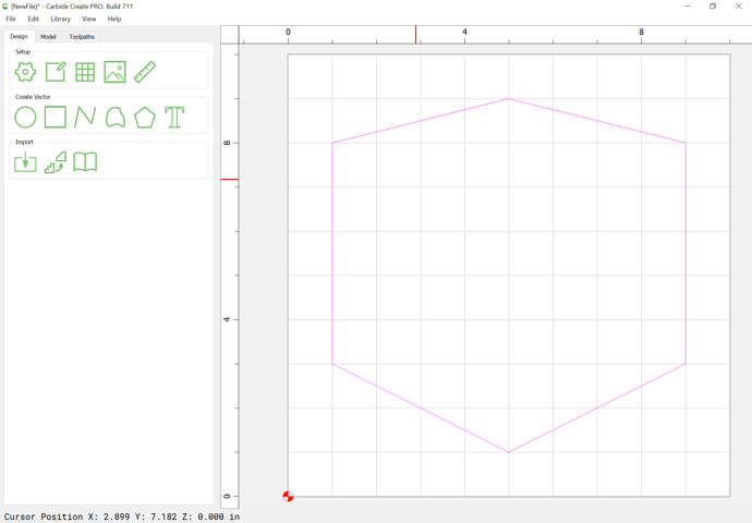

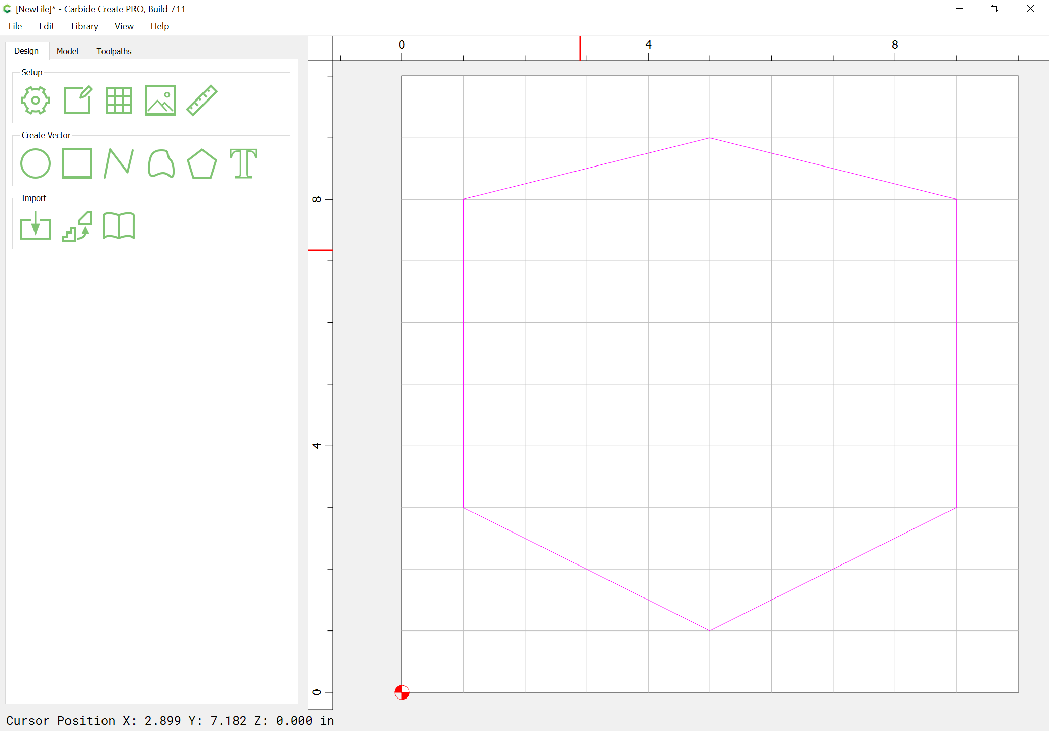

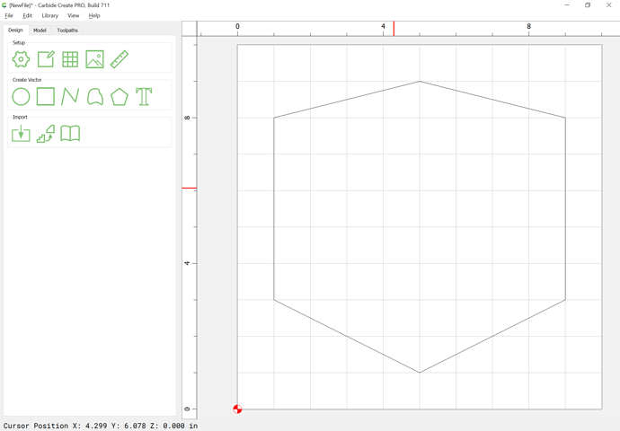

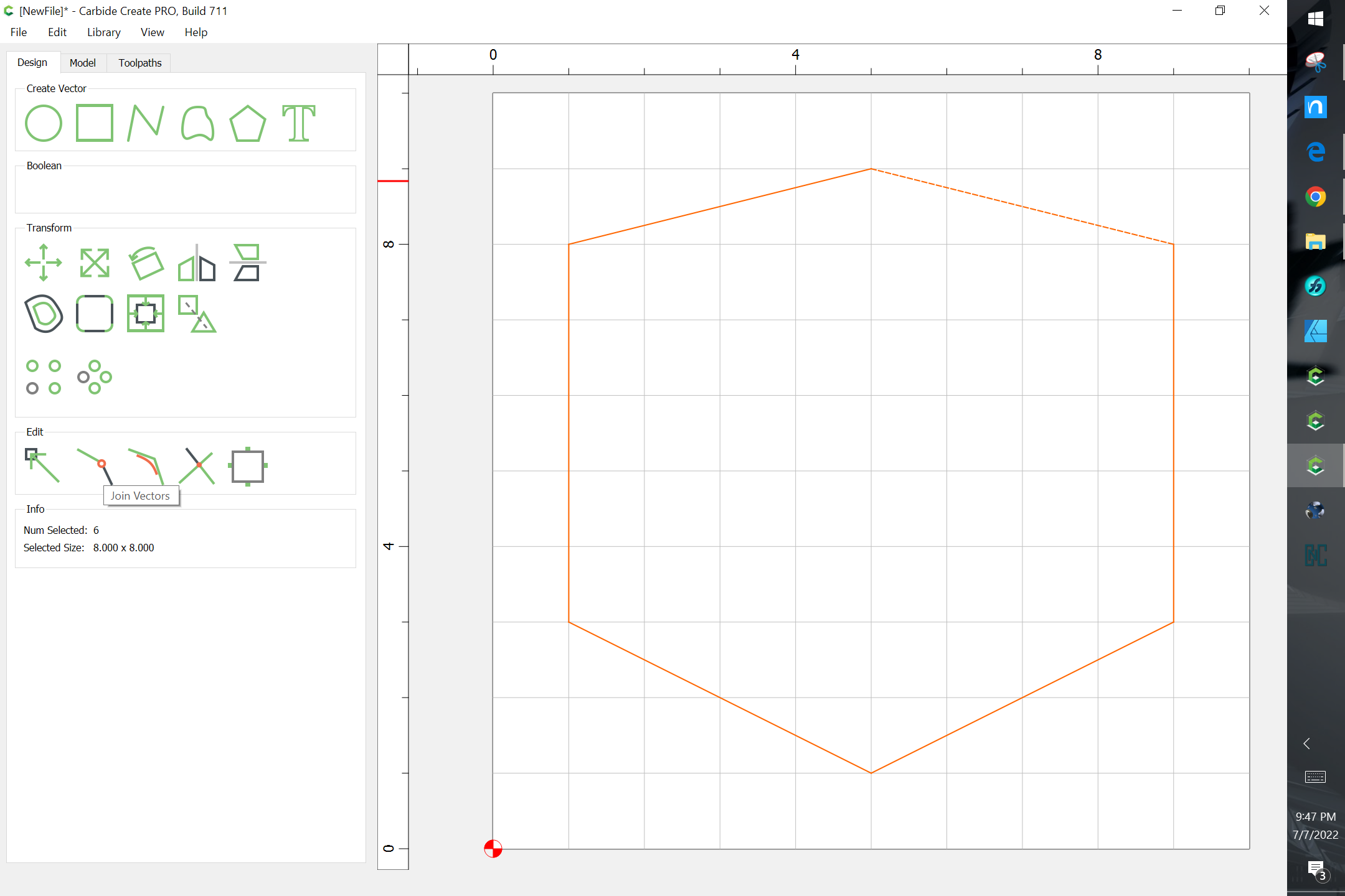

Select all the geometry:
and use the Join Vectors command:

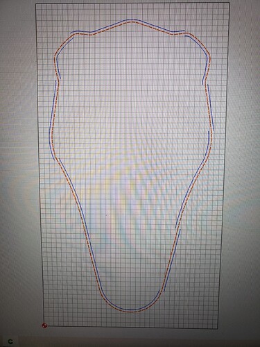

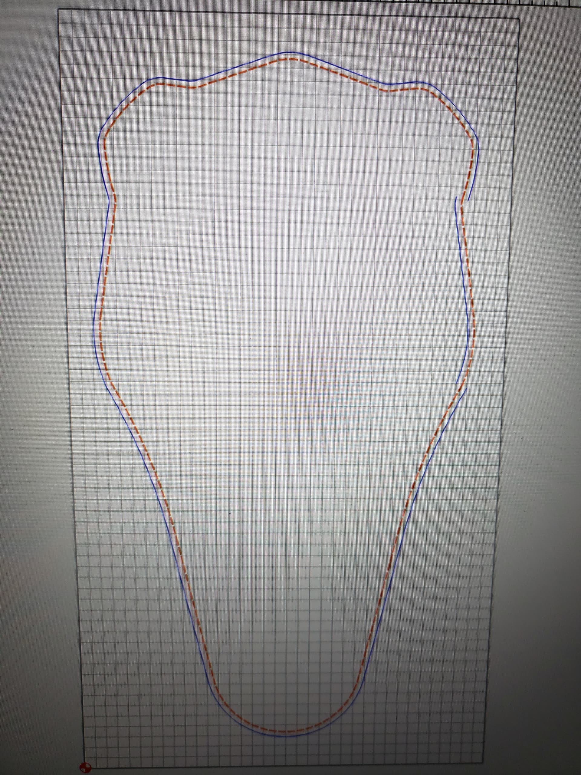

I tried that. Then when I go to create my contour tool path, it does the same thing. But I’m also not getting it to turn black. I just tried it again and everything connected except one spot. It is the only spot where the toolpath is showing on the inside even though it is set to outside.
This is what it looks like when set to OUTSIDE/RIGHT
If the file won’t close, then parts don’t match up.

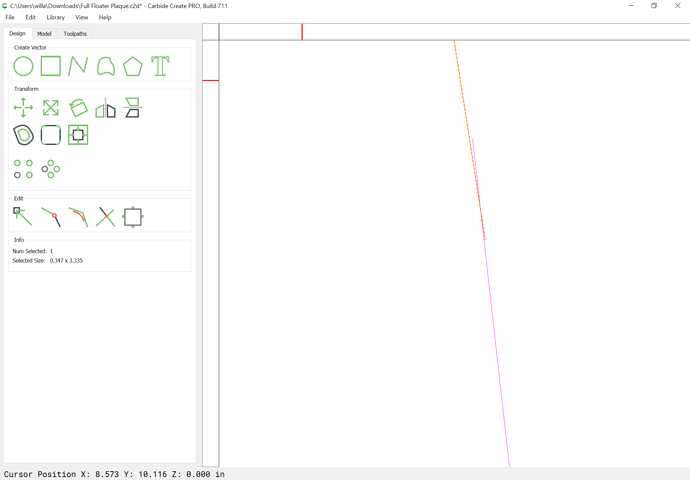

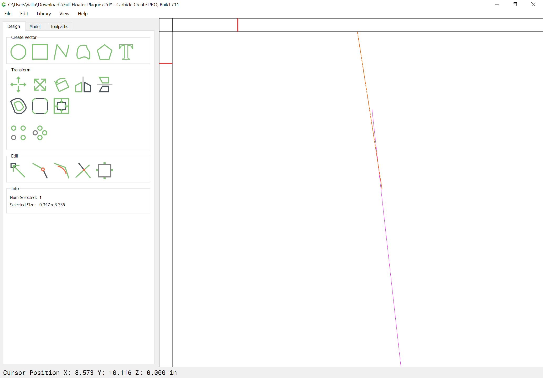

The reason this file won’t close is because the vectors don’t meet, but instead pass each other:

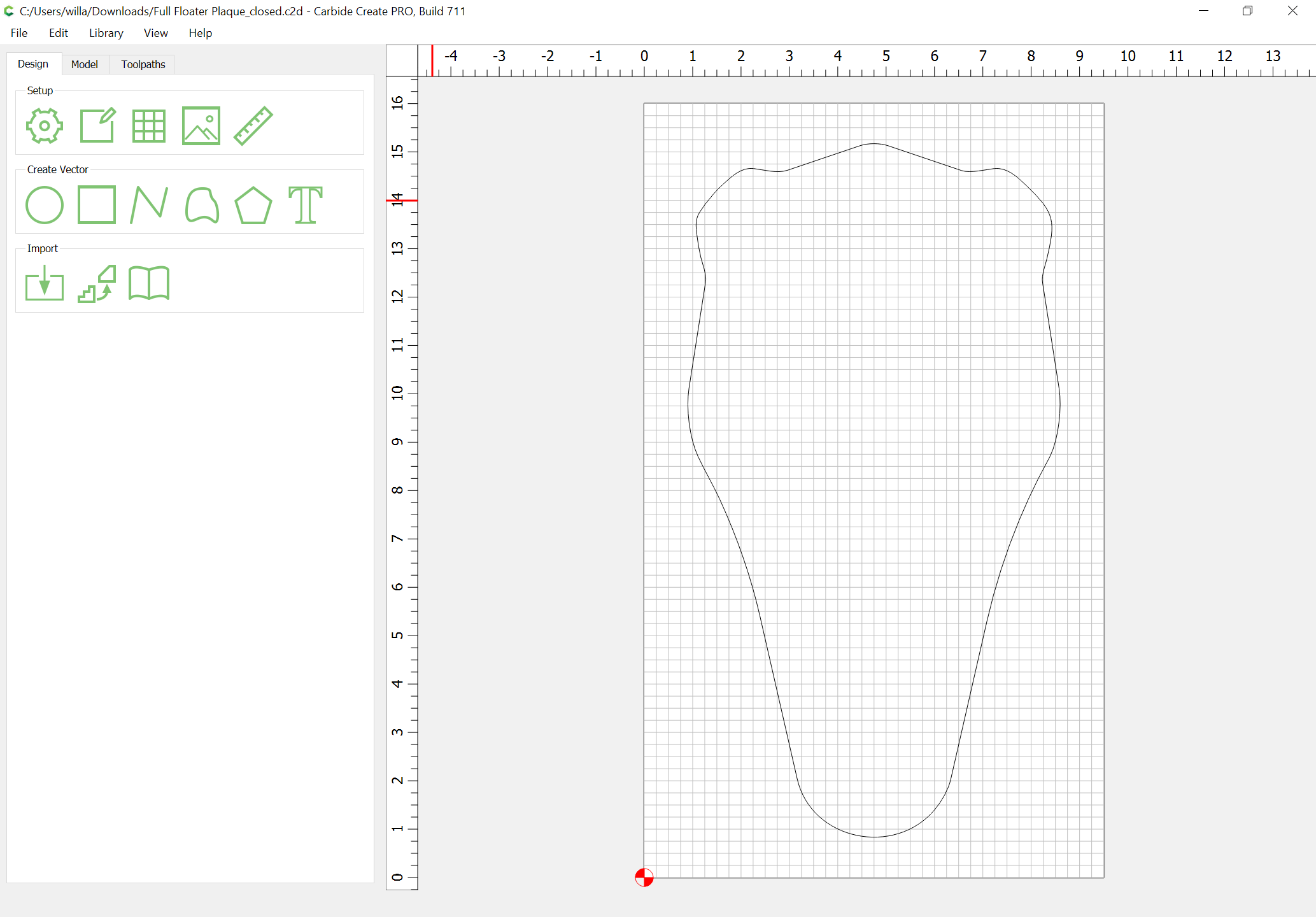

EDIT: See v6 file below.

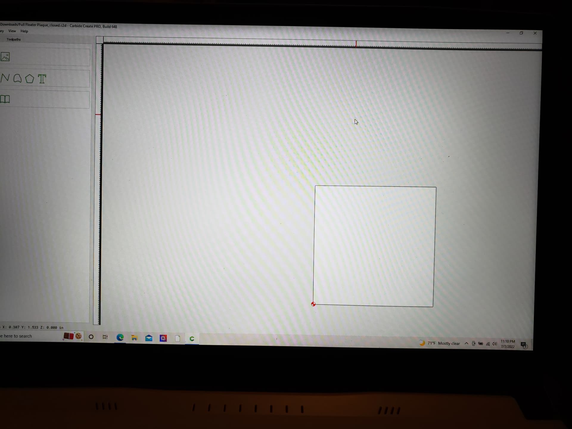

When I open the file for the plaque closed, I get a box without the plaque.
My apologies, used the v7 beta.
Here’s a v6 file:
Full Floater Plaque_closed_v6.c2d (12.9 KB)
Thank you guys so much. I may actually get to keep some of my hair since I’ve pulled half of it out. lol. You guys rock.
