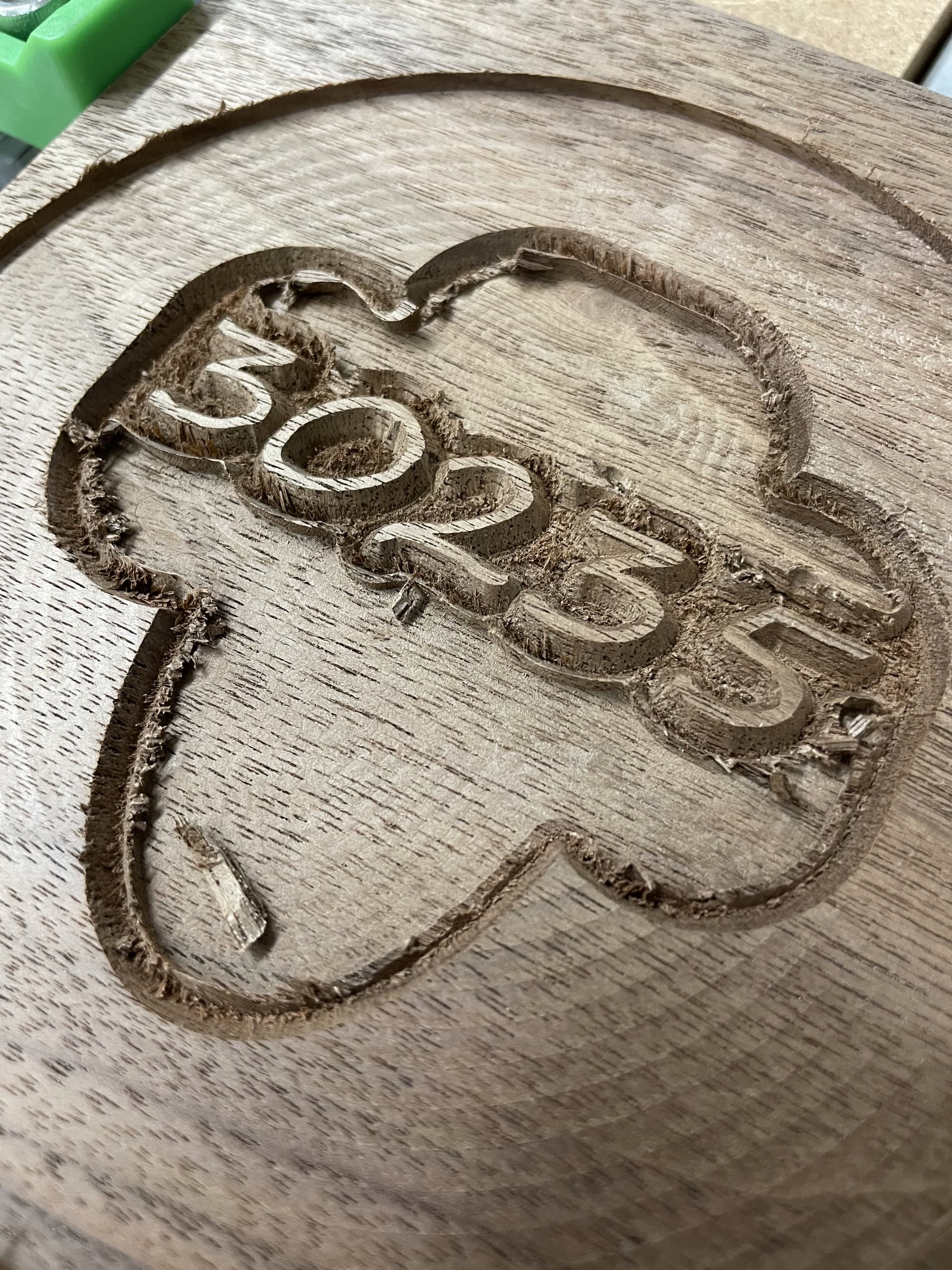

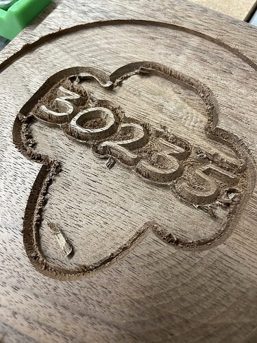

I was working on a set of coasters yesterday and the advanced vee carve left a little wall of material around everything. In the images you can see a closeup of one and then a pair where I cleaned up with an Xacto knife. It isn’t a big deal but I am trying to make a bunch of these so I don’t want to have to do that cleanup on all of them and I have not experienced this before.

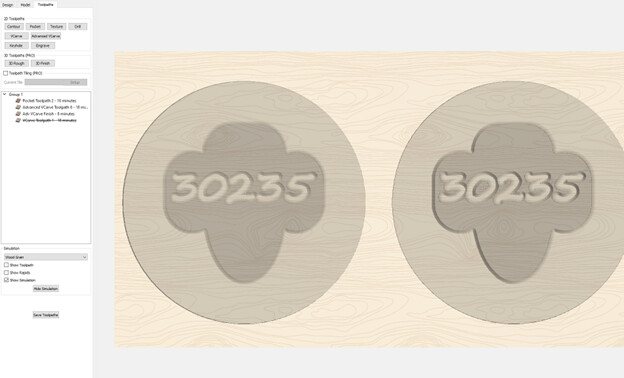

That wall is not just fuzzies, its pretty firmly rooted. It is not shown in the simulation.

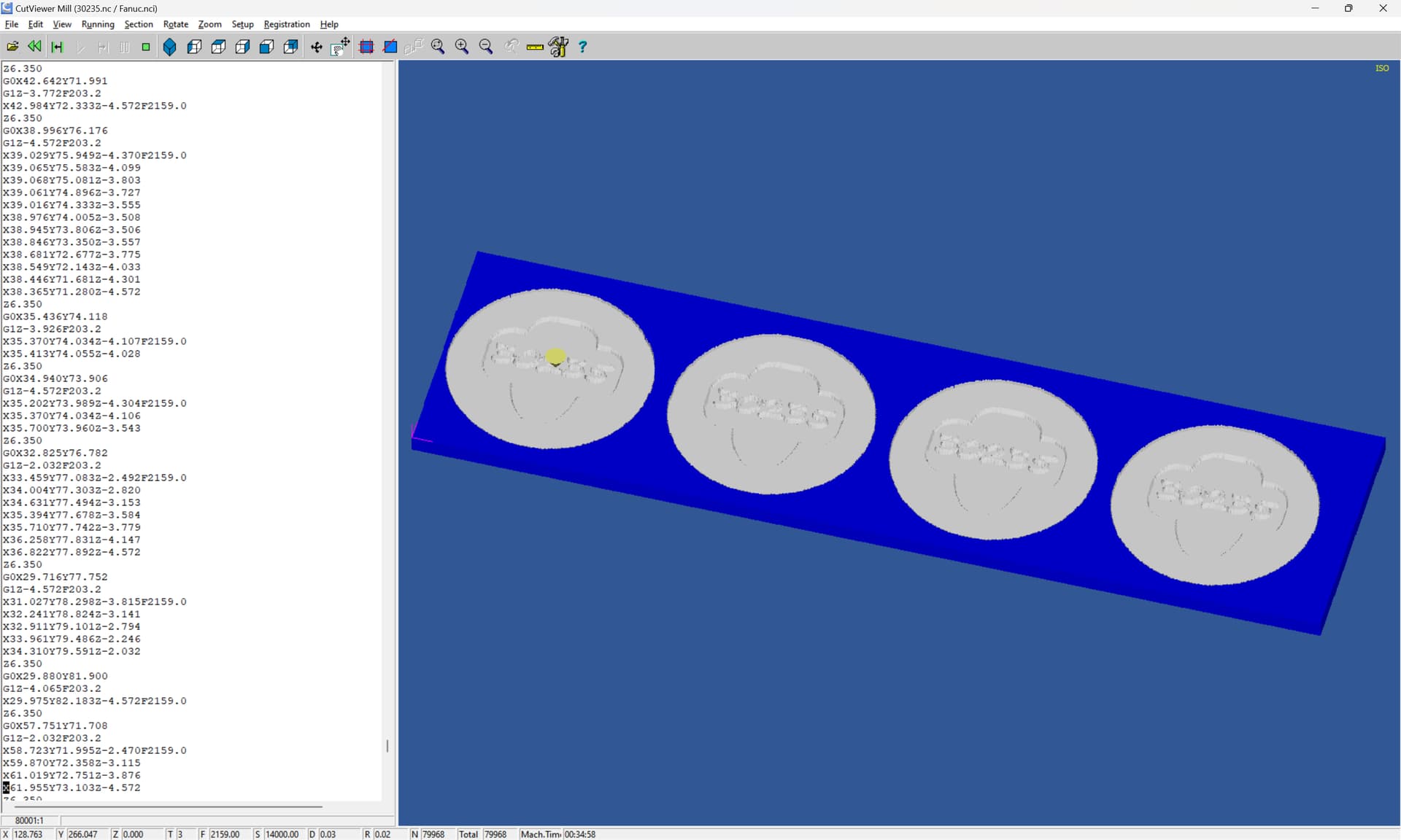

A preview of the G-code cutting doesn’t show this:

The height of that wall that is left from the bottom of the emblem is about .06 although somewhat hard to measure. The wall remaining seems to be a consistent distance away from the other surfaces across the entire width 20.5" width.

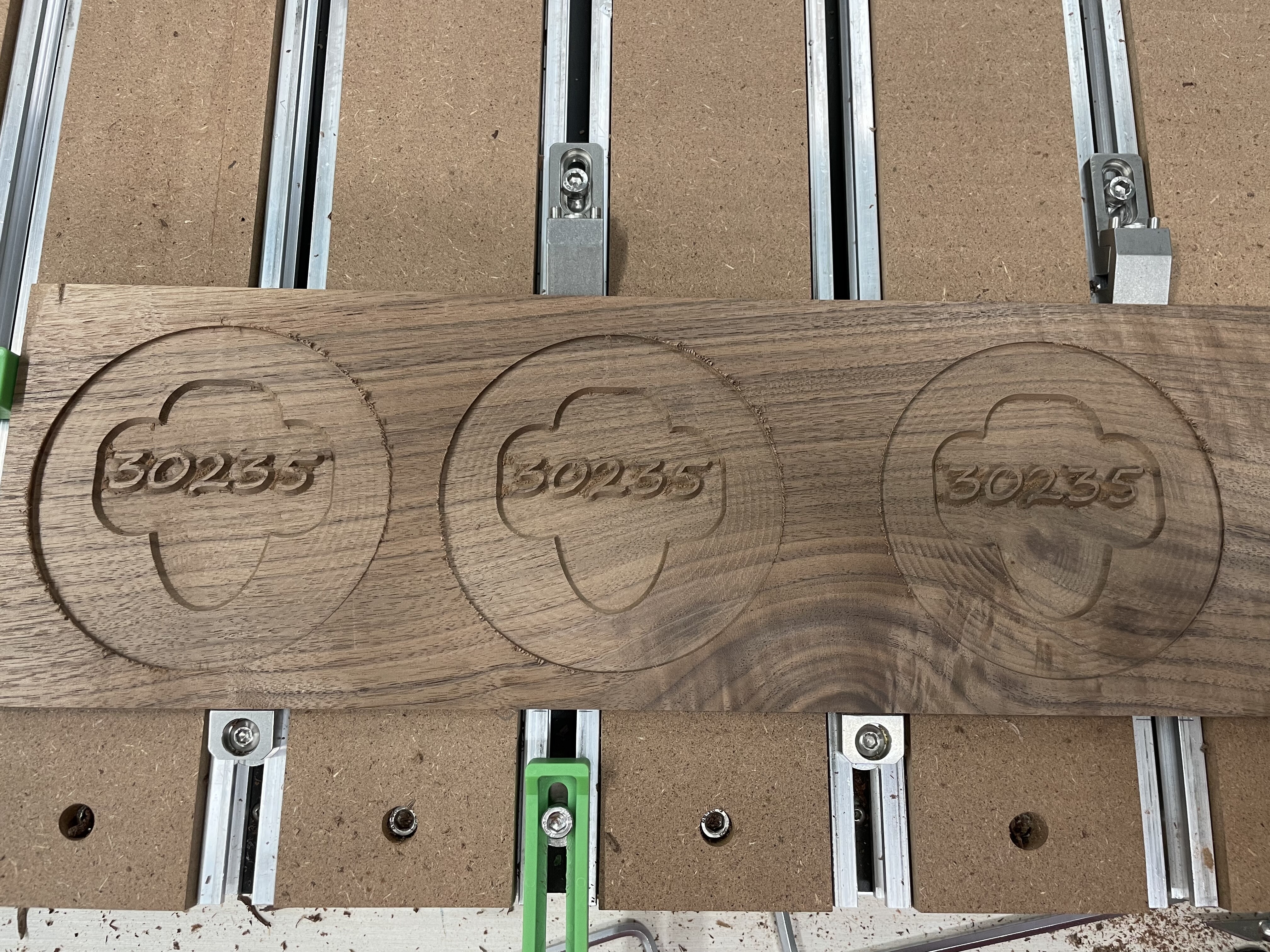

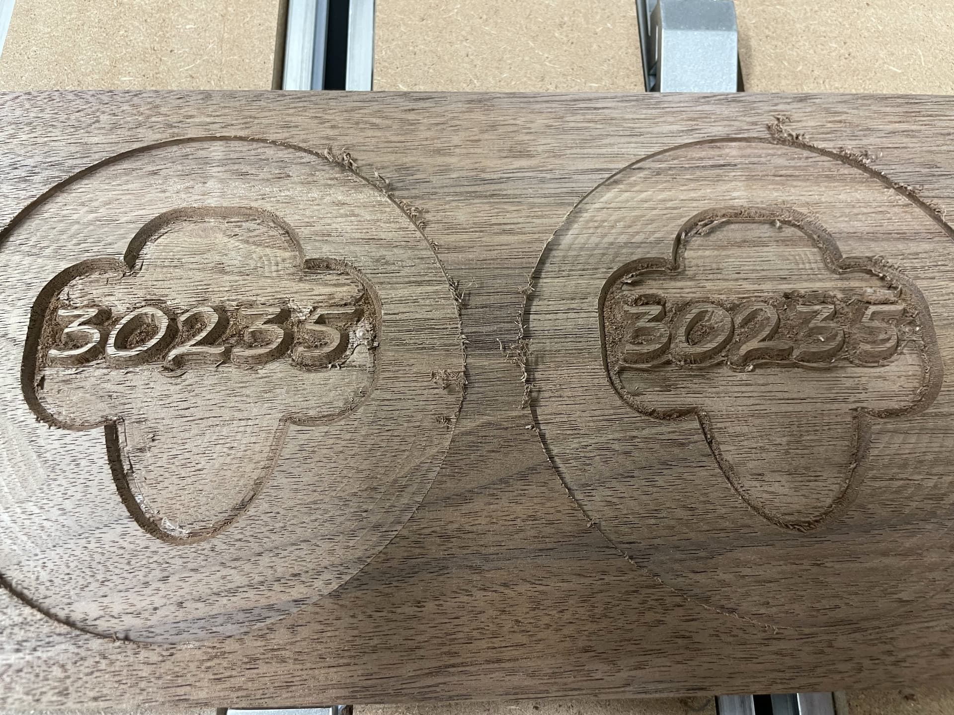

So, second set has the issue I will clean up manually but the third set looks nice right off the tool.
