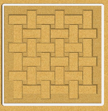

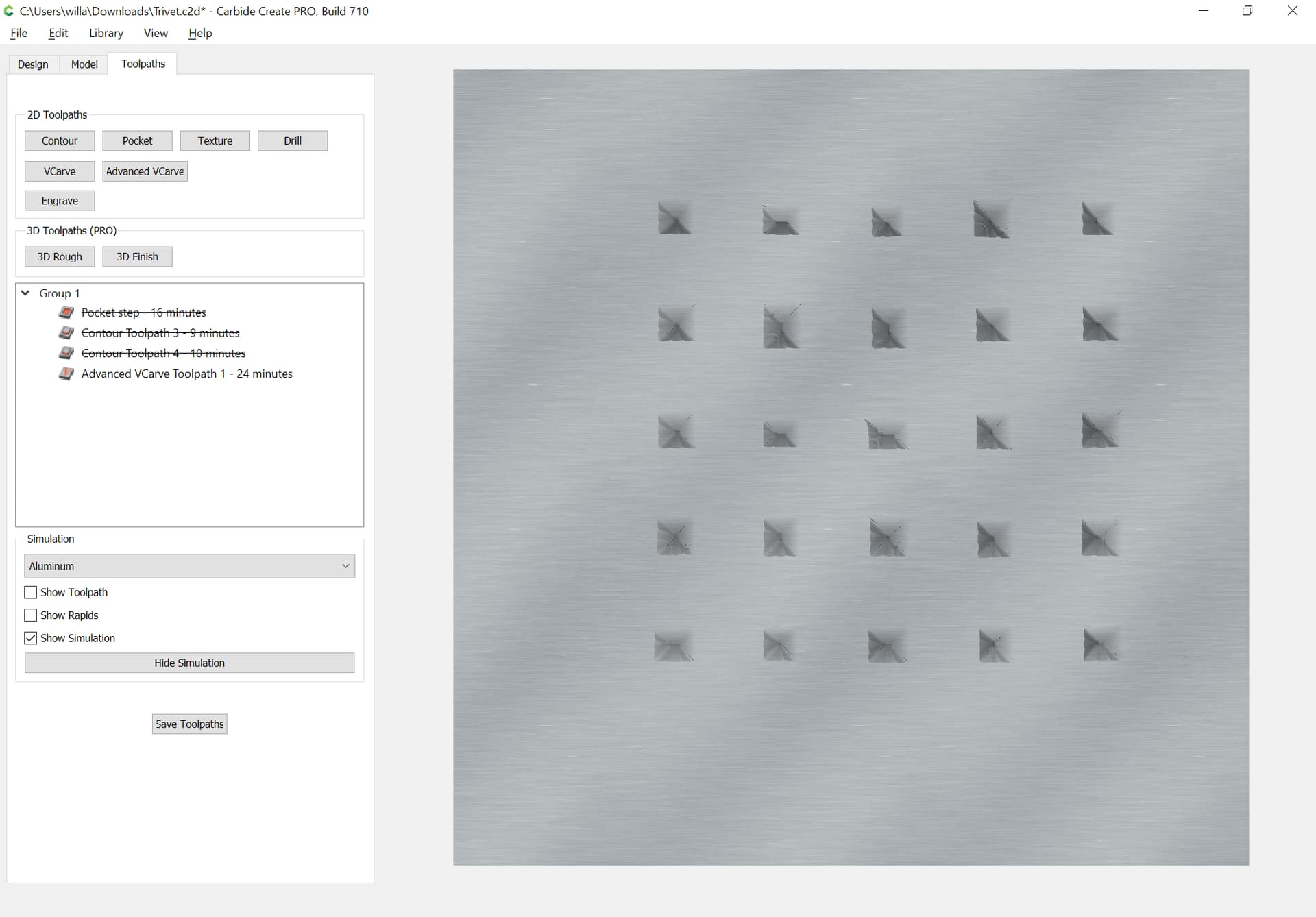

I disabled your tool paths and created a new group. I took a 1" x 2" block and created your pattern. Then I selected all the 1X2 blocks and created a contour toolpath with #302 no offset. Then I created a box around the blocks and picked everything and did an advanced vcarve with #102 and #302. You can try a bigger bit to save time but I was just trying to demonstrate what was possible. Then I selected the box and applied a Contour from top to bottom of material for cutout. I did not put any tabs in because I use painters tape and super glue. If you need tabs add them.
You will need to re scale your blocks to fit on your original size but the simulation looks good.
I created this in Carbide Create v7 (710). If you are still on V6 you can recreate what I have done.
trivet_simulation_mdf
Trivet_Version2_gld_v7.c2d (160 KB)

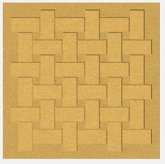

If that’s the look you’re going for, you want a gap between each of the rectangles.
If you try to V-Carve between them, and then contour the lines where they meet, the 2 paths won’t line up. Why not just offset them all inward 0.050, then select the border, all the rectangles, and V-Carve the whole thing. Nothing overlaps or touches, so the software doesn’t get confused, and you end up with a really nice carve 0.100 deep, and 0.050 - 0.060 deep on the gaps.
Trivet_Tod.c2d (88 KB)
that’s what I did but in one area it just started chewing up some of the blocks and trying to vee carve over the squares. So I was confused by why it was doing that.
