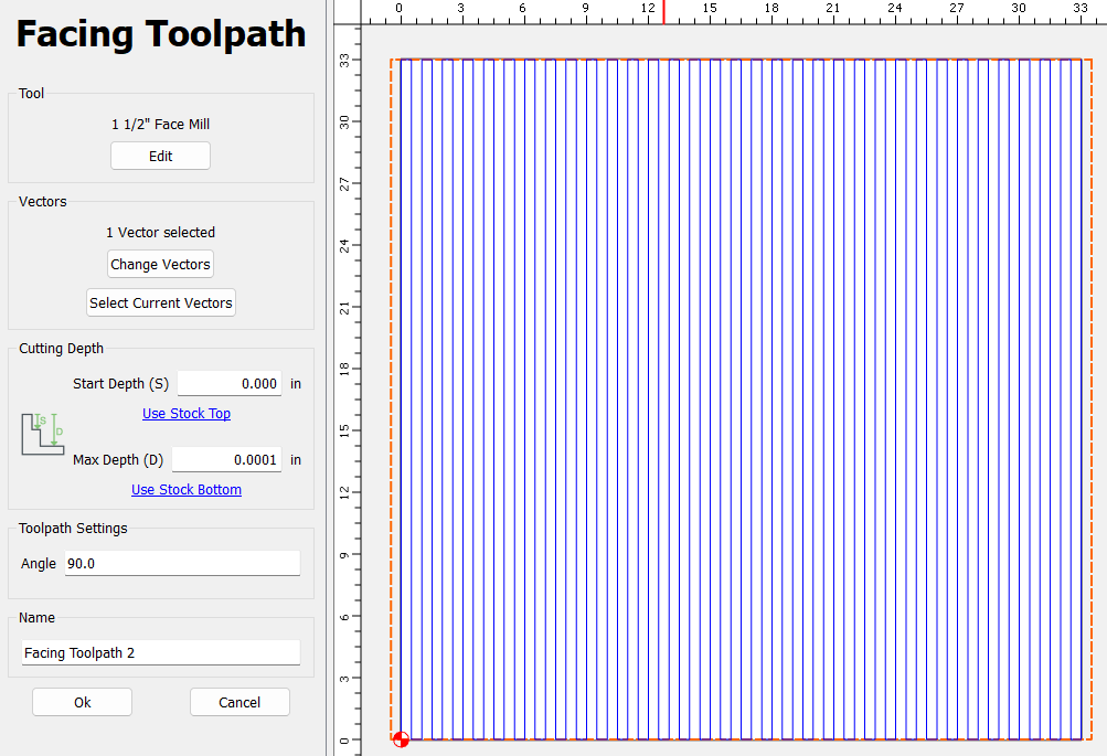

I tried to use his program it wont work.
Guess I will need to build my own program. not sure how to do that. this is my first time to clean up my waste board.
You are right 33x33 tank you for all your help.
I would check center and four corners at a minimum to see where your high point is. Mine happened to be center.
I would just draw a 33x33 square & cut it with a facing toolpath.
I noticed the passes stopped short of the left & right boundary, so I made the rectangle 34x33
You can also just draw whatever path you want and use a contour path with no offset.
I also set the depth to 0.0001". I really want 0.0000, but it won’t generate. Also if you have to edit it, it rounds the depth back to 0.000 and won’t generate. You have to keep adding the 1 ten thousandth back in.
On the machine, find your high spot & low spot. Touch off to the low spot and set your Z for whatever stock you want to remove. i.e. I would type in Z 0.010 so it cuts 0.010 below that point.

I just touch the tool off at the center & 4 corners.
Use the rapid positions for NW NE SW SE & Center. Jog down as close as you can get and then nudge it, reducing the jog setting as you get close, until it just touches the surface. When you’re really close, in the 0.001" jog, look under the cutting edge & jog down until the light disappears. If you need more light, put a light behind the tool.
If I’m trying to find the low spot, set Z zero on the first measurement, and then any measurement that is negative, or lower than the previous low.
Then I set the low spot to 0.010" & run the program I set at a depth of 0.0001"
Typically, you won’t be taking much off at a time. 0.010" - 0.020". So you can feed pretty fast. My machine maxes out at about 210 ipm, which is less than 10 minutes to surface the whole thing.
