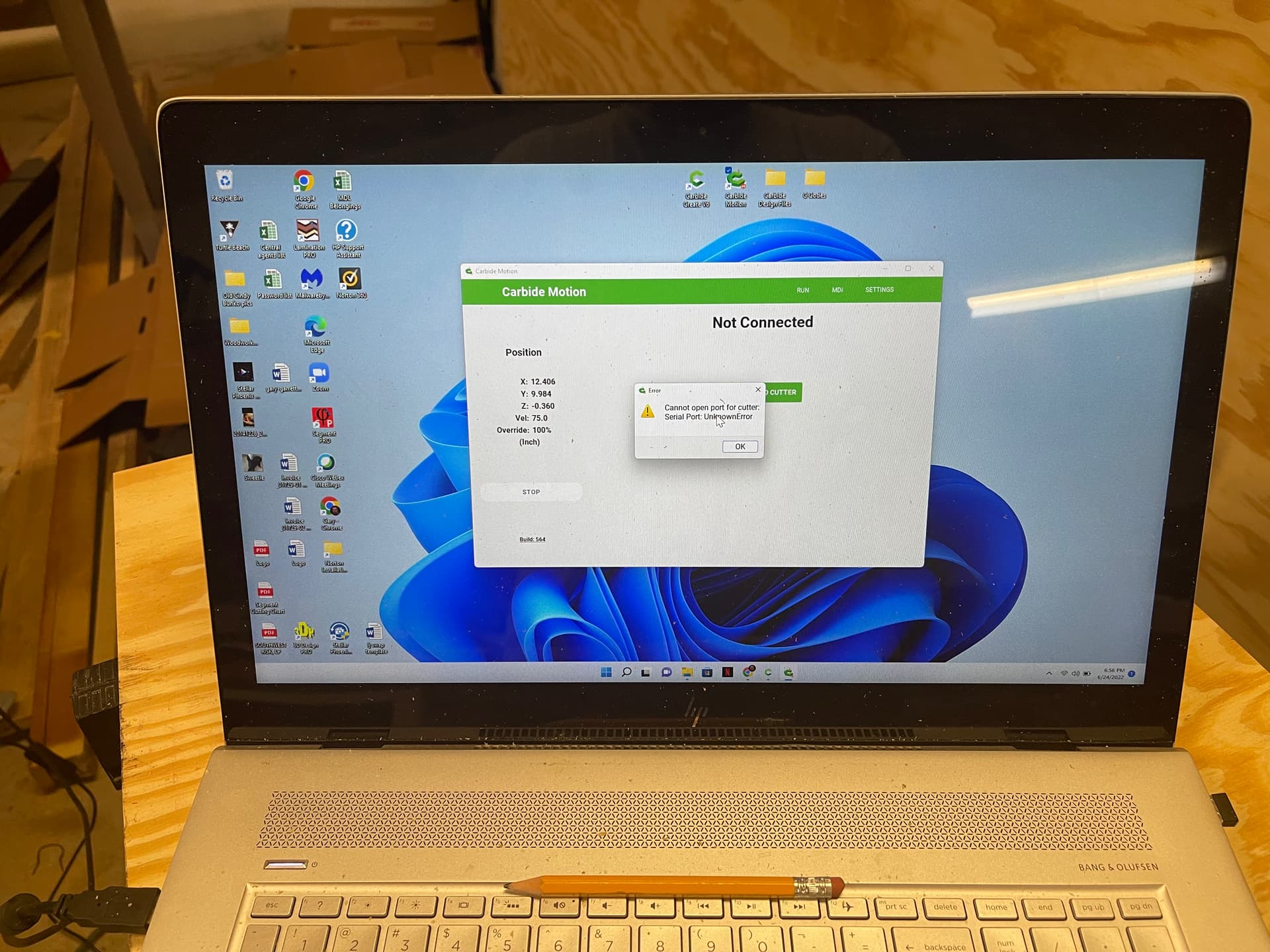

Well it just stopped
Running the file and I got this…
What the heck…

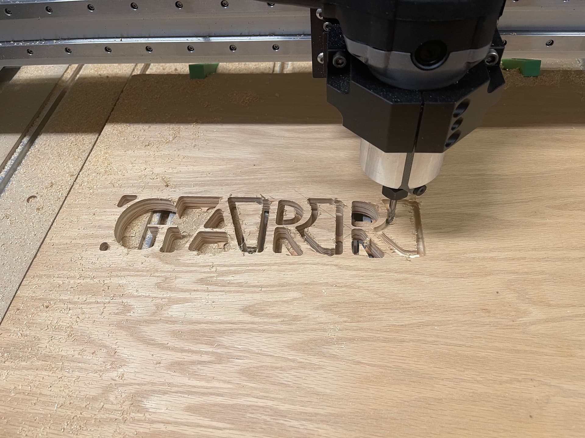

Got this far into it…
Loss of connection, probably due to EMI.
Are you cutting slots which are just as narrow as the endmill? That makes cutting more difficult.
Add geometry and cut as a pocket down to tab depth or the penultimate pass — you should be able to just restart the cut w/ new toolpaths made from the same file.

Did it happen to stop while you where operating other equipment in you shop ?
I noticed mine failing occasionally when I turn the Router and Vacuum off while switching bits, it seemed quite random at the time, However while doing test air cuts, I could make the controller randomly disconnect while turning equipment on and off which defiantly points to EMI issues, I am still working on the right solution :frowning: I assume I need to find the right filter
Maybe that might help you narrow it down as to where to look.
