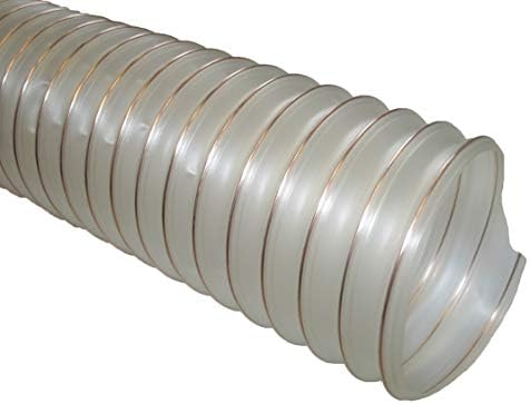

If you could do with a 2 1/2" hose, this one works well for me. It’s carbon impregnated and has the steel coil inside. I grounded the coil and haven’t had a disconnect since
This is what I’m using on this side of the pond;
It’s Polyurethane and the steel wire embedded in the hose makes a good contact point for grounding the hose.

And there’s the key thing, unless you actually ground the hose and the machine the semiconductive anti-static things don’t get the chance to work.
As a follow up: I bought the Makita 1-14" antistatic hose for about $60. Hooked it up and ran a bare copper ground wire taped to the hose every foot or so. So far seems great. Been able to turn vac on and off while cutting and no disconnect. Thanks for your input
