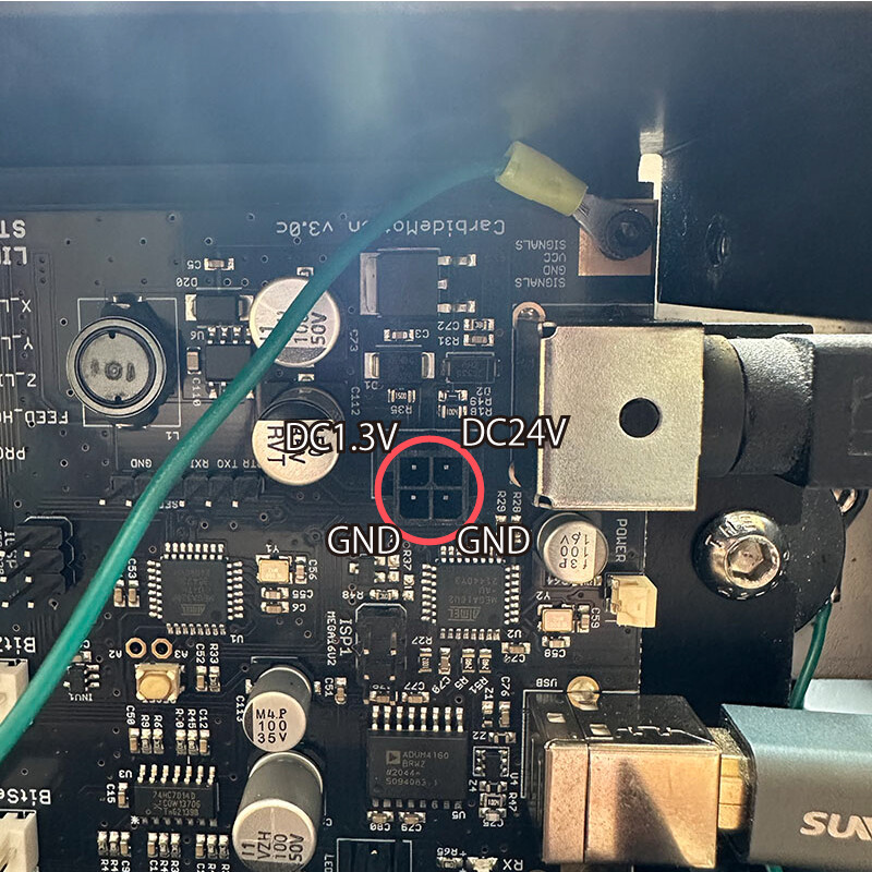

The outlet is approximately 99V AC, 60hz as measured.
The DC voltage from the adapter is as shown in the picture, i
s this normal?
I am measuring on the board because the connector on the adapter is a 4 pin with a shape that might short out when measuring.
On the board, we see 24V for motor drive, etc., and 5V for what appears to be digital I/O.
The Y homing switch terminal with the problem also looks normal, with two 24V and one GND, as do the other homing switches.
Currently the Y homing switch is in the way and initialization cannot be performed, so it is difficult to measure the voltage during operation, but I will inspect it in detail.

From my own knowledge I am aware that it is difficult to use with non c3d controllers and it seems best to continue using this board.
I had never heard of the possibility of homing switch deaths involving the surroundings, but it was a blind spot.
I will ask support for their response and proceed to diagnose the failure with an eye to power supply and homing switch failure.
