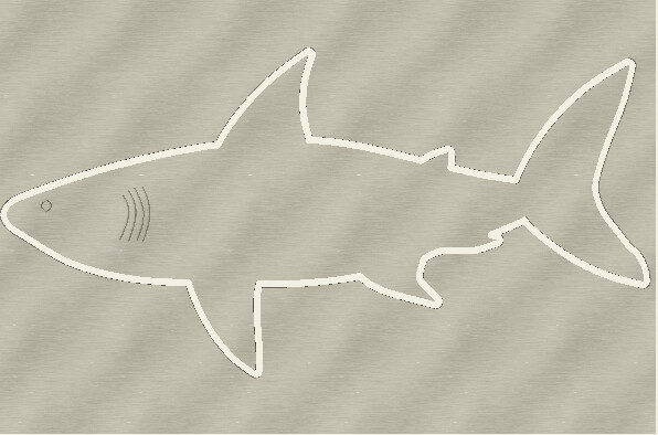

What is wrong with my V-Carve?
Why cant I V-carve the Gills? I want to carve the Gills to a certain depth, However when I try to with them grouped together it doesn’t work.
Shark-cuterie Kendall.c2d (96 KB)
V Carve works on Closed vectors - ones that enclose an area.
Since these are just lines, they are Open vectors. To carve them to a particular depth, you want to use the Contour toolpath instead. Use “No-Offset” to carve right along the line, and set to your desired depth.
