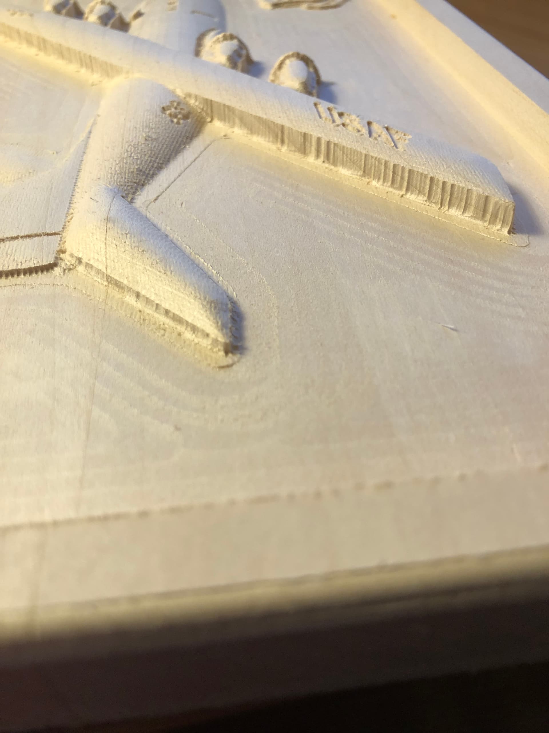

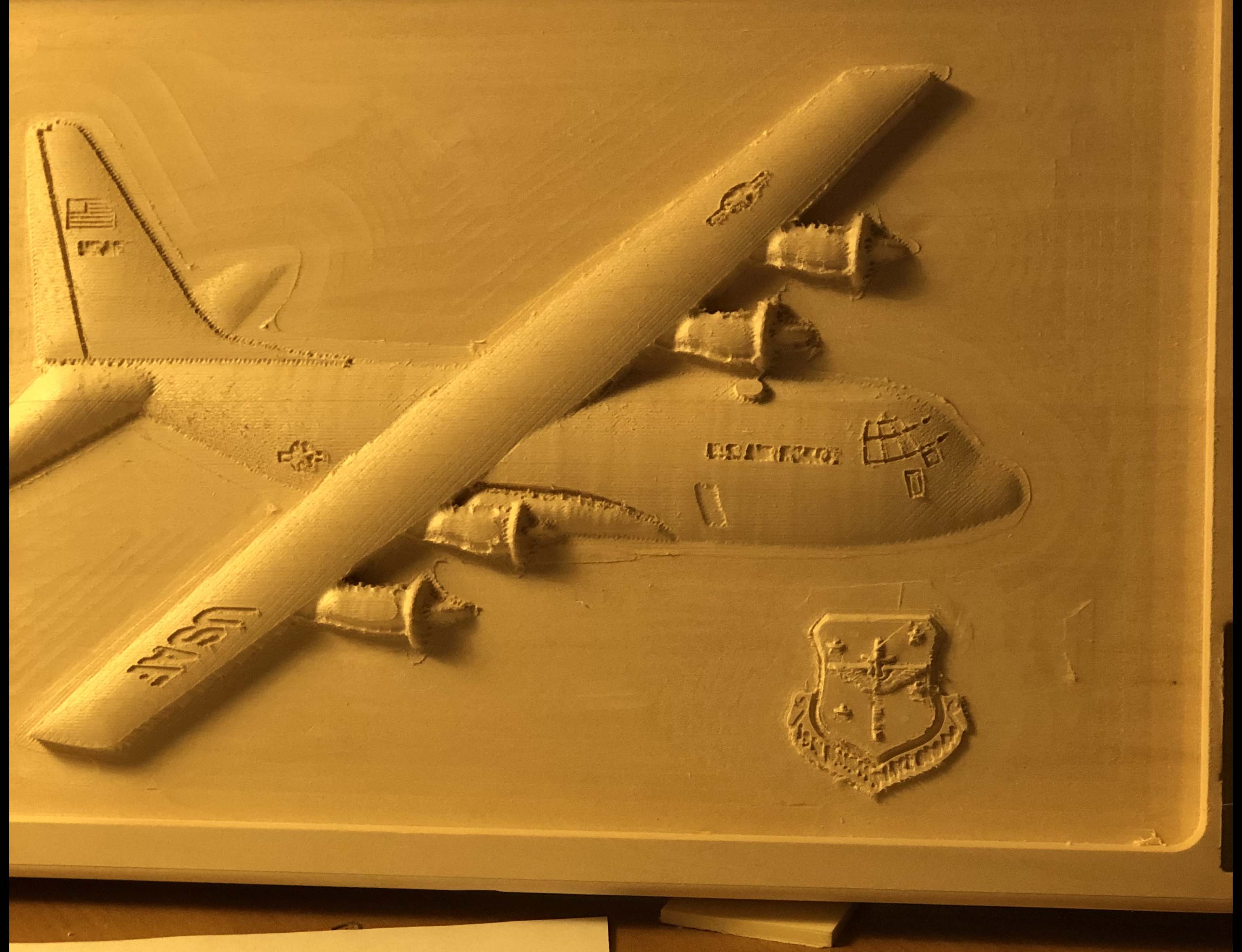

For about a month, I’ve been working on and off creating a plaque depicting a C-130J. Big USAF cargo plane. Today, I finally gave it a try on my Shapeoko Pro. I liked most of what I saw, but hit one annoying bug. Along the leading and trailing edges of the wing, there are a cut marks which I’d like to eliminate. To lesser degree, they also appear around the til section.
Here’s a shot of the entire plaque.
And here’s a close shot of the trailing edge of the wing.

I turned off all of the non-wing model components, created a closed vector that was about a 1/4" larger than the wing and ran both the Prep 2 - BIT SETTER ON and the CARVE Airplane Only steps, watching what they did.
Eventually, watching the fourth 3D Finish perform, I found the culprit to the strange cuts on the trailing edge of the wing. I had approximated the angle of the wing as 105° which is the angle I used for that toolpath. Most of the passes stopped at the top of the trailing edge. About every 7th step or so the cutter would dip down the full thickness of the trailing edge, notching them. I’m simply going to try eliminating that pass entirely. If I find a point where I really need the 1/16" cutter, I’ll focus of that element by itself, as I’ve done with the flag, USAF, and logos.
