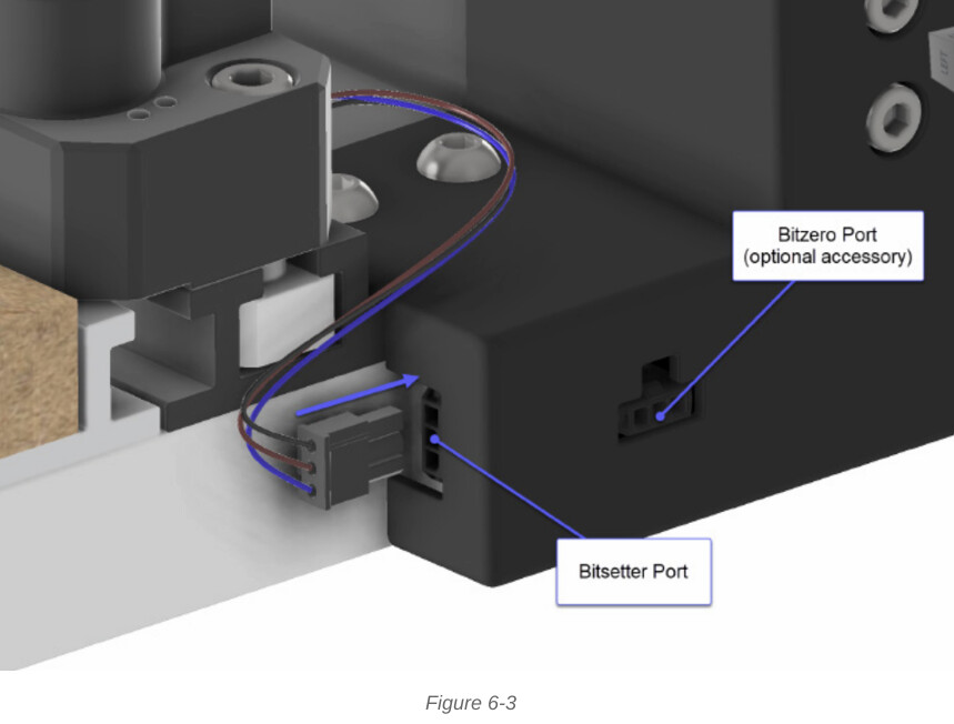

I’ve recently purchased the BitZero and searched everywhere for any documental or video of the location to connect the BitZero and have not such luck. Could someone please help?
Which machine do you have?
If an SO5 Pro, the manual:
has a page with the figure:
(search for “BitSetter” since “BitZero” is part of the pixel image)
@DCW On my 4S and 4XL the bit Zero connection is inside the control box on the upper right side of the control board. It’s labelled so you can’t miss it.
