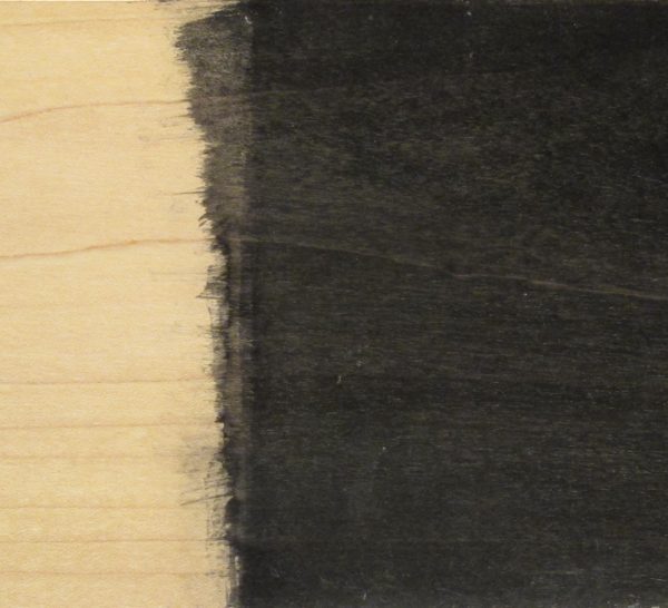

Which wood will stain deep black well?

One of the old timer offerings as t use india ink. This is super black , nano-pigmented and allows the grain to show somewhat, but the results are stark black. Finish with clear lacquer and use rotten stone (or 2000 grit paste such as Maquires polishing compound , autorsupply) with water between coats of lacquer for a mirror like result.
Here’s a good article on the subject, with dye recommendations:
The key for him was to get powdered dye and mix in a very high concentration. Then, be careful with water base and lacquer base for topcoats.
The balance here is that you want an uneven adsorption of the dye - otherwise you might as well use a thin paint. Real ebony has streaks of brown and even tan in it. And, you probably want to avoid any streaks created by uneven application of stain, as that always look artificial.
The problem with using woods like poplar is that they’re not dense enough to really mimic ebony, which has a very tight grain and polishes well with just a light oil finish. That said, the less dense woods will adsorb more stain and so can get darker. Another thought is to try a darker wood to being with. Walnut is an obvious choice, but that’s not as dense as ebony, however, getting more exotic (eg Padauk or Bolivian Rosewood) gets more expensive.
Old wood workers trick is to use India ink and the top coat with 2# shellac, the lacquer if desired. Rxman
