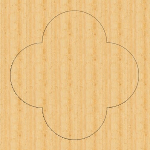

I am not sure how ask. When I select five overlapping circles to be cut, Create cuts a flower shape around the outside. I have to select and cut each circle independently if I want to show the circles overlapping. Is that correct or am I doing something stupid?
Upload the file you are working on?
I just tried to replicate what you are doing. My only guess is that you selected all the vectors and then you selected an outside contour cut.
You need to select “No Offset”

Thank you. That’s actually an interesting bit of information. What I was working on this below and I got the stimulation to work. Understanding the vectors inside/outside/no offset really helps.
