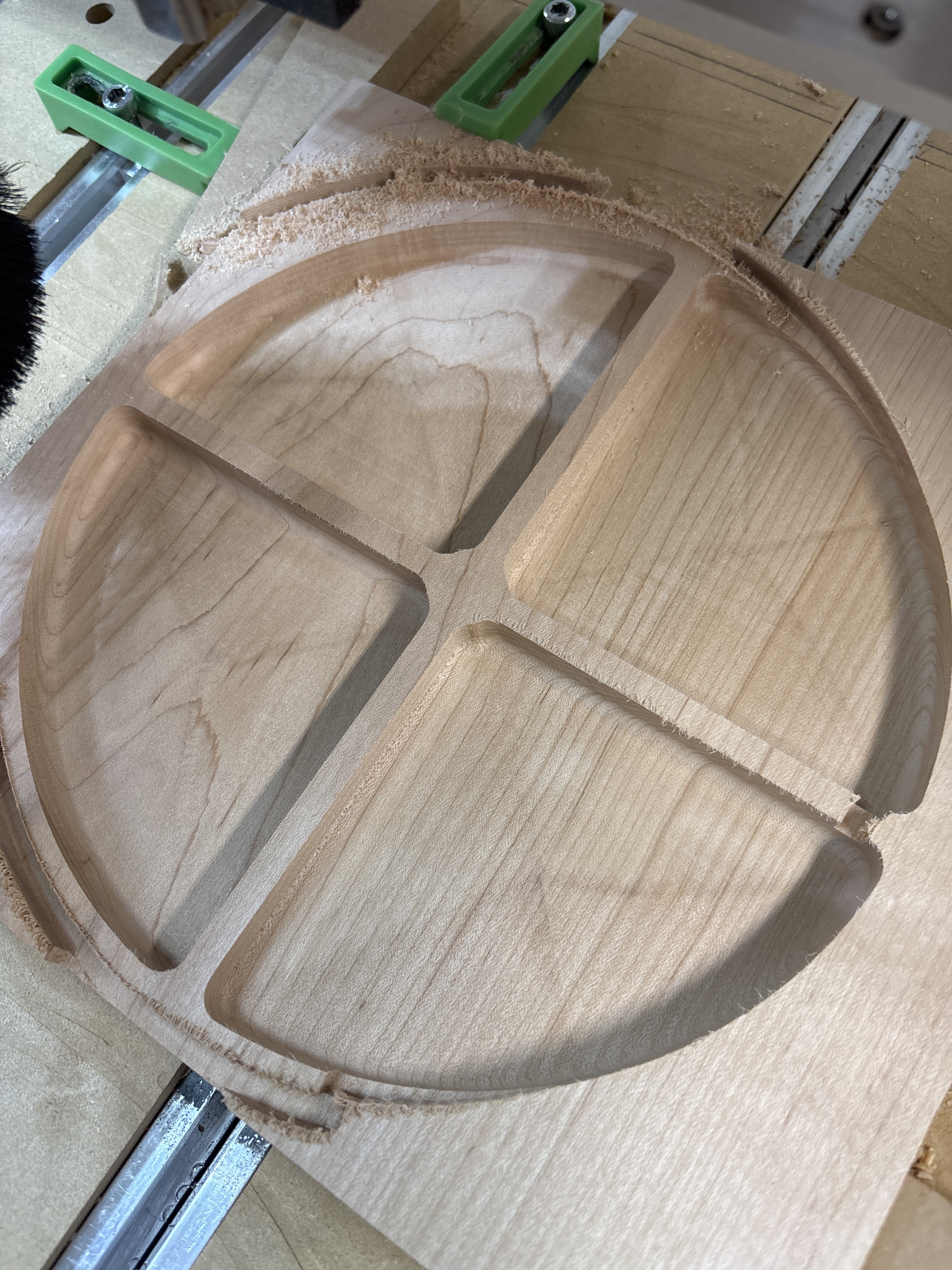

Several times recently I will be doing a final perimeter cut and the machine suddenly veers to the left ruining the project . Photo attached. Can someone clue me in on what may be causing this

I just found 4 loose screws on the Z axis rails. Would that be enough to make the machine veer to the left??? What are your thoughts on this?
I would think so. Maybe time to check all fasteners to be sure.
Of course, any advice other than checking the machine assumes that the machine is assembled correctly:
and clean and well-maintained:
