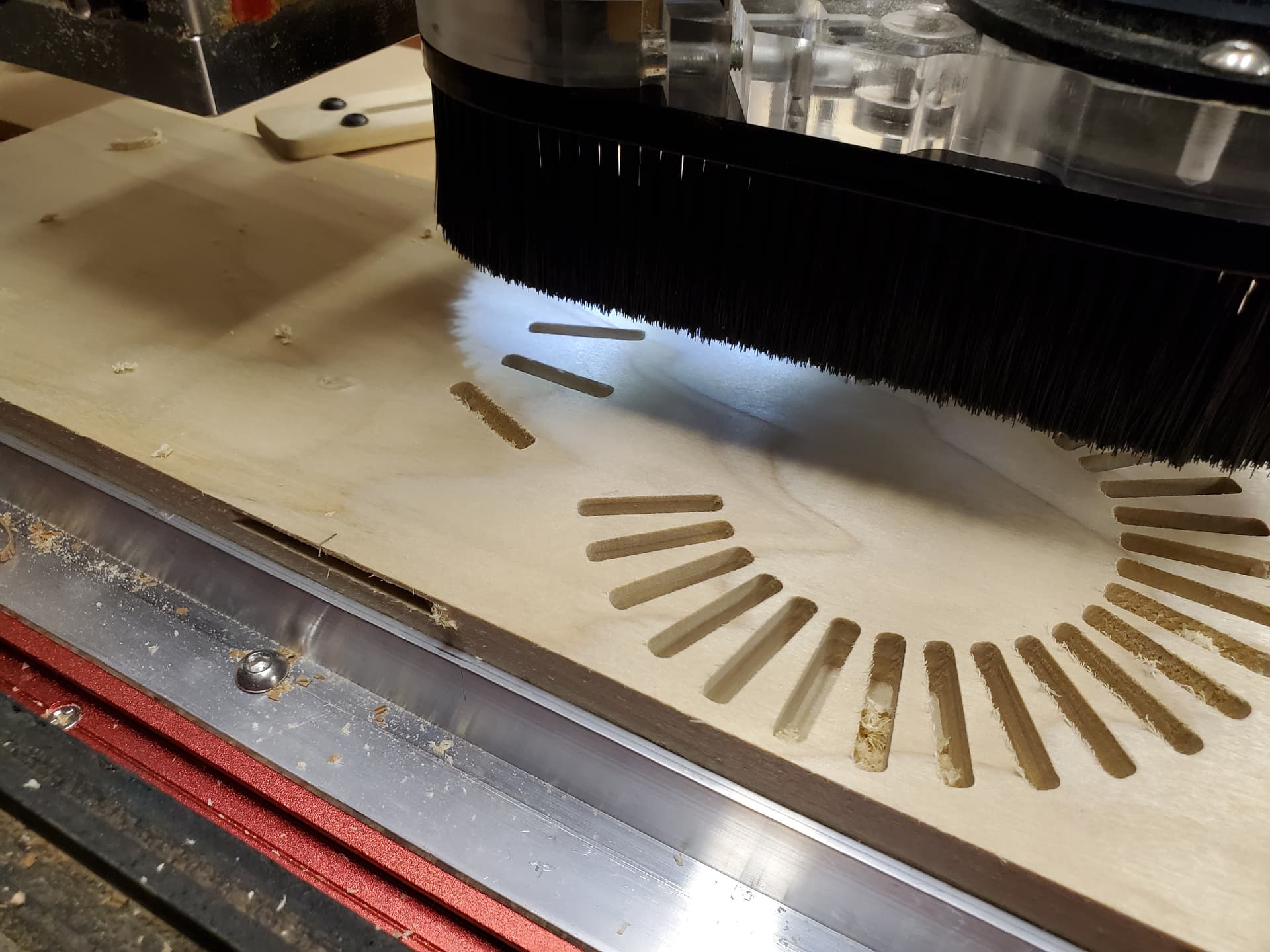

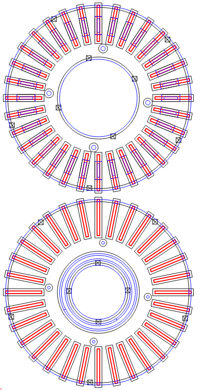

I have noticed that CC is very inefficient at choosing its order of cuts within a toolpath. In the attached image you will see all the red pocket slots that I was cutting in one toolpath. Why doesn’t CC do one slot and then go to the one right next to it and so on? Instead it will randomly jump around to different slots wasting time. Is there not a way to program it to be more efficient like other programs do? Or is there something I can do in my designing process?
Sample of my cut file
Example of how it randomly picks where to go next
Thanks
It’s a known issue. The cut ordering in CC is just awful, see this post for example:
It’s hard to tell just from the results, but it appears that the cut order is essentially based on some internal order that is unrelated to cutting - some kind of dependency on both Y order and winding number. There doesn’t appear to be any optimization applied to cut ordering, not even something simple like the greedy algorithm.
The only “workaround” is manual ordering - toolpaths are run in the order you specify them.

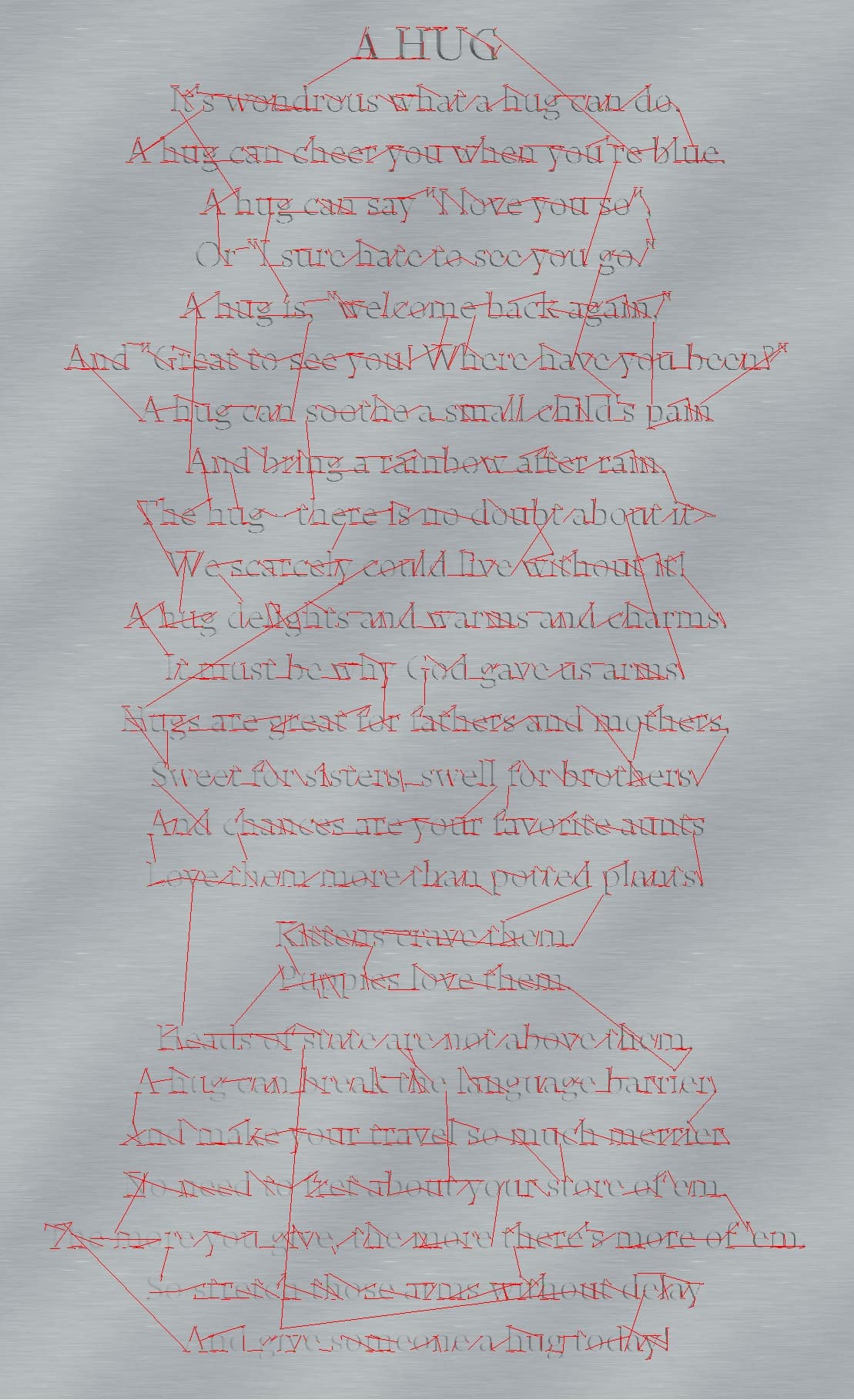

Creating a sign for a friend with multiple rows of text, I noticed my Shapeoko Pro would sometimes write a letter or two of a word, zip across the wood to write two letters on a different line, then come back and finish the incomplete word.
Hug Poem Medium.c2d (3.7 MB)
It is the algorithm. C3D does a decent job of it. Even very expensive commercial programs have difficulty with that.
I think Will Adams calls the condition Traveling Salesman. CC has improved over years. This is a good reason to set your retract as low as practical so rapids take less time.
