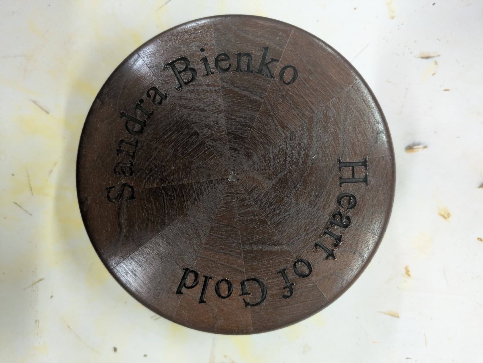

Engraving on round objects is best in the center because there is no lower right edge.

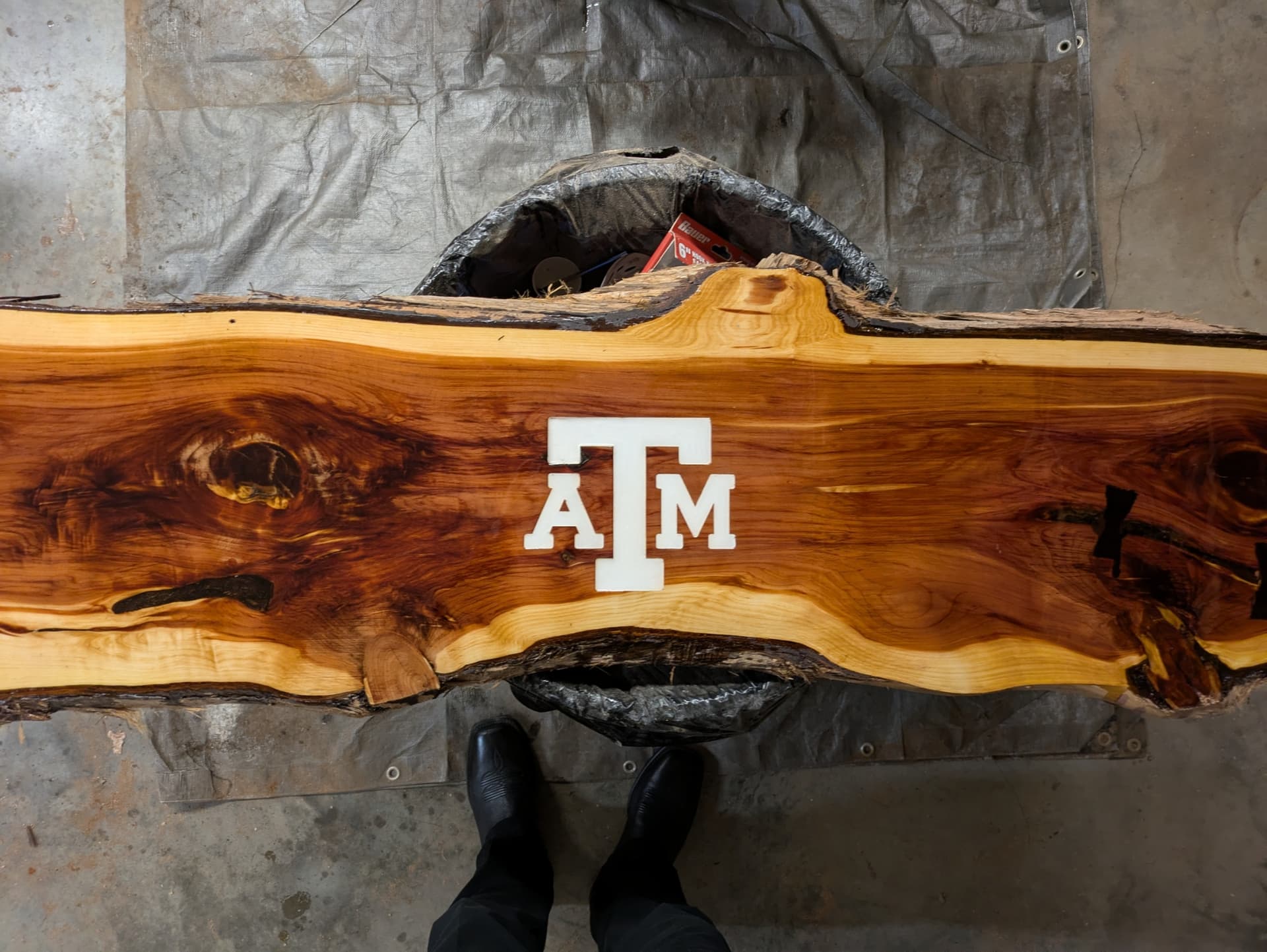

Here is a bench back that only the end edges were straight with natural slab edges so I figured where I wanted the carving centered and set that as my center. In CC I drew it as a rectangle just big enough for the 6.5" high text and used center.
