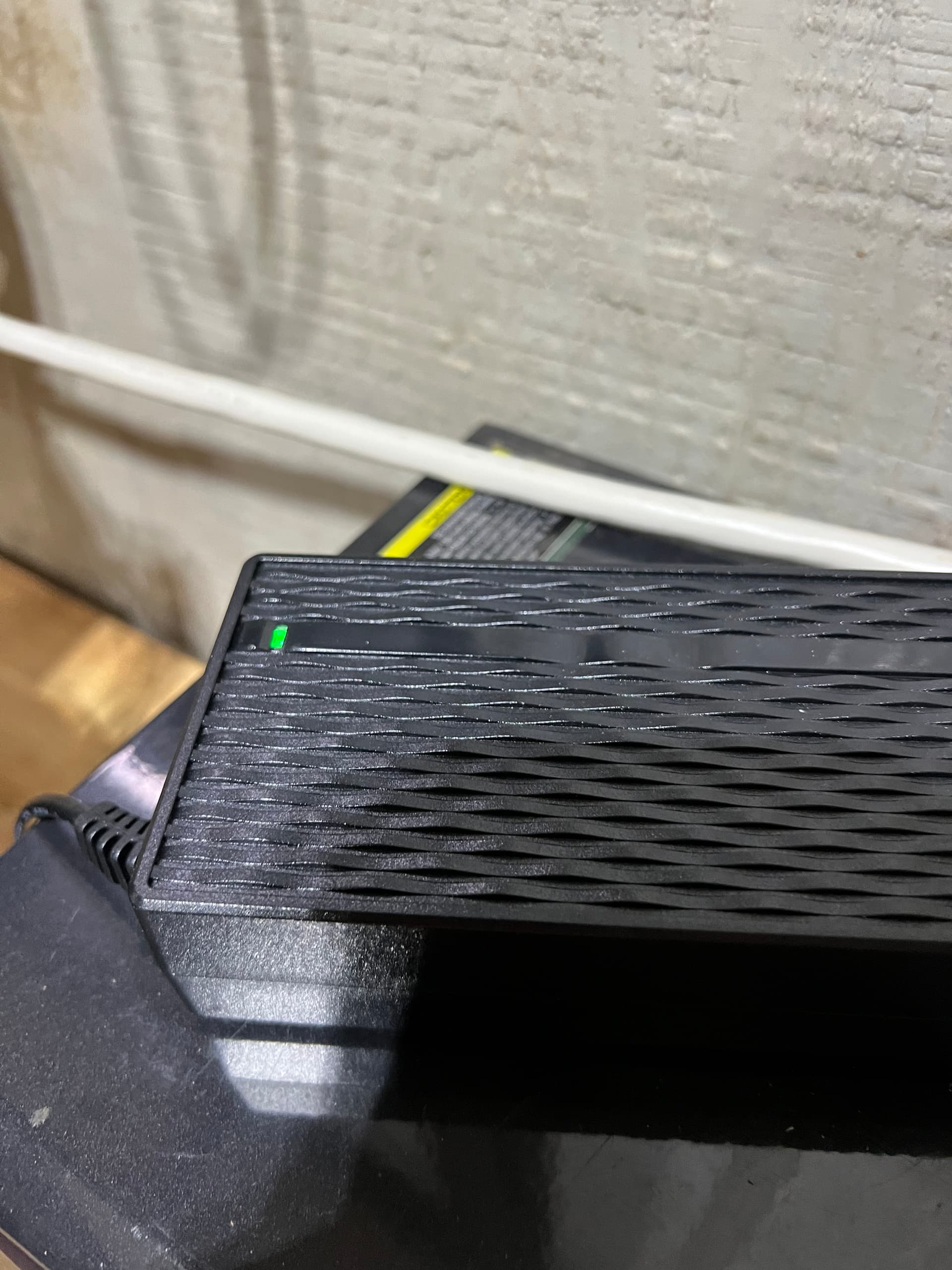

I just got fine setting up my xxl 4. And turned it off and went back to my office to play around with create. And went back out to my shop and the cnc won’t power back on. No lights or anything. What happen? And one have any ideas.

just got dune setting up my shapeoko 4 xxl. And decided do shut it down by useing the power button. And go use my laptop to try to make my fist test peace to cut. When I went back outside to my shop there no more blue light around the switch and no light in the control box. I tryed unplugging the power brick and plugging back in. And it still has power. The blue light is still on. On the power brick. Idk what happen I am at a loss. I don’t understand what I did wrong. Plz help!

I haven’t see any I’ll have to check again in the morning. But as of right now I have a $2800 paper weight. Good times
