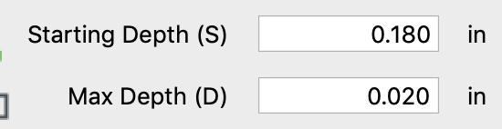

Looking at your file, it seems like you have a typo
You typed .020
That’s also not a lot of space for glue. You didn’t say what type of material it is, but I’d increase that.
You also are starting really deep at .18 targeting a .20 female.

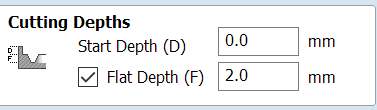

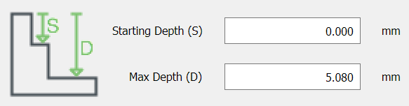

The start and cut depths are per-se irrelevant. What you are aiming to achieve is a perfect fit ‘at the mating plane’. The plug’s mating plane has to be artificially shifted to give clearance above once mated, to allow for tolerances and cutting away the remnant of the plug. There are several good articles on this forum (@julien and others) and on the Vectrics website video tutorials that explain what is needed and why.
Carbide Create: image
“Vectrics” software: image
You mention a “flat depth” which is a Vectric setting and seem to be saying you are applying it to Carbide Create, which is a little confusing.
From the icons: vectricD=ccS whereas ccD=vectricD+vectricF. Maybe :slight_smile:
