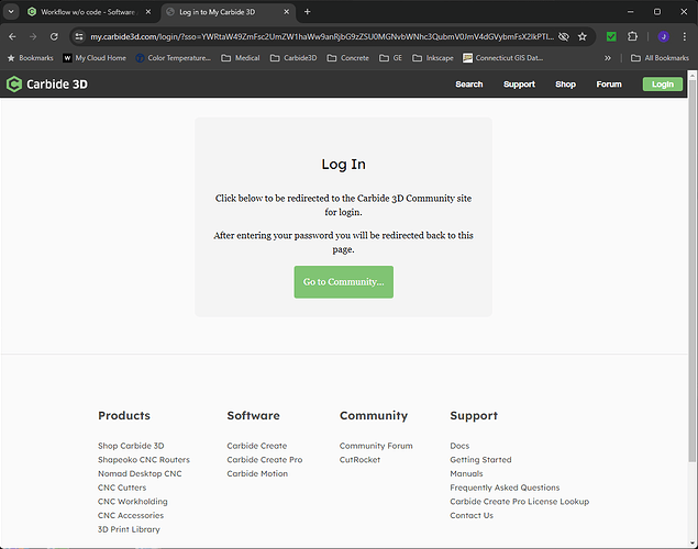

I go to my.carbide3d.com. Select the login button, which brings me to this.
The go to Community button does not do anything.
I am already logged in the Community.
I just tried logging in through the “Shopping” button, navigated to the community and retried the link.
I always end up the the page above using the link.

This requires that your account, in addition to being logged in is also a member of the “Owners” group — this only happens automatically when you purchase a machine using the same e-mail address as is used for the Community Login.
Ok. I remember some disconnect in that area.
I will email support to get it straightened out.
Thanks !

Rob found and fixed an issue in the website.
All good now.
