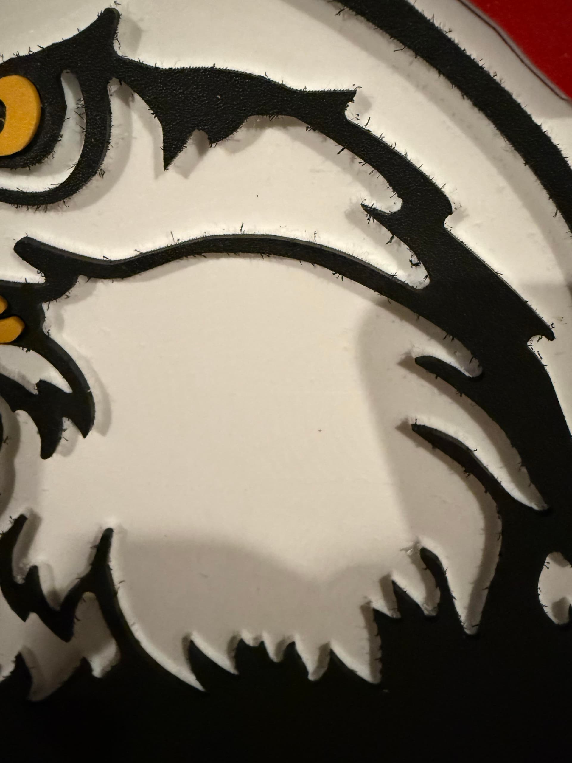

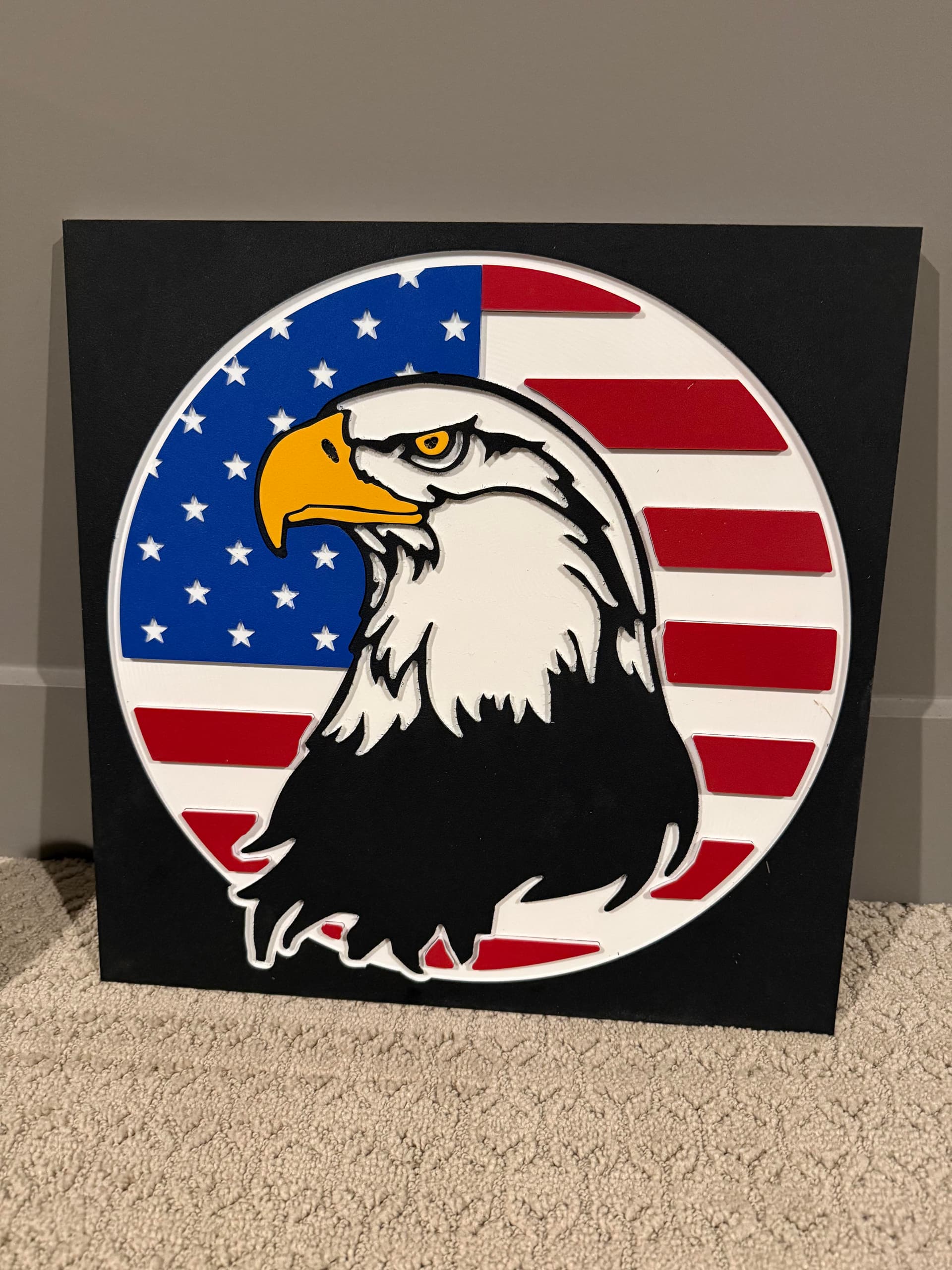

I bought this eagle kit from CIC Workshop, which is made out of ColorCore HDPE Plastic. I’ve had mixed results. If you’ll notice, the close-up photo has a lot of “fuzzies.” The bit was new. I’ve tried cleaning up with a toothbrush and wire brush, but this is about as good as I can get it. Does anyone have any tips or tricks when working with HDPE?

The most obvious solution would be to use a downcut bit.
I definitely recommend these bits from Cadence Manufacturing & Design.
Further to that, I would pick an “O-flute” type bit and work on your speeds and feeds; wood and plastic are really different.
When I cut polypropylene I always used slow feeds and speed. In my case the router was on the lowest speed and feed was set to 20 and while I was cutting I watched for any signs of melting and or fuzziness and reduces the feed by 10% until it was a smooth cut. You can also do a final pass and remove .005 and really slow this final cut down and have the option to increase the feeds if it is cutting smooth. I used a 1/8 down cut bit and have had good results.
I haven’t tried this yet, but try using a small hobby hand held torch on a spare or waste cut and see if the heat will do anything to the fuzzies it may embed the color fuzzies in the white sections and do no good but it is an idea to try.
Anthony

Usually, just wiping off vigorously w/ a micro-fiber cloth removes all those.
I use a cheap deburring tool to clean a lot of my hdpe edges.
You can also use a torch in really small passes. Too much heat will bend the plastic and you’ll change the shine on the plastic. Quick passes can melt the fuzz great but I’d recommend practicing on a scrap first.
Thank you for the reply! I actually was using an 1/8" downcut end mill. Additionally, the bit was new.

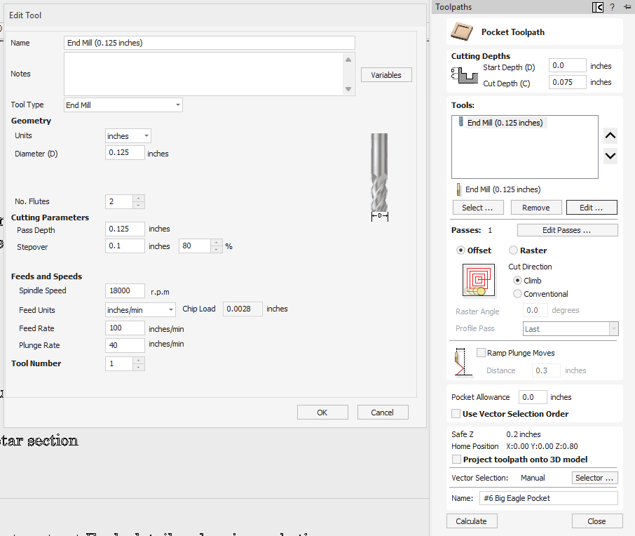

Interesting … I was running at 18,000 with a feed rate of 100 for the 1/8" end mill.

So far, I have exclusively been cutting signs out of ColorCore material and am not getting edges like that. I am using a 1/8" spiral up-cut bit from Amana Tool, part #51411-K. It makes tons of little chips, but the edges are reasonably clean. I picked up the sign making at my job from a volunteer and have just been using the settings he had been using, so I am not sure what kind of trial and error woes he had.
What speeds and feeds do you use and does it make an acceptable pocket surface. In my experience any central color other than white ended up with a chalky appearance with the O-Flute bits and if the speed was too high. It would look great when wet but when dry it looked chalky.
I could not find any way to actually clean those surfaces up.
I use the #102 at 8000 RPM and am happy with the surface but it does leave the fuzzies.
Roy,
Okay I give up. How did you stick the layers together? HDPE doesn’t like glue. I’m kinda baffled.
Kevin
Hey Kevin,
I use this:
Loctite Super Glue Plastic Pen
It works pretty well, I have found.
Roy
