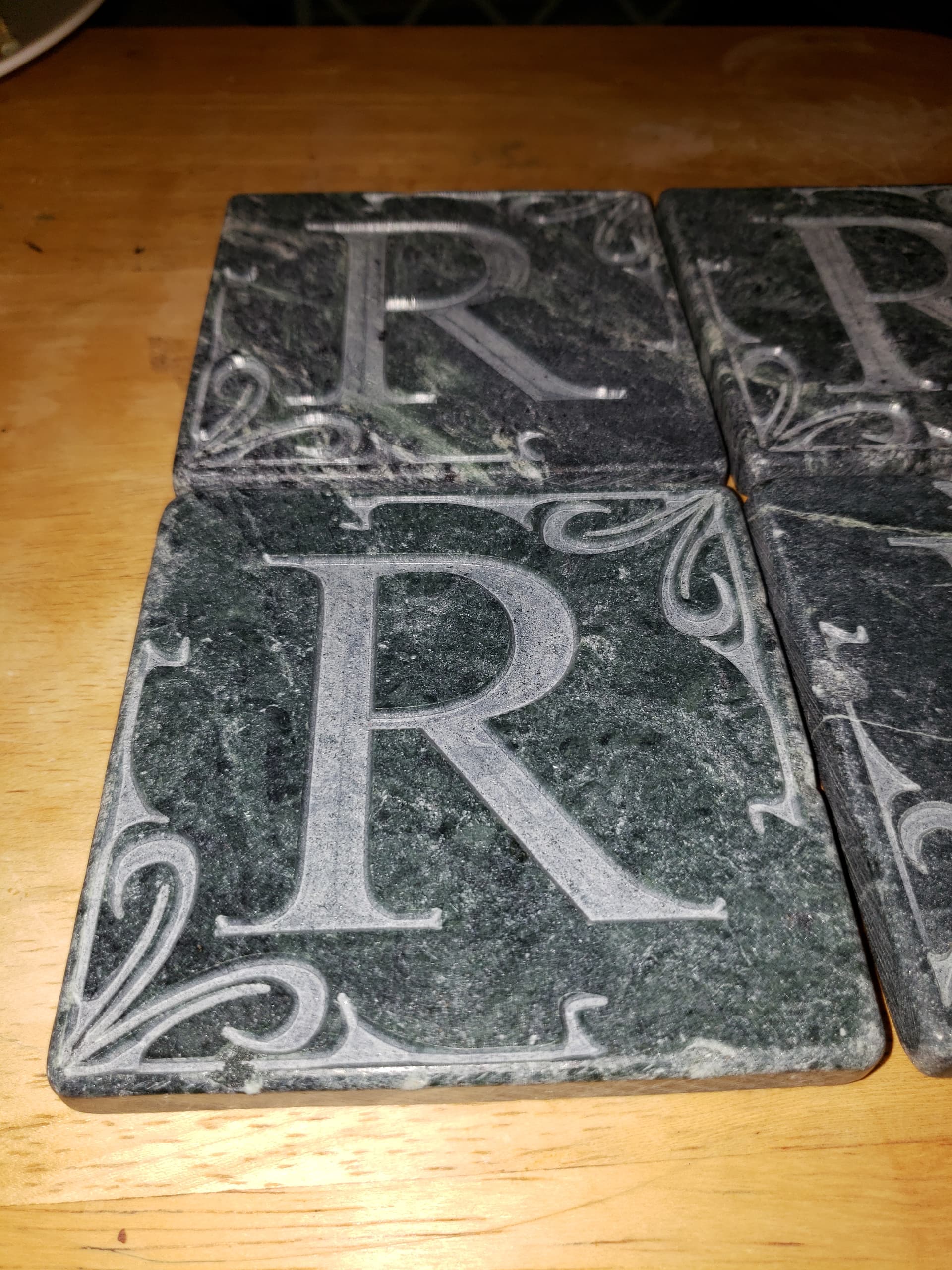

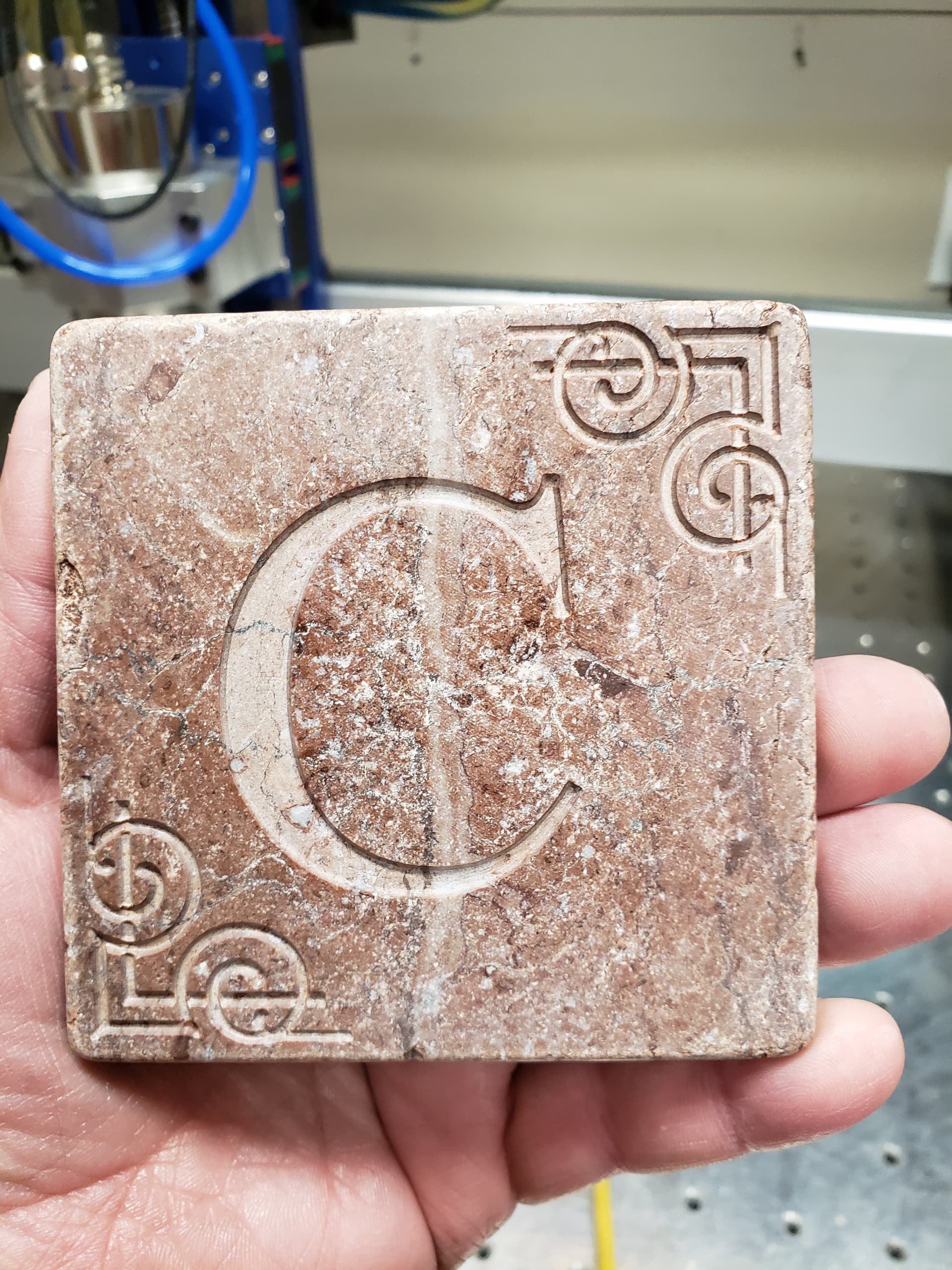

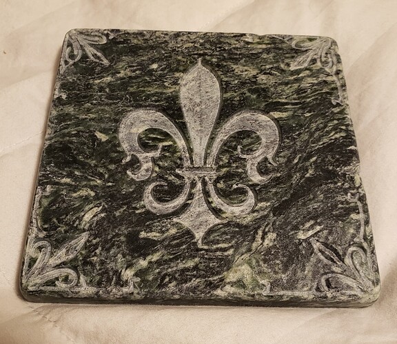

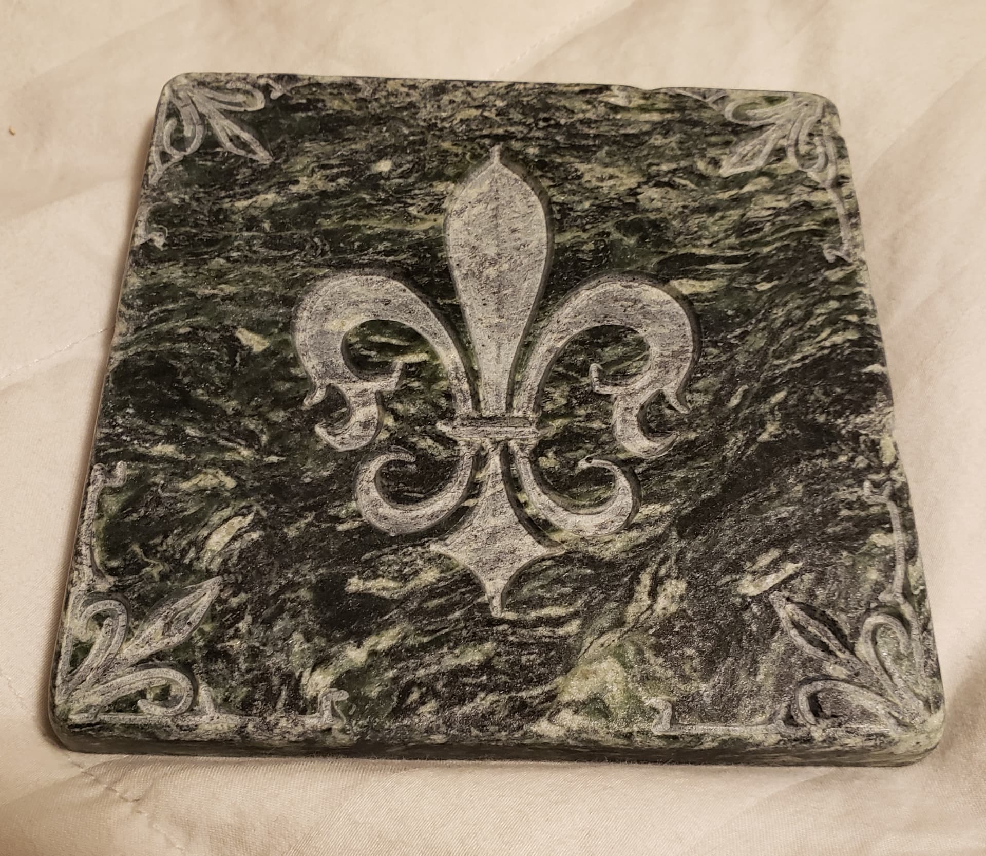

I used PCD V-bits to carve 4" x 4" marble tiles for customized coasters.
Thank you. What were your speeds?
Links to the tooling would be appreciated as well :pray:
I’m gearing up to do some stone milling myself.
15 IPM plunge
20 IPM cut
0.04" DOC
10K RPM, maybe 12K?
