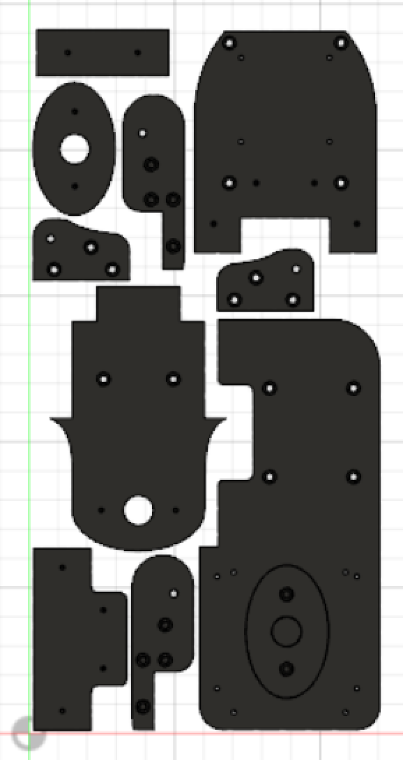

I seem to be at odds with how to proceed with 3/4" HDPE.
In order to cut to depth, I need to use a long cutter which introduces flex meaning I have to slow my feed rate. However if I go too slow on feed rate, the material will melt. This creates an interesting issue when I’m having to use 1/8" mills.
I guess what I’m really trying to decide is if I just cut my parts out of 1/2" plywood or MDF and use those as router templates and just take everything to my router table with a template bit to cut the final products and then drill press all the various holes I need.
Thoughts?

Going to 1/4" bit would be ideal but I’d have to up size my stock which adds a noticeable amount to the materials cost with a lot of waste. I only have about 4.5mm between some of my parts now which is enough for the 1/8" bit but not enough for a 1/4" bit.
Not familiar with the term rest tool pathing. I’ll have to look that one up.
Of course that also means I can’t cut my drill holes. I can cut the pockets for the heads and maybe do a touch off to mark them for drill on the drill press but can’t go too deep since they’re 1/4-20 and 1/4" drill would be too big.
