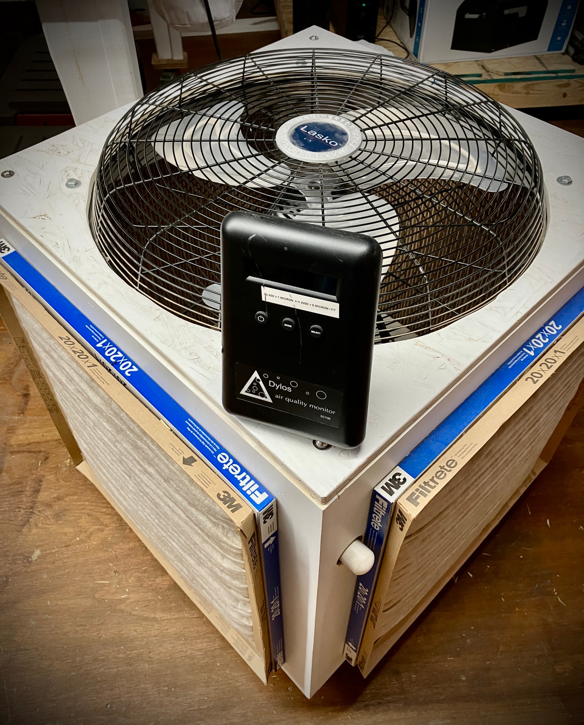

If you don’t measure the air quality, you just don’t know.
How many have this combo (in addition to a quality vac filter?) This runs any time that I’m making or moving dust. It gets measured air quality down to double digits in my 600 sq. ft. shop, if I want it to.
A second thumbs up on the Dylos monitor. It’s the really fine dust that’s dangerous, the stuff you can’t even see floating in a sunbeam coming in through a window. What the Dylos measures are larger particles as well as these invisible ones. Despite really good dust/chip collection, you will be amazed what your breathing.
