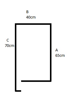

But I got a problem with dimensions. To simplify, my design was a rectangle of 70cm x 40cm.
But as a result, I got a shorter side of the rectangle, around 65cm instead of 70cm… The opposite side had the good size of 70cm, and so finally I got a shift…

You’re losing steps, almost certainly. Your feed rate is too high, and the steppers can’t do it.
You didn’t damage anything.
Were the slow downs while it was cutting or you moving the carriage by hand? If while it was cutting, that’s likely the steps being lost. If while moving the carriage by hand with the power off, that’s back emf powering up the boards, which powers the steppers, which causes them to stop, then power fades and they start moving again.

As Will mentionned a possible culprit is belt tensioning, and judging from the figure you draw I would say the Y belts should be checked first, make sure they are string-tight.

I did all checkings on v wheels, belts, but I saw the slow downs still happening even sometimes when the gantry was moving freely (I mean on movement without cutting).
And I finally found that connector of the right y-axis motor was not completely locked… I probably hade bad contacts sometimes then.
I’m not sure if I wrongly plugged it, or if some tension in the cable made it slightly pop out.
Anyway, now the movement is smooth, and I will get back on trying to cut acrylic.
