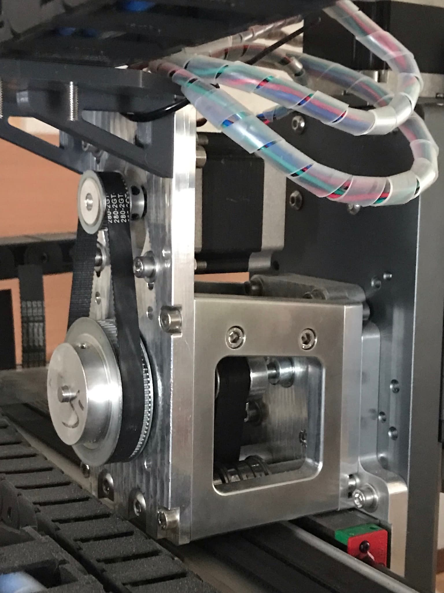

I switched my X axis to linear rails and dual 15mm 3MGT on larger pulleys.
The linear rails made a big difference, but nothing like the change that users of the small machines see.
I have not found the bigger belts to be really any better than the kevlar in terms of final cutting performance, the deflections in the extrusions, V wheels, frame etc. all limit cutting performance anyway, especially on the XXL. Stepper deflection also comes to bite you, not a lot of point in adding more and more belt to a stepper which deflects anyway.
If you want precise final dimensions you’ll realistically need to run finish passes with low cutting loads. In this mode the belts don’t deflect much and the frame rigidity isn’t a problem.
Where I need really tight fits I cut, measure and then adjust my offsets in CAD and re-run those final joint faces to get them to final dimension.

The GT2 / GT3 belt arc tooth profile by Gates is the only one I’ve seen with small enough backlash and enough rated tension load to be effective in this design, it was well chosen by the Shapeoko designers. There are both 2mm and 3mm tooth pitch versions, the 2MGT and 3MGT, the 3mm pitch comes in much wider versions but not at the 40mm circumference pulley size we want for the Shapeoko.
Going up to any of the HTD type belts increases the backlash by at least an order of magnitude as well as requiring larger pulleys (like the 3MGT belts), see the charts on pp11 of the Gates doc (beware the right hand chart is mis-labelled, the Y axis should be the same as the left hand chart).
To use a larger pulley without increasing minimum step size or reducing the apparent motor torque through changing the gearing you need to gear down the stepper (or replace it with a 0.9 degree step version or a bigger torquier one, by which time you might as well replace the controller and your upgrade just went a bit HDM).
I geared down my stepper with 2MGT pulleys to drive a 20 tooth 3MGT pair of 15mm pulleys on paired 15mm 3MGT belts, which are thicker and less stretchy as well as wider than the 2MGT I took off. This was a mod to Dan Story’s excellent set of Fusion CAD for the linear rail conversion and all cut on the SO3 XXL.
My finding was - don’t bother, the rails are a good upgrade, the belts, meh, not so much.
Also, if you are going rails and not buying the cheap Chinese knock off rail blocks with no preload, you need to specify no preload with Hiwin or any of the proper manufacturers otherwise you’ll introduce backlash with the axis stiction.
If you can find somebody who will cut you 15mm Kevlar, buy all of it and resell it here, I’ll buy it…
Otherwise the 15mm fiberglass is OK and pretty equivalent to the 9mm kevlar.
Other than that, for the XXL size machine I would say that upgrading to the Pro or the HDM is probably a better route. The SO3 has well matched components and, other than the horrid V Wheels, no real obvious weak spot to upgrade without just hitting the next weakest link.
