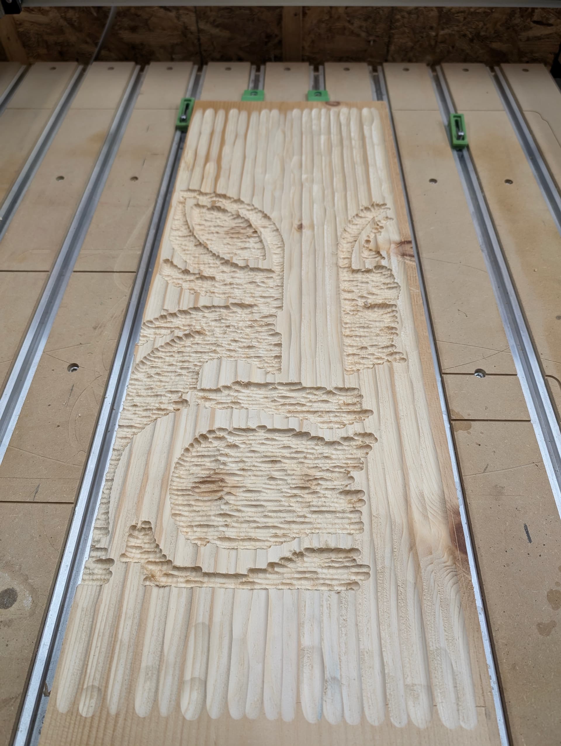

I’ve got a strange issue where my Shapeoko Pro is scaling out a textured tool path at about 130%, but in the x-axis only. This happened yesterday, so I updated both Create and Control, verified the measurements in Create, recalculated the toolpaths on the machine that I run files from (instead of the laptop I design on). I even added a new initial toolpath that traced a simple outline of the pattern around the edges of my stock to verify the machine was working to 1:1 scale (it was). On today’s run, the exact same thing happened - it’s about 30 wider than it is supposed to be, but the height is dead on.
It’s confusing given that the first profile was accurate.
Any ideas?
Post your .c2d file?
Which machine do you have?
