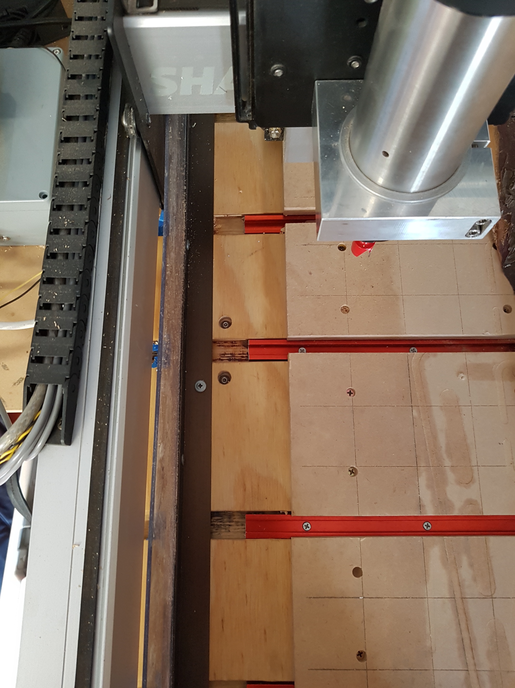

Nice, How did you fasten the MDF to plywood
Just used 6-8 timber screws per length of mdf, and countersunk them so they sit 1/4” below the surface

Great, What did you use or how did you fasten the 1 in ply to cross rails, original fasteners or store bought?
I used store bought stainless bolts, they were part of an assorted pack, approx 1 1/4" long. I just lay the original base board on top of the ply and transferred the hole locations, then Counterbored them so I could mount the MDF strips flush. From memory the base board bolts were too long and hit the table my router sits on, so I had to cut a bit off them.
As you can see I also (hand) routed slots for my t-slot and screwed it in too.
