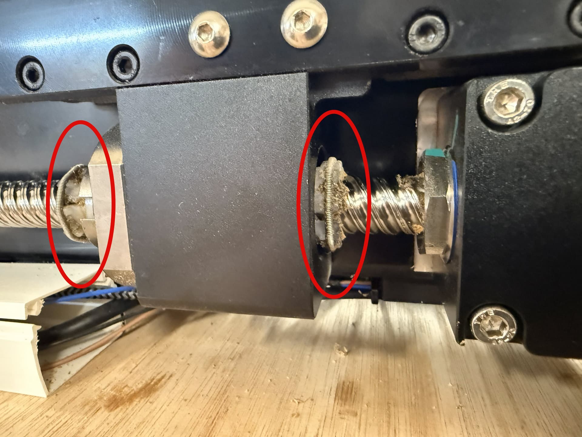

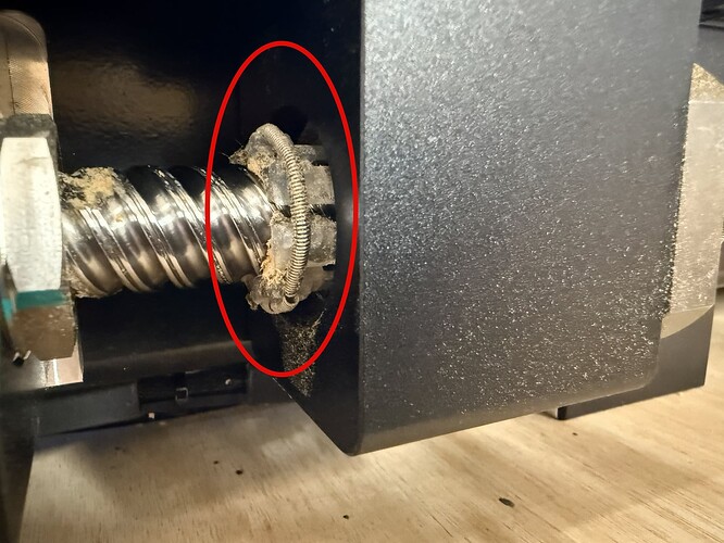

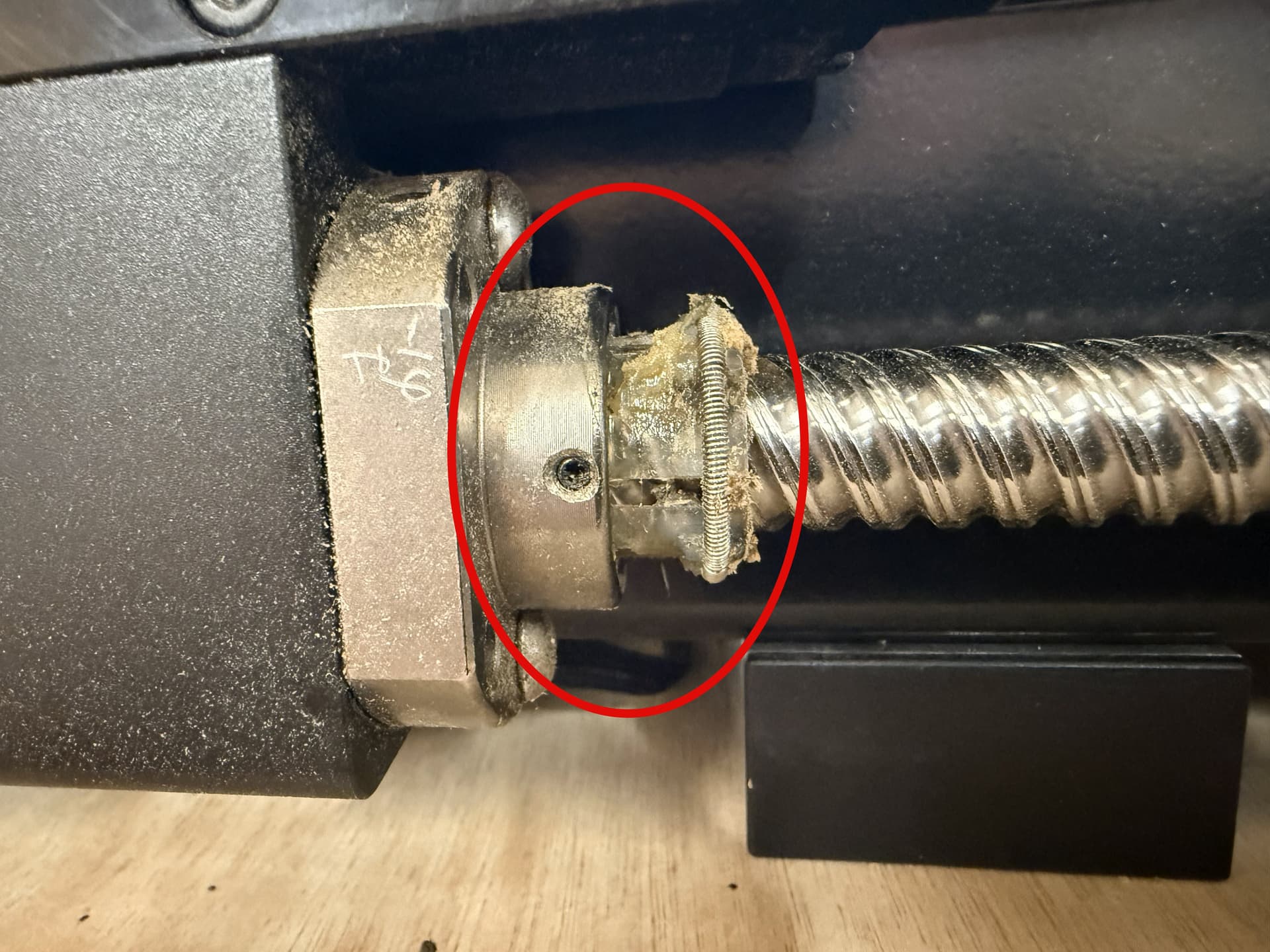

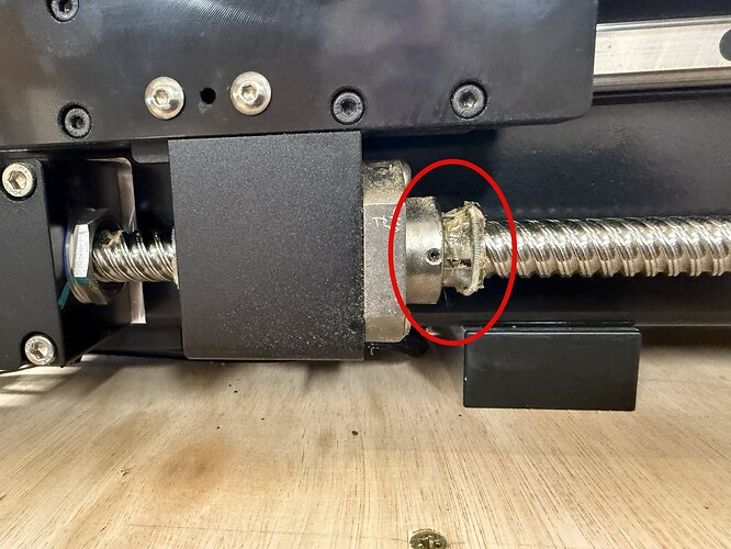

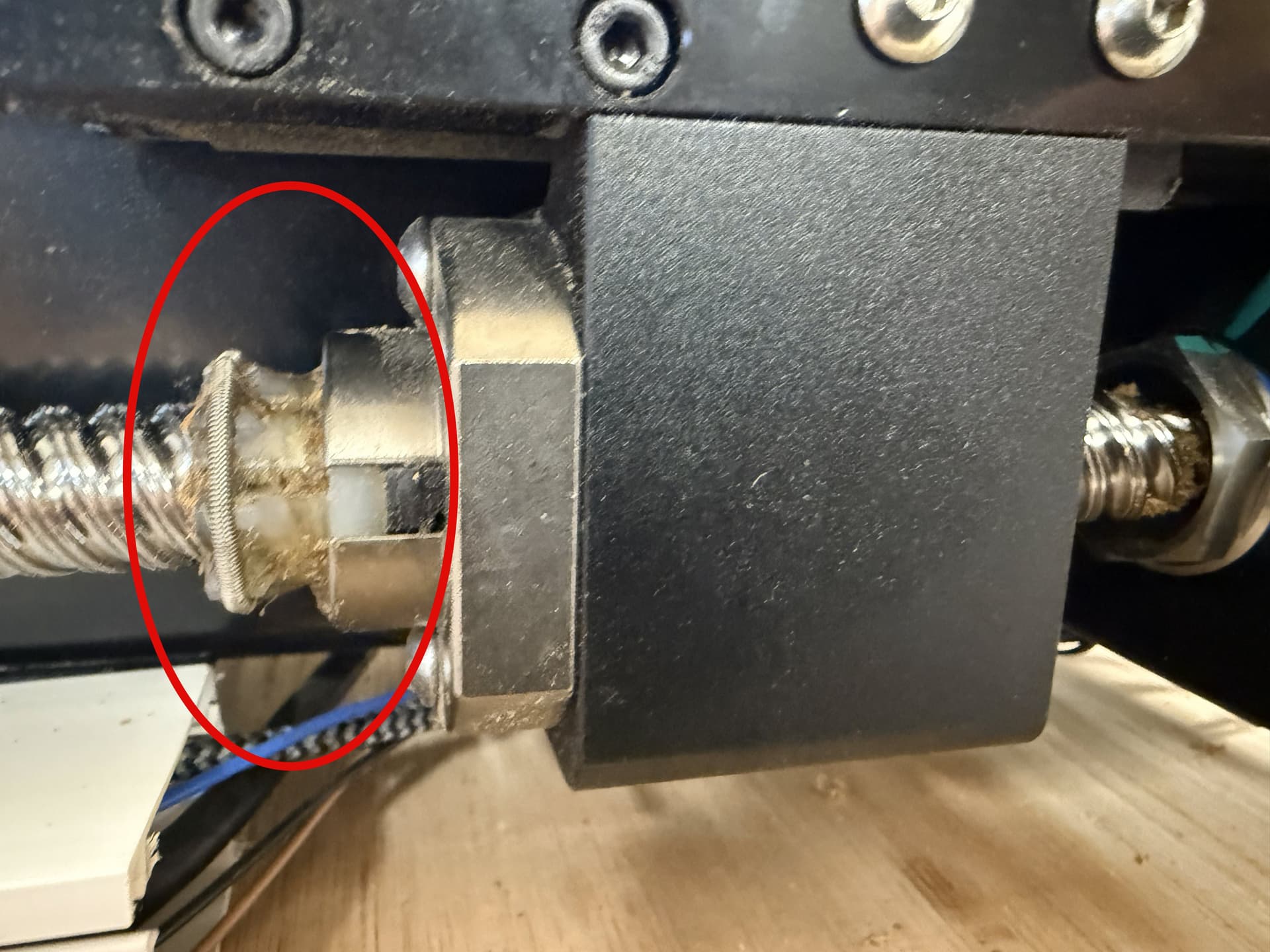

This is my first post here. I’ve had my 5 Pro for about 6 months and have noticed that the it looks like the dust covers for the bearing blocks are moving away from the blocks on both (Y-axis).
Before I start fiddling, has anyone else had this problem and does anyone know how to fix it.
Many thanks in advance, Steve
That’s how they should look. The fingers on the wipers are outside the ballnut to clear any dust and debris before it gets inside.
(But I did ask Luke to confirm that the exact position on your unit is correct)
Looking at this - it all looks as it should, nothing out of the ordinary.
The front looks slightly different as the rear is hidden within the machined carriage.
