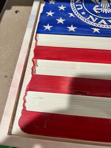

Trying to figure out why my y axis is skipping/binding. Trying to cut a grid and it starts off good and then starts doing small skipping/binding about half way through. I’m cleaning it as it runs. Thoughts?

Still doing it. It was running fine all last night. Then this morning I went to run the stripes on this flag and it started shuttering again. It seems it only does it when doing long y axis cutting passes. Well tried to load a video but no dice. Here’s a final pic.
I went back and dent a detail contour and it didn’t shutter. So you ca see where it didn’t cut.
Repeating Will - are you sure this is not the X-Axis?
The X-Axis is the one that goes from left to right… on your machine it’s the one with the rails, whereas the Y axis is the one with the belts.
People with that particular machine have had stuttering on the X-Axis because the rails needed lubricating with Mobil Vactra #2 oil.
The thing is, it seems to complete the Y-axis movement — it seems to be failing to make the matching X-axis move — if the machine is mechanically sound and properly lubricated and the wiring seems to all be in good condition and all connectors are secure, let us know at support@carbide3d.com
It is the x axis. My apologies. Yes everything you mentioned is good. But still having the issue.
