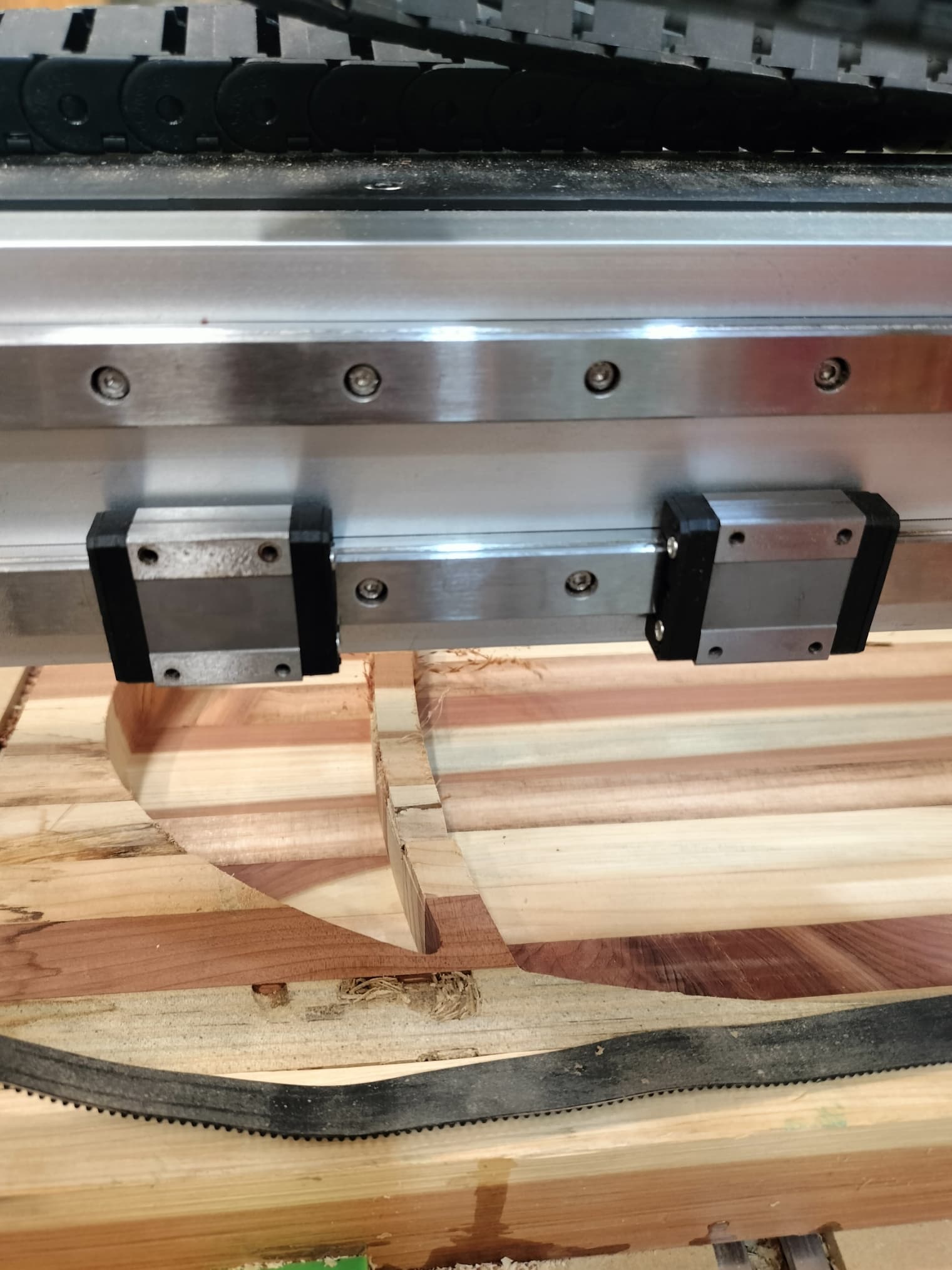

Y axis stuck in middle of cut
I was doing a deeper bowl type cut and it was going along fine then just stopped on the Y. I powered it off and it is still stuck. Cannot manually move the CNC on the Y and dont want to force it? Any ideas. What can I check,
First thing to verify is that the linear rails and blocks are clean and well-lubricated:
https://carbide3d.com/hub/docs/maintenance/
Post a photo showing the current state of things? Check in w/ the folks at support@carbide3d.com?
It is the linear bearing blocks on the bottom that appear to be stuck.
Ideally, you will be able to free them up by cleaning/lubricating.
If in warranty, the folks at support@carbide3d.com should be able to assist.

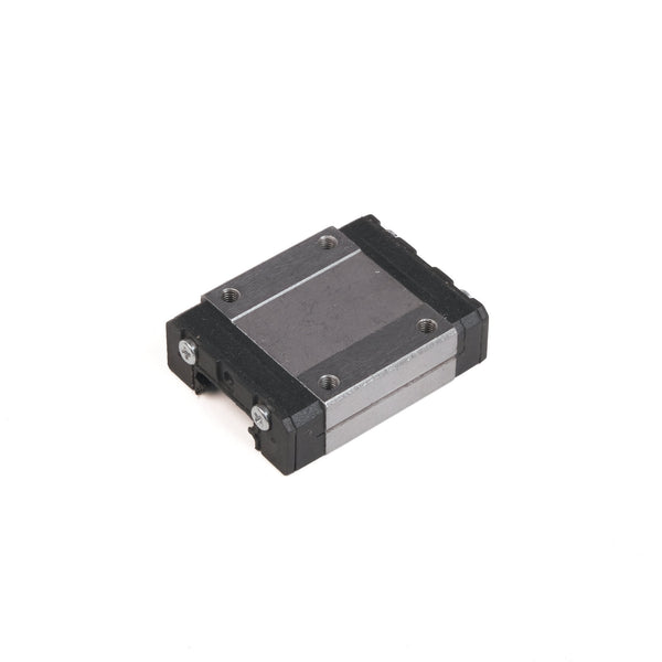

If out of warranty, we have spare parts listed at:
including:
Thanks for the info. I am attempting to lubricate them up and see if they will free up. If they dont how do you get them off? Loosen the screws on them on the ends?
Thanks for the quick responses.
I will defer to the folks at support unless @Luke wants to speak to this.
I was able to get it lubricated and moving. Seems like it is ok now. Thanks for all the assistance.
