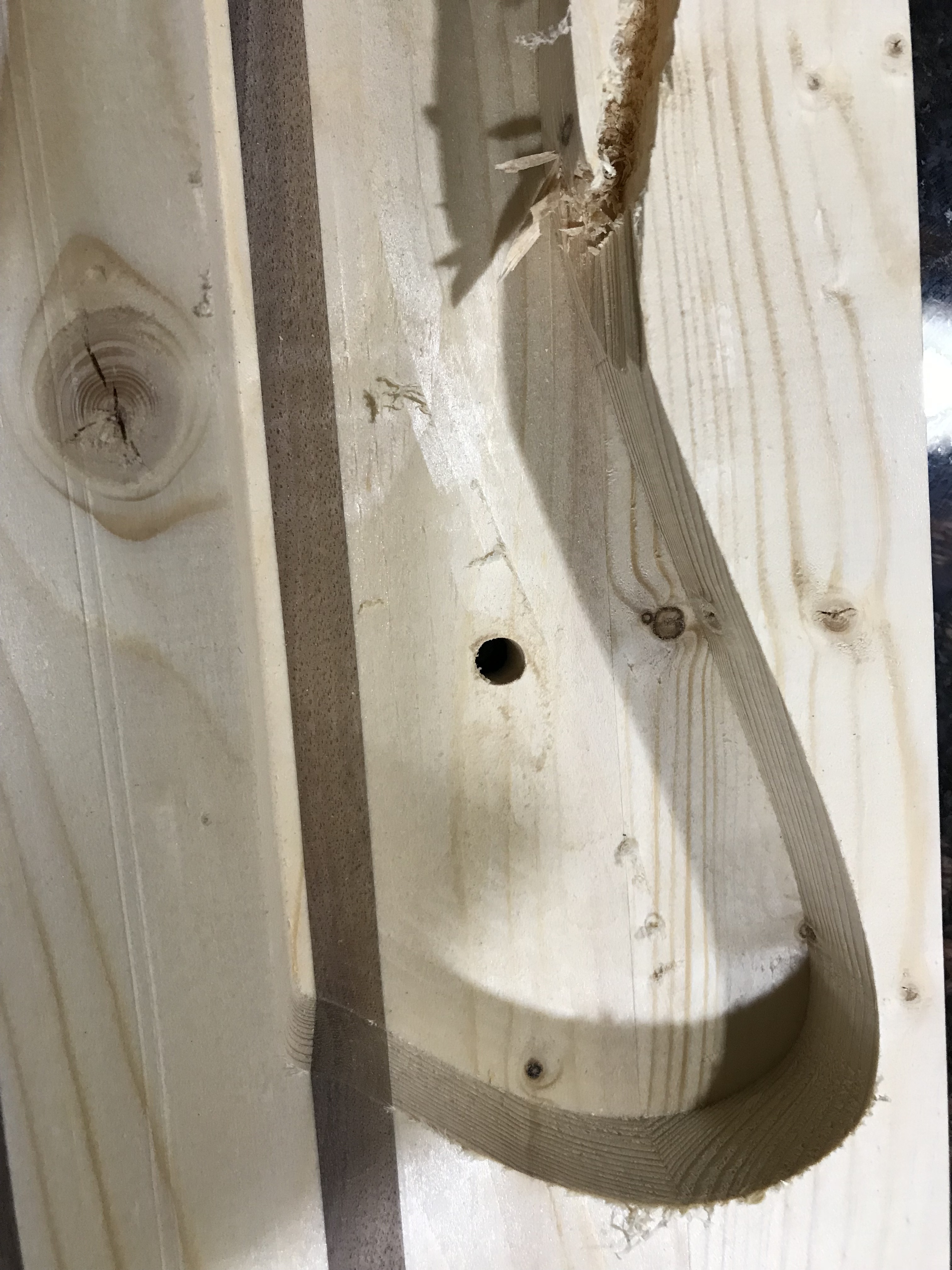

So I was trying to hollow out a guitar body today. As the machine was going to make it’s last pass for the pocket, it tore through the side wall instead of retracting to the normal hight as it did on all the other passes. After that, it drilled straight down through the material and into the wasteboard at the location I would have expected it to start the next pass.
I am assuming it’s something to do with my Z axis but I didn’t hear any belt slipping, and the endmrill is still tight in the machine. any ideas when why it wouldn’t have retracted properly?

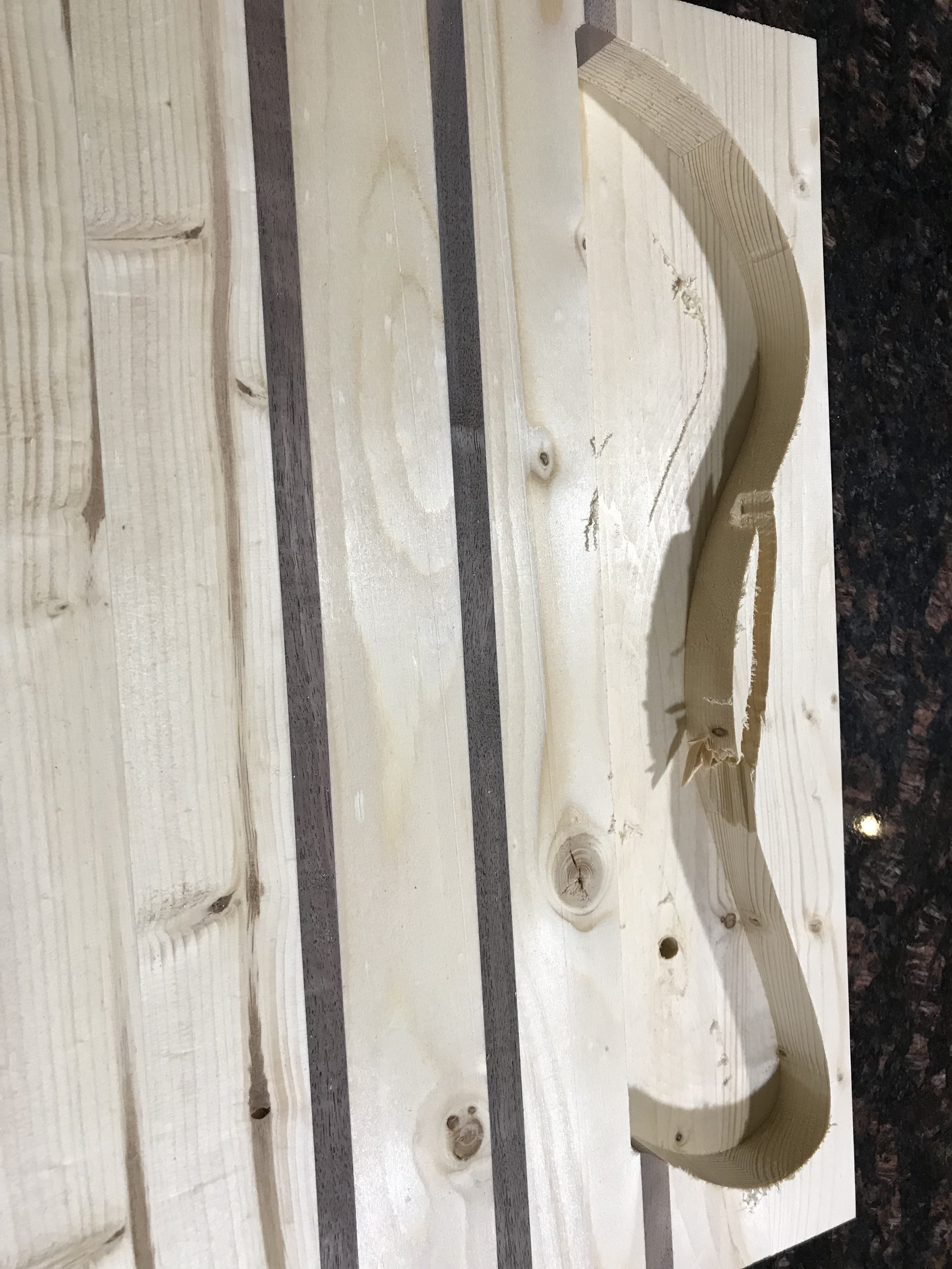

I finally got around to trying the project again. I cleaned the machine up, verified all the v-wheels, set screws and belt tension was set properly. Cleaned out the collet, tightened up the .25 EM and ran the program again using the same gCode. I was pretty sure this was a mechanical issue so didn’t think I needed to recreate the gCode. Wouldn’t you know, same problem, same position / depth. So now my question is, how do I go about looking into the gCode to see where the issue is? I know it occurred around 45 minutes into the project. Is there anything I can do in Carbide Create that may show me the path that is causing this? Picture below for reference. the first attempt is in the front, second attempt still on the machine.

That’s too bad, did you check that your Z is still set properly? Did you run your job in CAMotics to visualize the toolpaths? Is your retract height set properly? Do you know the GCode line where it happened so it can be examined to see if there is something there?
Retract height is set fine, it worked for all the other passes while carving out the pocket. I have not used CAMotics before, I will look into that to see if it shows me anything.
as for the gCode, I didn’t see what line it was at while rushing to stop the job. I only know that it happened about 45 minutes into the project.
Is there a log in carbide motion that would show where it stopped? I had to power down the machine before it bored down through the material again.
The ability to get something in CM that says last line processed was line XXX has been something requested from Carbide but no luck so far. Re: retract height, I was curious if something would have appeared in the GCode to change the retract height mid job.
I was hoping to review the gCode for some sort of explanation as well but I didn’t know the best way to go about it. I think I will have a look at the simulation and see if it shows the path going through the side of the project. at least that way I would know the issue is either in my design, or in the gCode generation.
If you are at all interested in seeing what the paths look like for yourself in CAMotics, I attached the gCode in a previous post above,
Looked at it in CAMotics and there is no damage to material but there is a rapid positioning that seems to be in line with the damage to the material. Maybe increase the safe retract height.

Line 23842 (possibly, depending on depth) is the retract move that fails. It is the last retract move that then goes across that area. No reason in the gcode for it to fail.
You could try changing that line from G0Z5.080 to G1Z5.080F300
That will do the retract slowly instead of at your max feed for the Z.
Since I don’t know the depth at that point, you could try replacing all of your Z retracts, or, easier change your Z maximum rate to something like 300 or 400. Send $112 = 400 through the MDI.
If that doesn’t work, you could try moving the endmill off of the “wall” before you retract.
These are band-aid fixes to get the carve complete.
