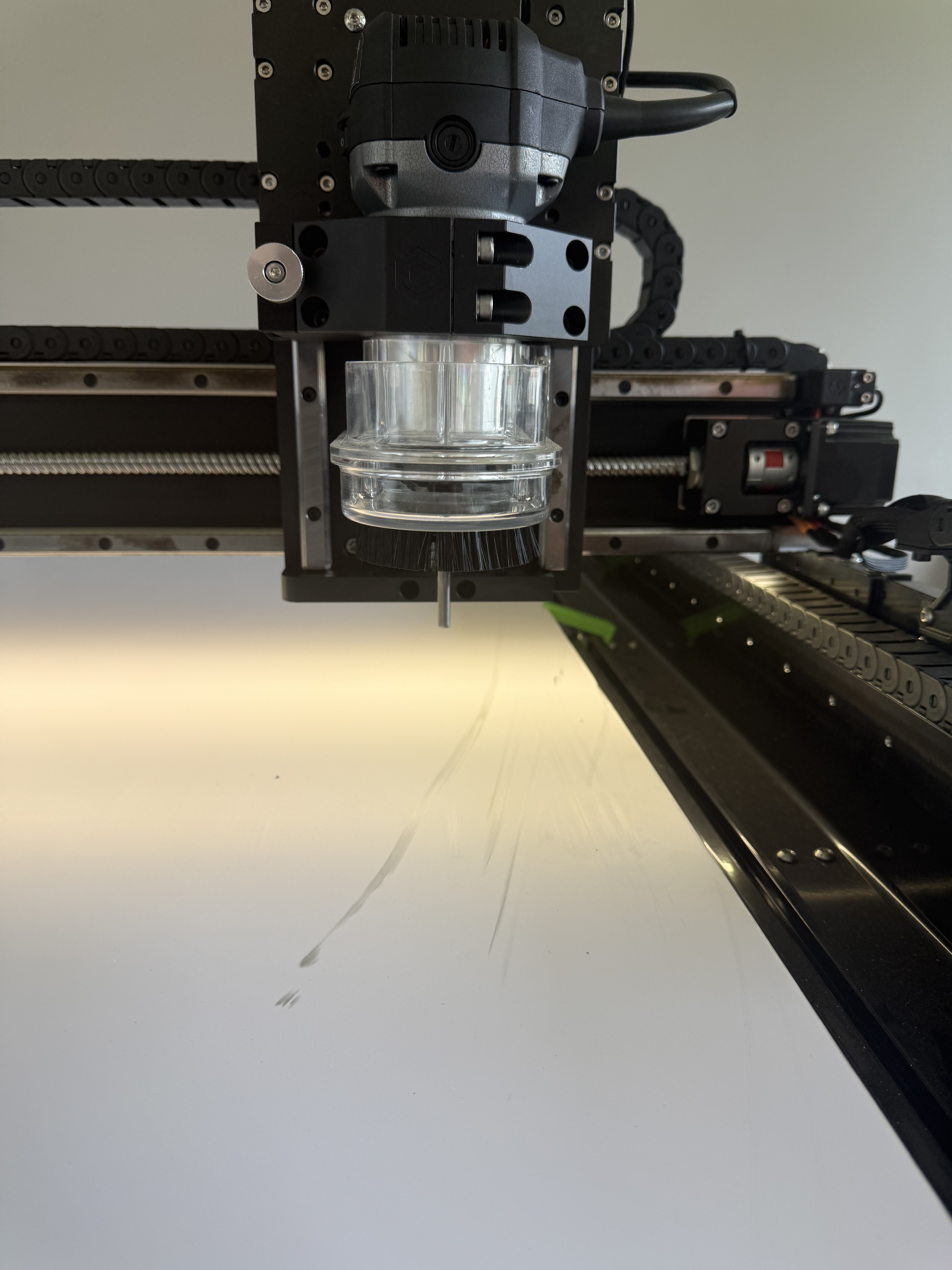

For any reason my z-axis is not going all the way down to the material i am cutting. Once i hit the start button to start the job it does the cutting process in the air, it doesnt go all the way down to the material i am tryin to cut. Also when the x axis goes all the way to the right it starts vibrating when it reaches the end.

This is where it stays doing all the cutting. Way to far from the stock.
My friend i adjusted what you told me but it still doing the same thing :pensive:
