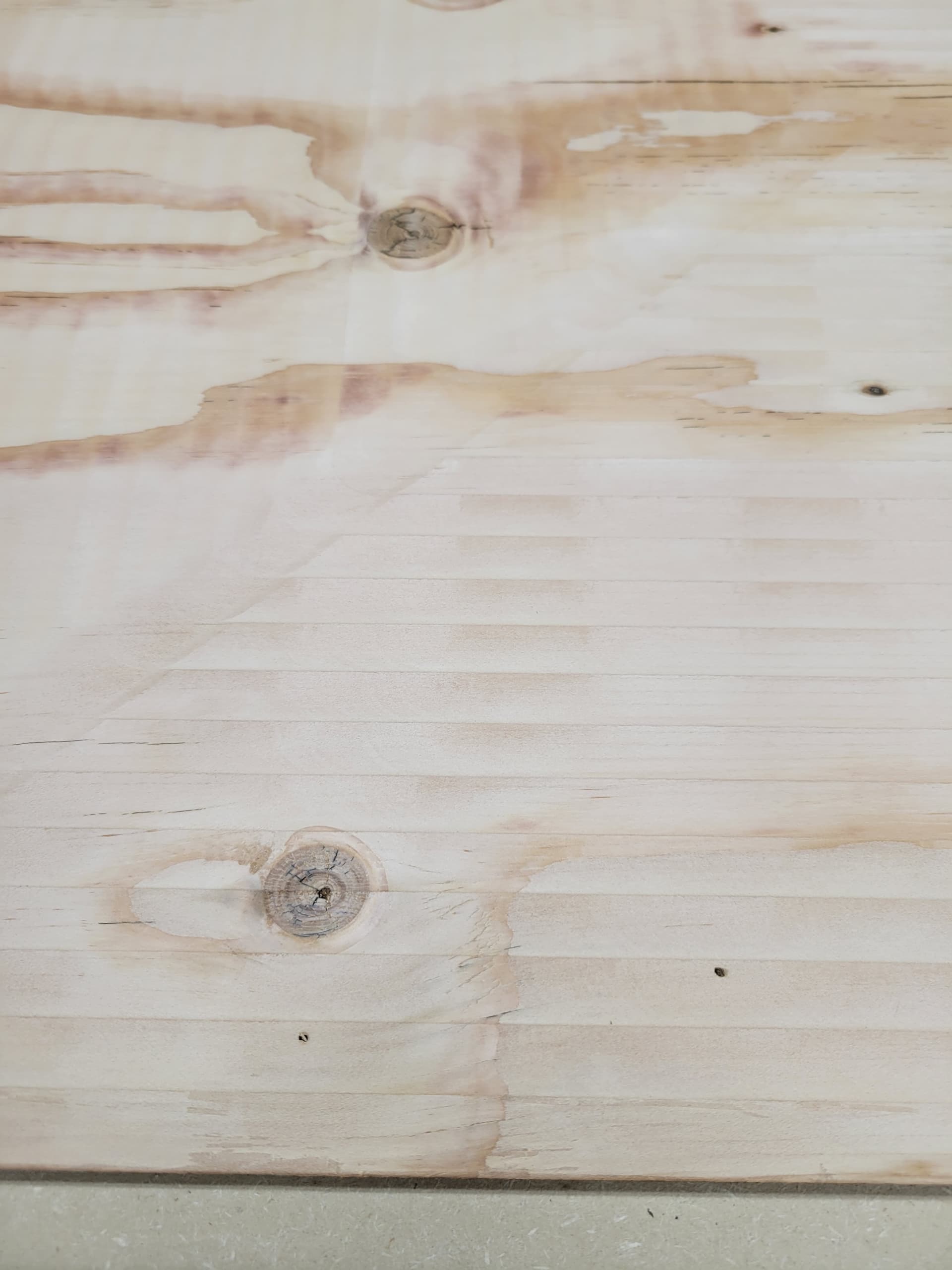

My xxl 3 z axis isnt plumb and shows when i resurface the spoil board. Use the whitside 6210 surfacing bit I have a digital angle measure and it shows it being out almost a half degree all the x and y rails are are perfect which leaves me ro believe the z carriage is off is there a way to adjust the carriage itself? Here is a picture of the spoile board after surfacing as you can see theres little ridges that indicates the issue
Heres a link on how to properly tram your machine.
I used some aluminum foil in certain spots under the router plate to get mine close enough for me.
:person_facepalming::person_facepalming:dang why didnt i think of that in the first place. Thanks .
