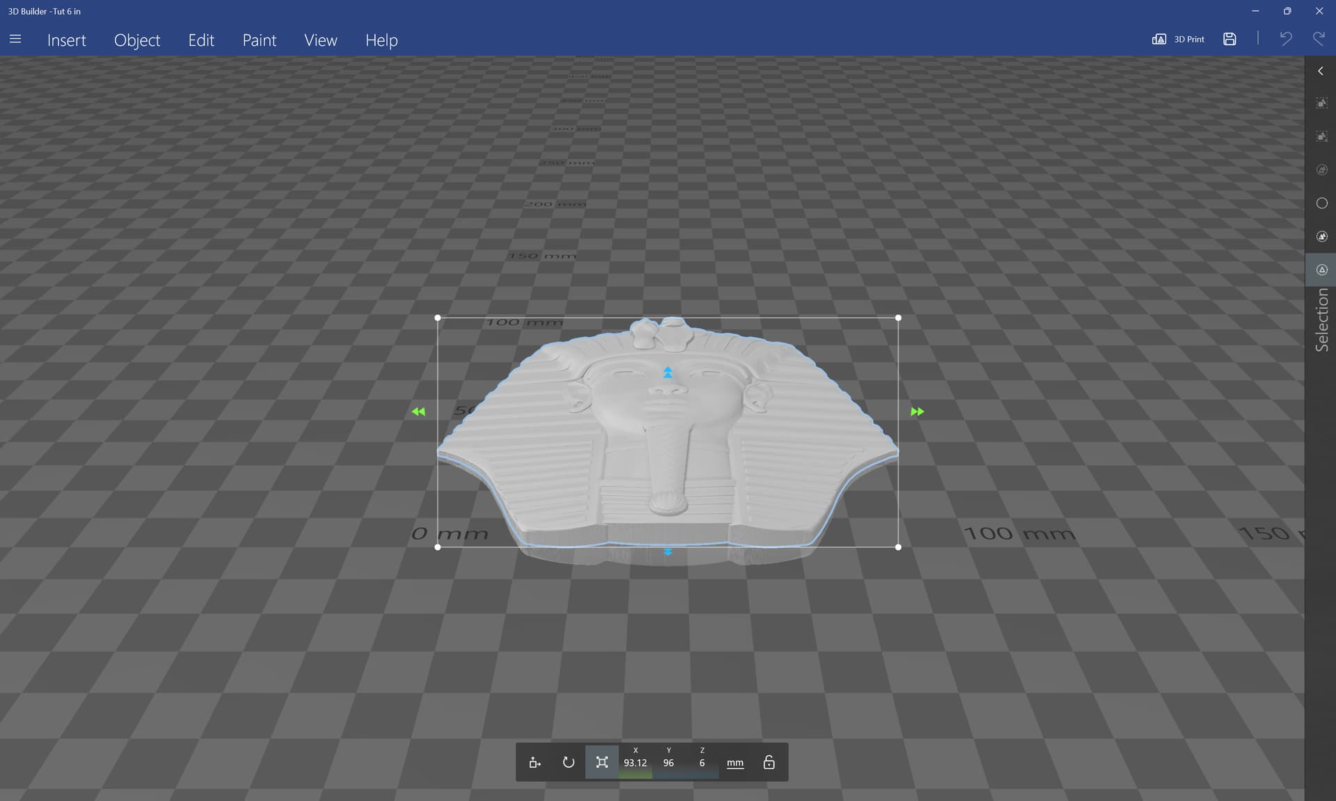

This file is quite small physically:
What dimensions do you want?

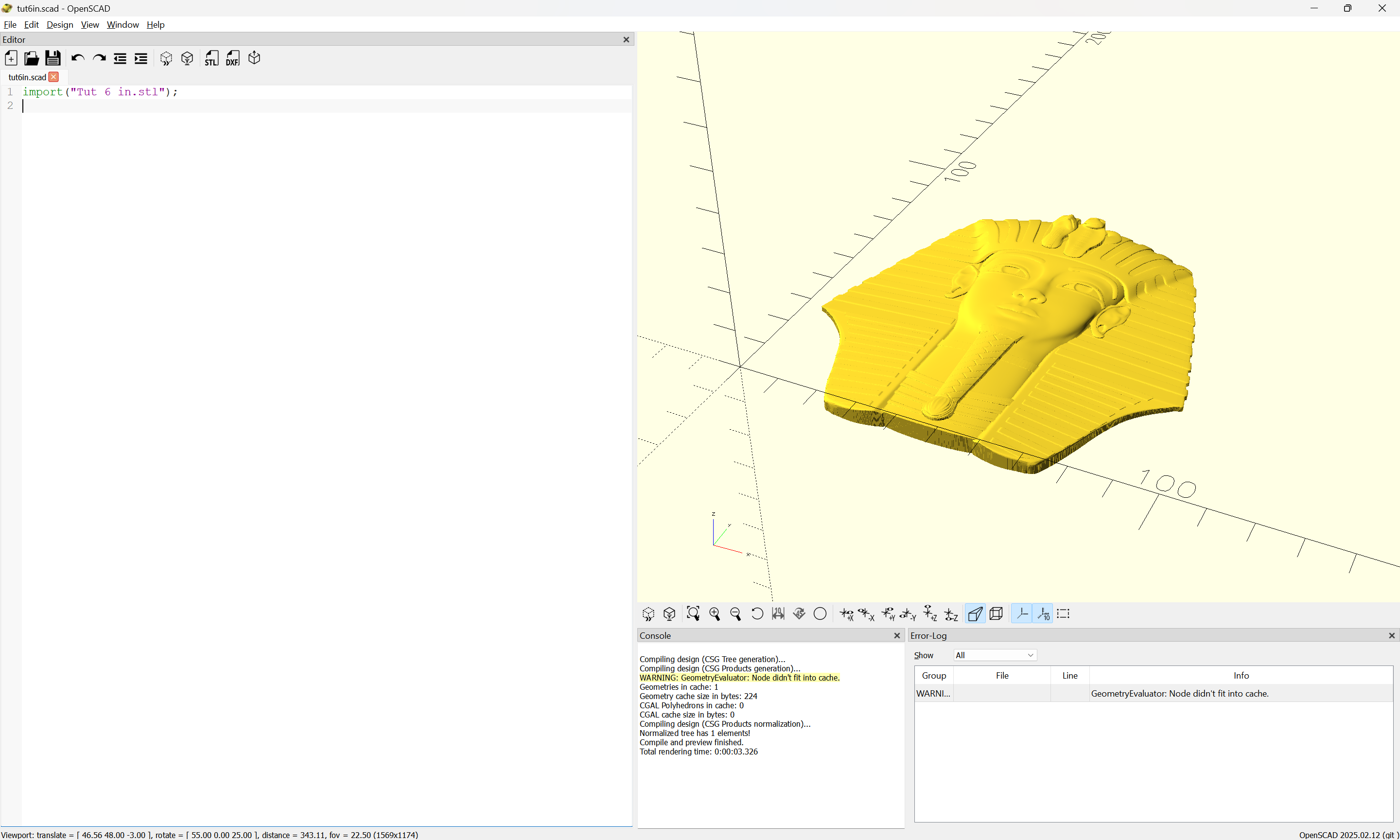

Assuming 1mm == 1in we get…
Using OpenSCAD:
This imports as:
import("Tut 6 in.stl");
Getting each layer is as straight-forward as:
intersection() {
  translate([0, 0, -2]){
    cube([100,100,2]);
then decrement the -2 to get each layer.

Post your code?
You can edit the code to slice in any direction/orientation — it’s just geometry.
