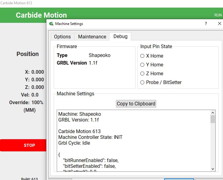

Hi Will thanks for the quick replay.
I upgraded to Carbide Motion 613, I was using 575 before). Now I see the setting input pin state window. I attached a screen shot of it here. I was not sure if these setting were ok. I was not able to click the circles beside the x y z axis options.
The circles aren’t controls, but status indicators. They will light up if the switches are working properly and metal is presented to them.
Let us know about this at support@carbide3d.com and we will work through this with you.

Hi Will. Its all working now! It was the aluminum pipe that was within the Z-Plus axis. It triggers the homing switch. It had loosened over the 3 yrs that I had the machine and was not getting close enough to trigger the switch. I took the Z Plus apart and tightened up the aluminum rod that triggers the Z homing switch. Put it back together and it worked like a charm.
