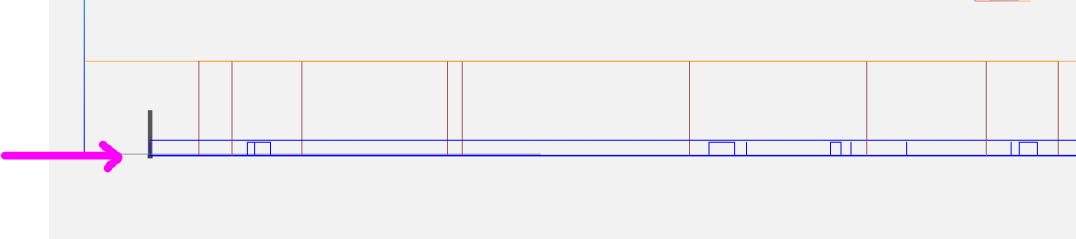

There’s your problem.
The deepest you cut is .015". First cutting pass is at about 3mm above zero, just as you’re seeing.
At least you know the machine is doing what it’s supposed to!
Most of the cutting happens above Z-zero.
Zero indicated by purplely arrow:
I bet you set the zero at the bottom of the stock…not sure why it cuts past that though. Maybe a CC user can chime in.

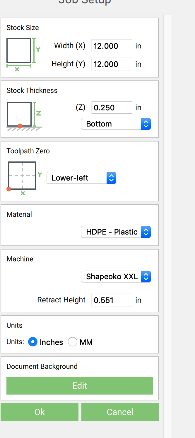

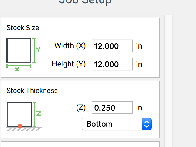

So to be clear, in my screenshot below… i should always be setting my Stock Thickness to TOP of stock? Is that what you mean?
Unless you want to set your Z-zero at the wasteboard, yes.
Wow… thank, you SOOOO much sir. I am not sure how I have been able to cut anything up to this point…I never paid attention to that setting. THANK YOU THANK YOU!

@chiprender On through cuts in something like what you’re cutting (PVC), I set my zero based on the wasteboard so it doesn’t gouge the board for no reason. You can finish that off with a knife if it leaves a little skin.
